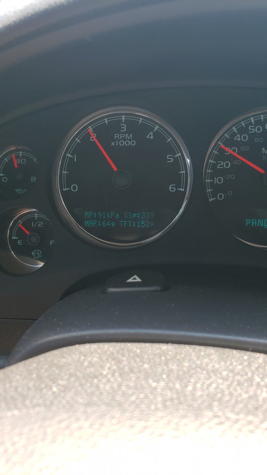

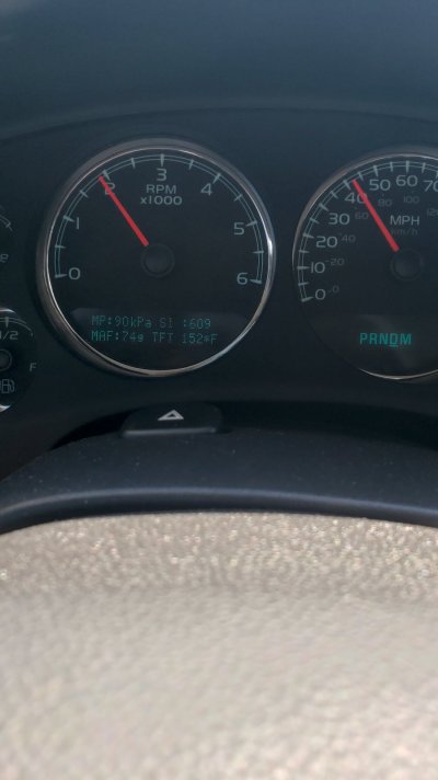

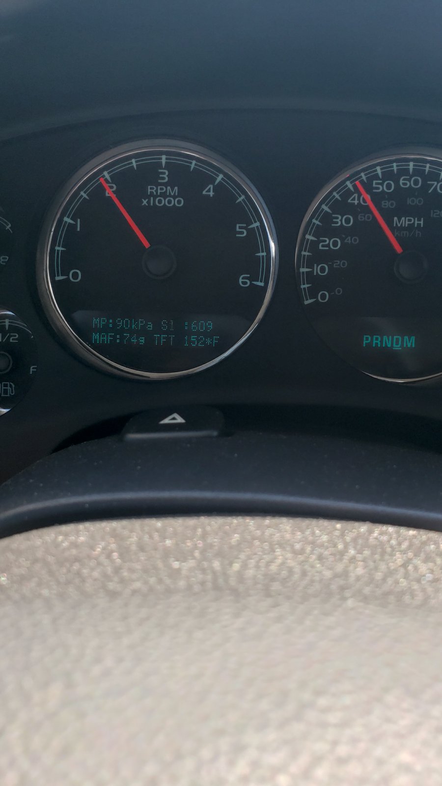

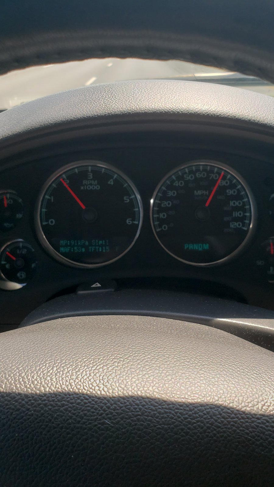

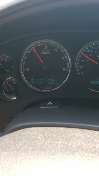

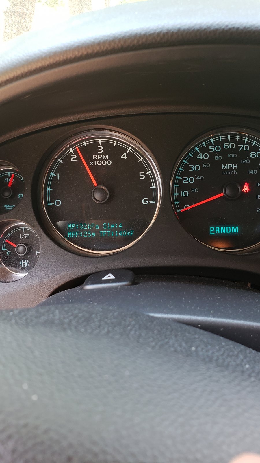

on my silverado it reads 2.12lb/s at 2000rpm, on the yukon it reads 2.45lb/s at 2000rpm
Don't know the conversions, but here's a few pics of mine "close" to 2000rpm at a couple different speeds.
MAF reading is bottom left on DIC

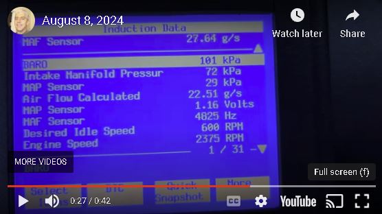

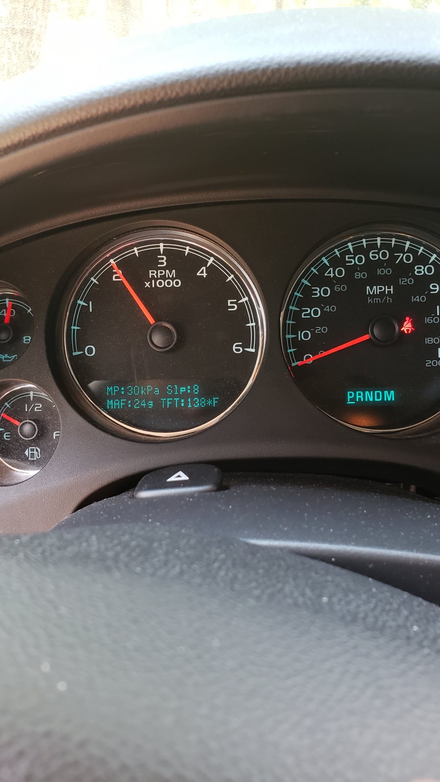

when i revved mine to 2300k and had the tech2 connected it only showed 27grams, way less than yours, barometric reads correct, map sensor reads correct
but that was not under a load
is intake manifold pressure difference than map sensor? cause they have different readings. I thought there was just one map and a baro
I dont know off hand I just see they are reading what they should based on my sea level, I "think" baro is calculated by the map sensor could be wrong

with the key on the reading to the ecu without actual vacuum is barometric and that determines air/fuel mixture, that is calculated by the map sensor
used to be like that, as some point they added a stand alone baro sensor in the air box. probably still blend data, but I'm pretty sure I have a baro sensor in the air box itself

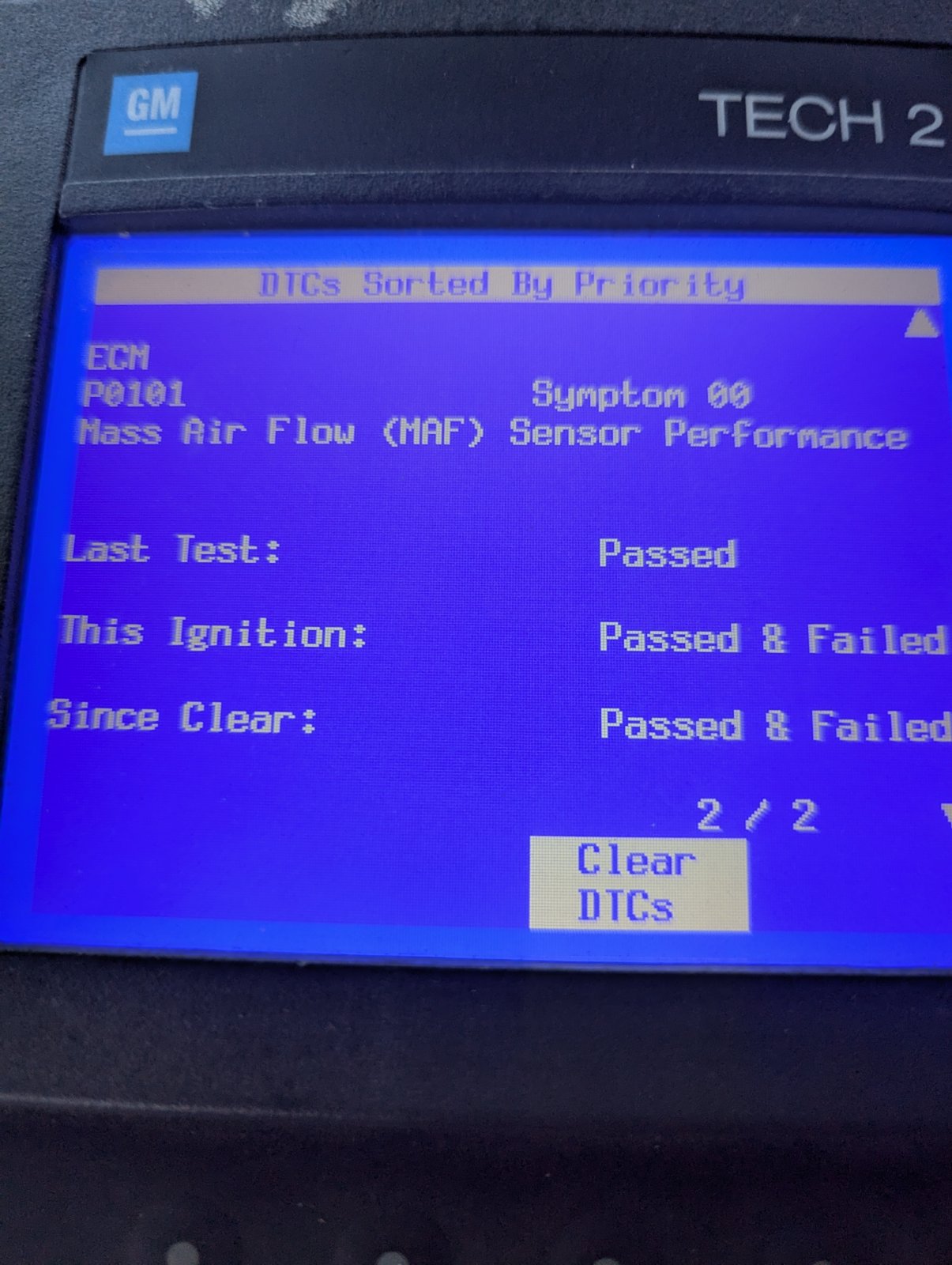

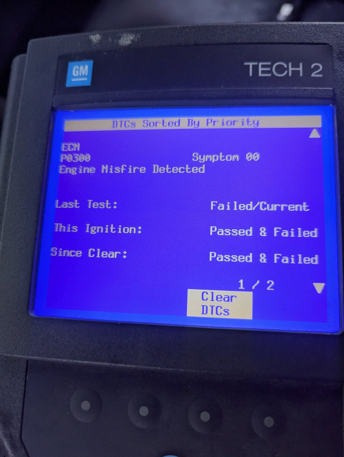

Bizzaro sh*t, new maf installed, fuel pressure is high, misfires under a load only, even revving to 5500 in neutral no misfires at all
