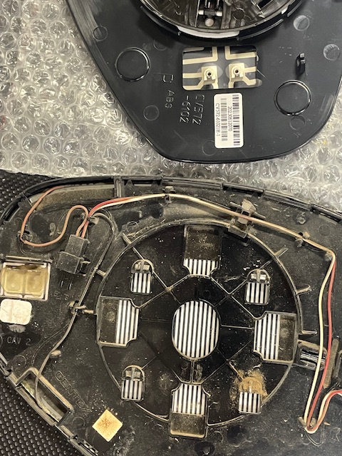

Installed convex right mirror glass.
Using 2 plastic prybars to remove old glass just bent both 90 degrees.
Reaching in from outside edge with 2-3 fingertips pulling behind actuator ring worked great.
Old mirror went flying and hit the ground. (Hold mirror with other hand)
New KoolVue mirrors have a thicker/sparser heating element.
They also have a different ring built in so you do not need original actuator rings.
I wish they had convex glass for the driver side too...

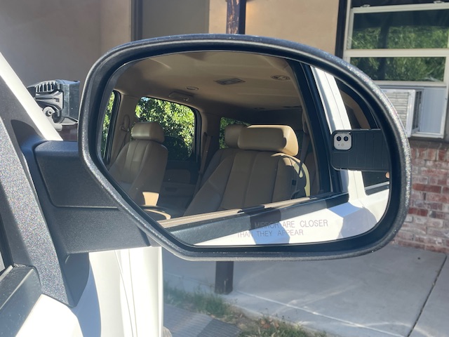

Did you swap out your mirror because the old one was bad?
After driving Class A equipment, I do not like convex mirrors at all on any vehicle.
I use my mirrors for backing up, often, so I do like the distorted view a convex mirror gives for that scenario.
Convex are handy for lane changes but I prefer a bubble mirror for that use with a regular, flat view mirror as the main mirror.
Maybe I'm just weird or maybe it's just a truck driving thing because I know lots of people like yourself that love the convex mirrors.

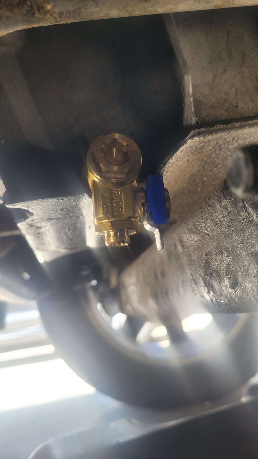

Just got done changing the oil and installing a Fumoto valve.
Oil changes will be much easier from here on out.
I bought some factory mirrors that came with flat glass. I like to see down side of vehicle (backing up) and blind spot at the same time. Was getting used to it, but still didnt like. I considered tow mirrors also. Also considered a stick on button mirror but figured its small.

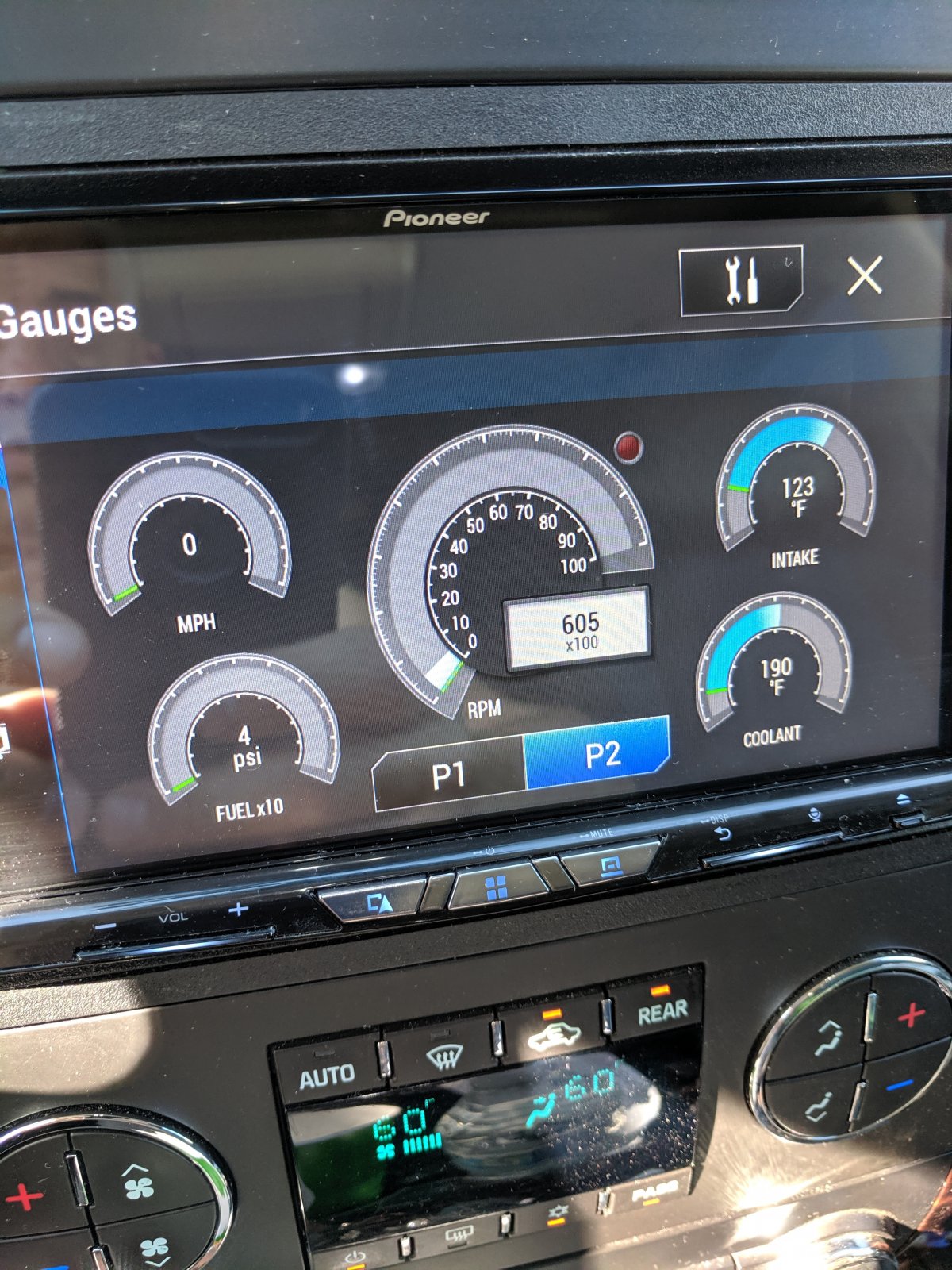

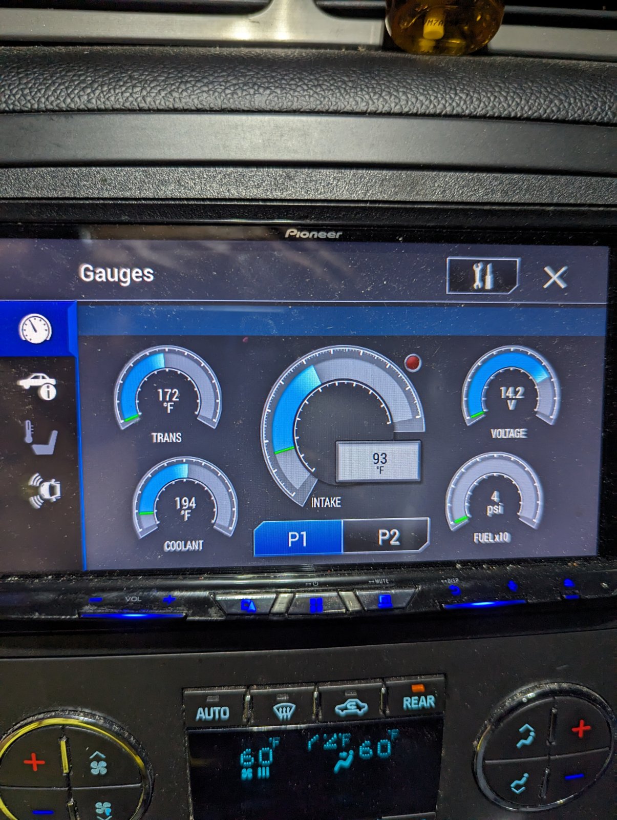

so you guys trucks don't run 210 all the time?
I sware I'm going to try a 180 stat in this thing if I can find a good quality one.
motorad just feels like cheap crap. I built a 170 for the smaller size 2008 and down out of a mahl Nissan 240 stat and and some parts from the oem. but these are bigger and 170 I've seen run as low as 186 on a cold nigh on the interstate, but that's fine for the car. I don't want to go that low in the truck. 195 would seem to be a good temp, I think 180ish stat would get there.
its so annoying gm put the thermostat on the inlet side of engine. ugh. I miss the days of buying a 195 stat and it runs 195 instead of this guessing game.

mine runs about 194 pretty much 24/7 unless I am busting it's ballz up a big mountain in the heat of summer

huh.. looking thru logs mine seems to cycle slowly between 208 and 216 once warmed up around town and that's running the ac so fan settings are basically max the whole time. that's with a new gm stat.
187 is factory. I should find a 178-180. see if it drops about 10deg. it's a 100 outside Temps on the dash already here.

how old is your radiator?, does the temp creep up if you are sitting at a red light?
I have found that this will happen when the radiator get older they just stop working as well as they should.
j91z28d1
Feb 28, 2022
4,612
5,864
I believe it is the original radiator. it definitely could be, but it feels controlled, like the cycle of a stat.
hard to say stopped at red-lights since it's almost always in auto stop where electric pumps kick in and circulate the water to avoid heat soak.
I could probably test it by forcing it to idle next time I'm out and about long enough for all the Temps to stabilize.
