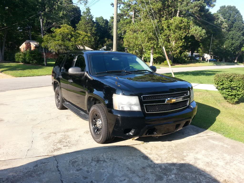

I haven't had a chance to do anything but, drive it home today :)
Not the greatest shots but, you get the idea. I'm very happy.
I'm kind of a dork for thinking about thing about this but man, I have had my Tahoe for over 10 years. Holy smokes.
It looked so good back then haha. I need to get some updated pics.

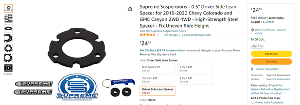

Now that you've mentioned it, I can see it now. From all those miles and years of driving possibly the springs on the ds are more tired then the ps.
On my Suburban the DS spring is stronger than the PS spring to compensate. Sort of. If you don't have any friends who can ride on the PS side for you, you could install one of these on the DS.

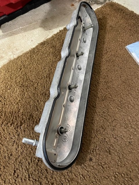

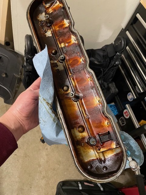

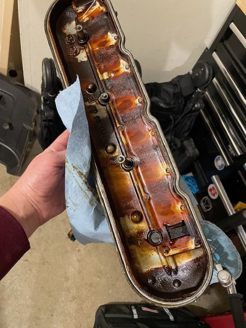

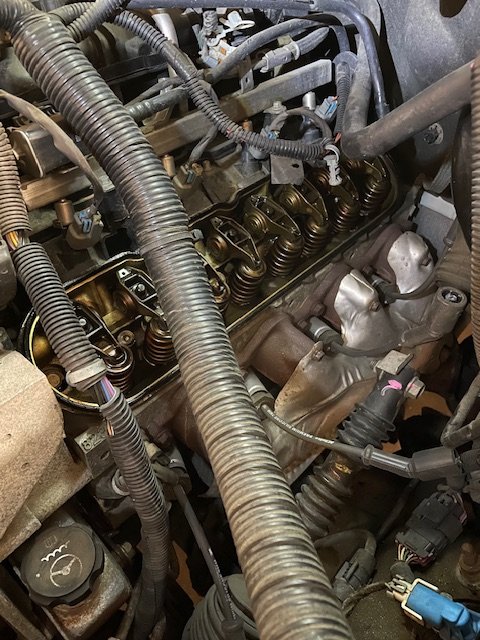

Replaced the valve cover gasket on driver's side this weekend. Easy job. Nasty smelling burnt oil on the inside of valve cover. I ripped 1 of my new cover bolt grommet however by seating the grommet in the valve cover first then trying to push the bolt through, so have to order a new set (only 8 in the package, Mahle brand ones) in order to do the passenger side. I had better success by putting the grommet on the bolt first and then pushing the entire assembly through into the valve cover. Ribbed-side of the new GM OEM gasket goes into the valve cover groove. Also be weary of all the brittle plastic wire loom so that it doesn't fall into your valvetrain while removing and re-installing the valve cover : )
Valve cover bolts torque to 106-inch lbs.
Nasty looking
Soapy water helps with the grommets. I need to this when it gets warmer out. They're not leaking but 103k miles probably will soon

@iamdub posted what looks like a good way to install the grommets in this post:
Runfor5
Jan 29, 2022
97
264
Northern VA
That's good! Nice write-up. I watched this video a couple times too beforehand, literally same exact steps on the 6.2:
