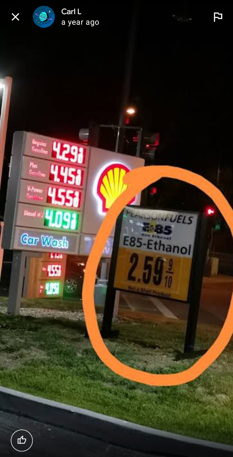

I'd like to know your findings! I wish I could find ethanol in the 70s here. At what brand of fuel are you getting your 70-80%?
We used to only have Pearson and propel here, but for a while now, 76 has there own(they used to carry one of the other brands) and that's the most abundant here so that's mostly what I use.

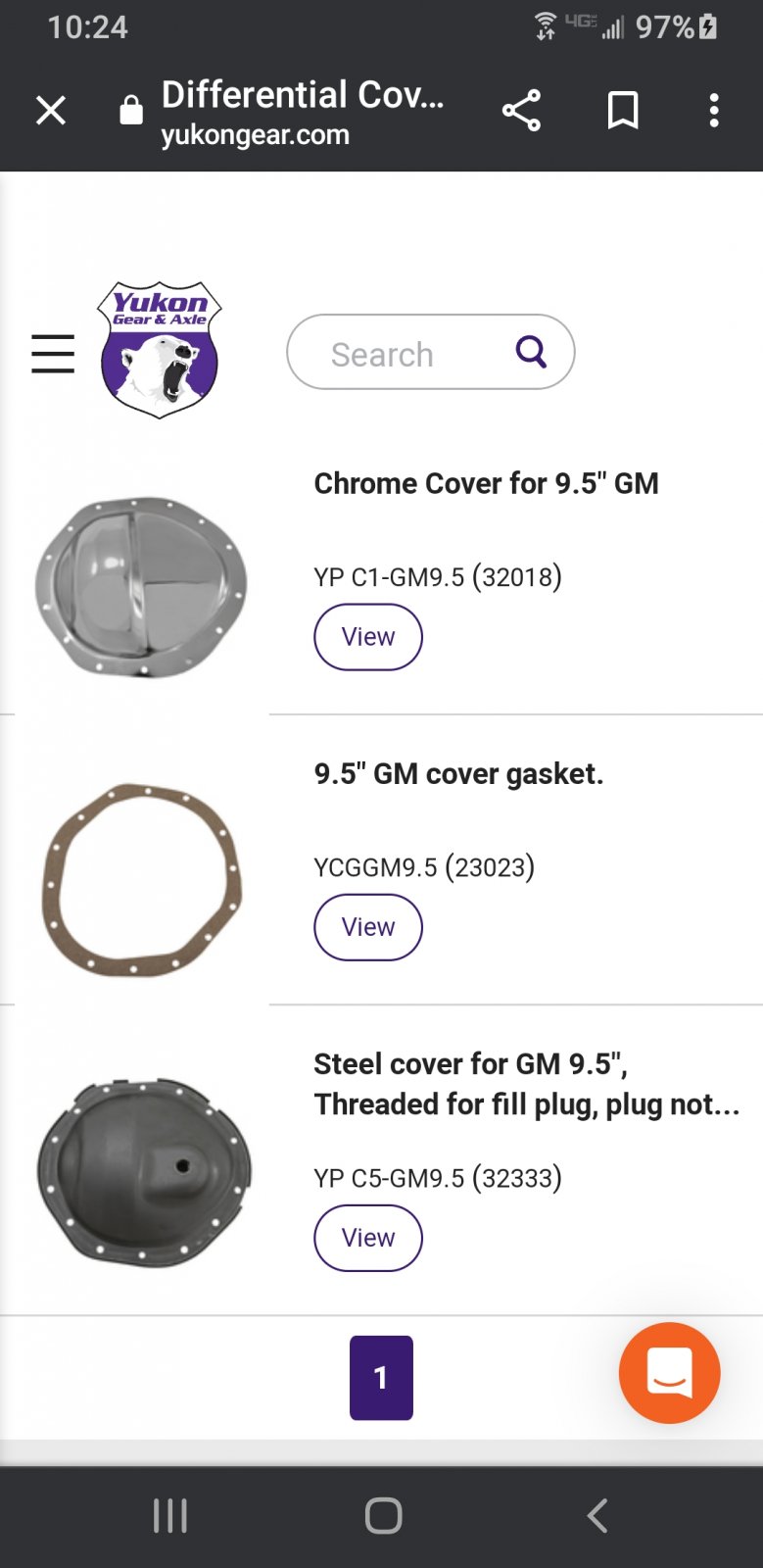

Does Yukon Gear make one for that model?
EDIT: They only make a steel or chromed steel cover for the 9.5", not a fancy nodular iron one with drain plug.

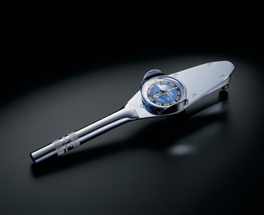

If the pinion appears good as Wes mentioned, then changing the seal is not too big a deal. First thing after pulling the driveshaft is to scribe a line on the pinion and pinion nut so you know where to torque it back to. You're supposed to use a new nut.
Before you remove the nut with an impact gun, use a beam torque wrench or one like below to measure the rotational force in inch/pounds.
When you torque down the nut after installing the new seal and line up the scribe marks, you want to use the torque wrench again and make sure the number is 3-5 inch/pounds more or else you'll have to take it apart.
View attachment 395343View attachment 395344View attachment 395345

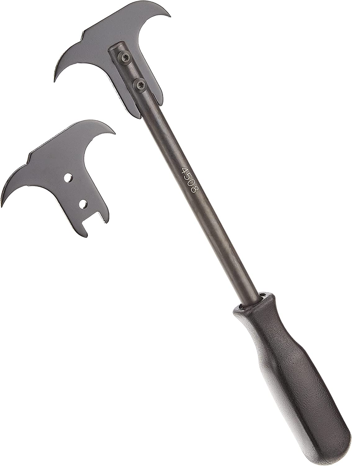

I appreciate the help, looks like I'm not prepared to tackle this job just yet. I do have a seal puller but I'll run out to the auto parts store to see if they have an install tool and torque wrench to rent as well as buy a new nut. I had no idea it was a one time use type deal. I certainly don't want to have to do this again if so, it's going to my mechanic.
That explains it. Out of those, I've only heard of 76 and there aren't any within hundreds of miles of me with E85. We have their sister stations, Conoco and Phillips 66, but no E85. I get my "E65" from RaceTrac.

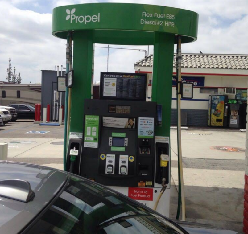

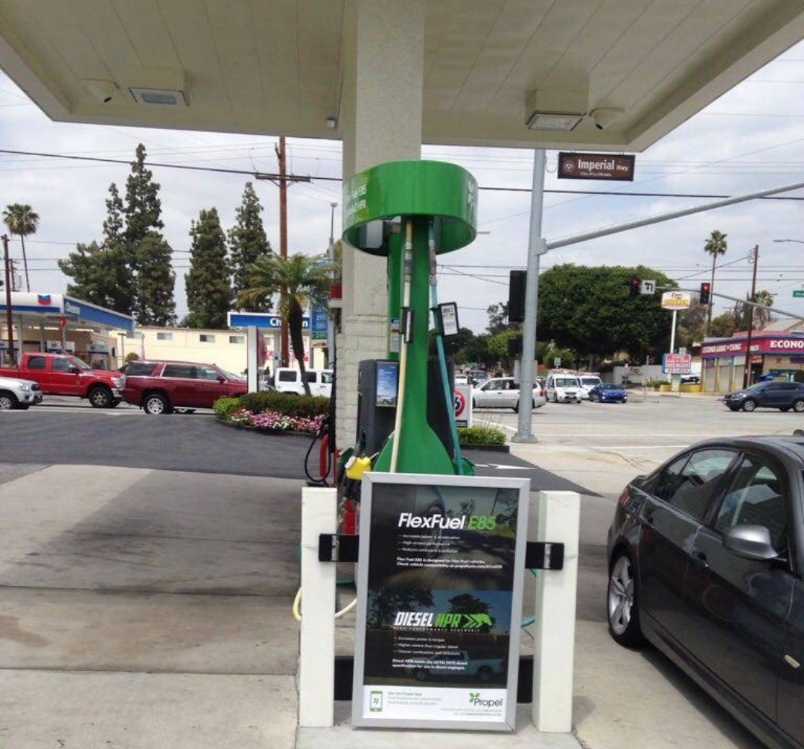

Yeah, so Pearson and propel don't have their own stations here, they use other stations to sell their product.
So before 76 had their own, any 76 used to carry one of those two brands at their pumps and it would say everywhere that it wasn't a 76 product, shell and Arco are some of the other stations around me that still carry their products at the pump. Propel also does biodiesel I believe.
Here's the 76 station that had propel pumps at I used to use with my Subaru.

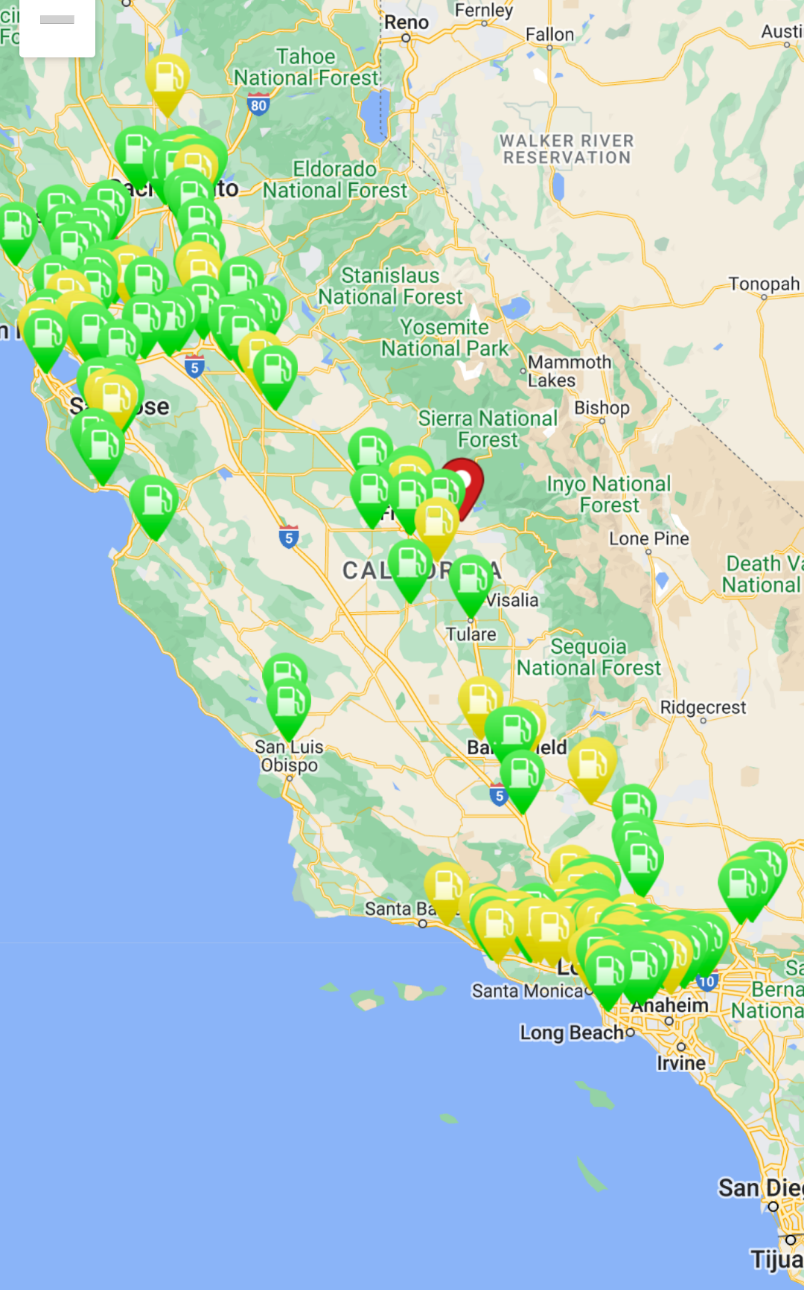

Just checked propel's website and they only have fuel in California. A little bit Northern mostly in LA and a couple in San Diego is pretty much it though.
Looks like shell and Chevron are the ones carrying Pearson for the most part, Pearson has a ton of stations these days I looks like.
