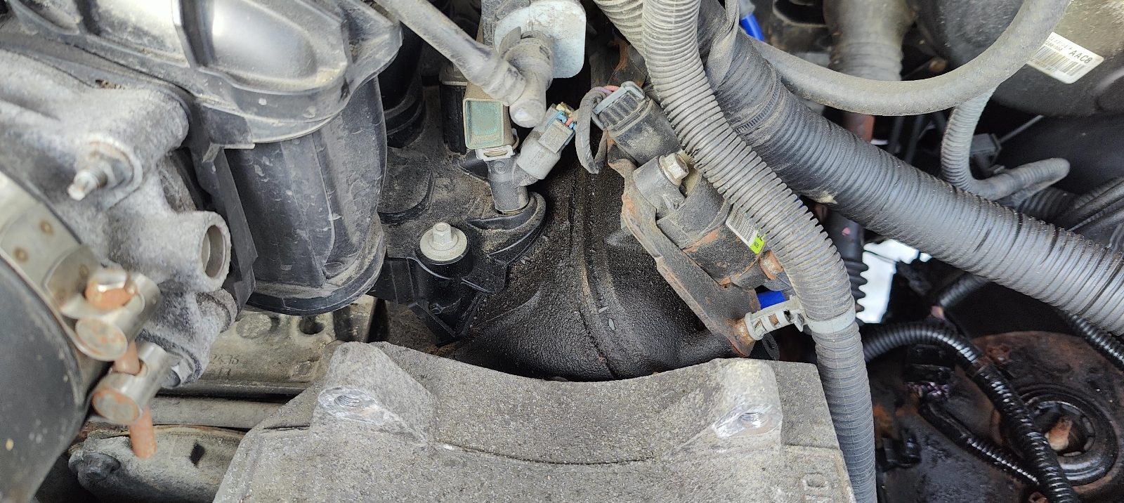

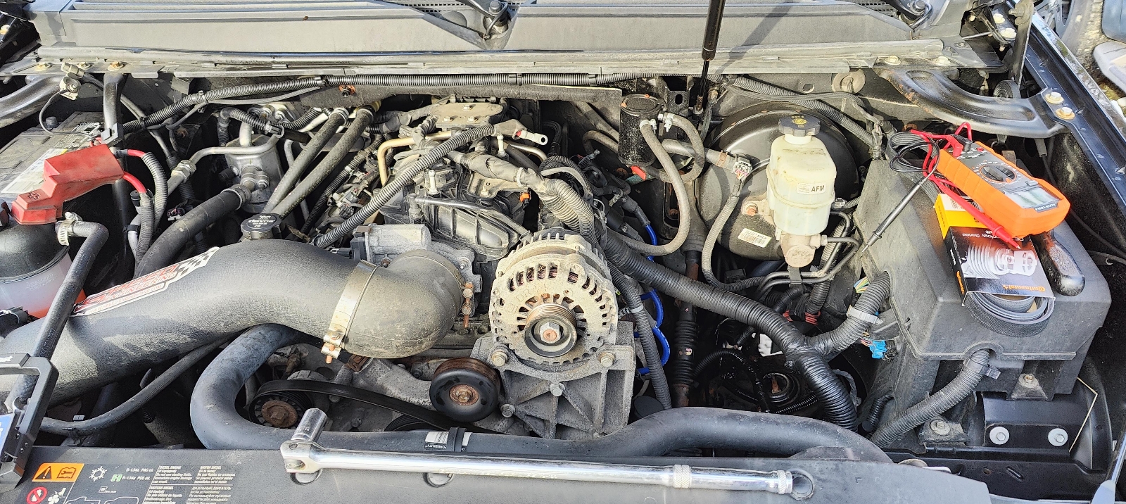

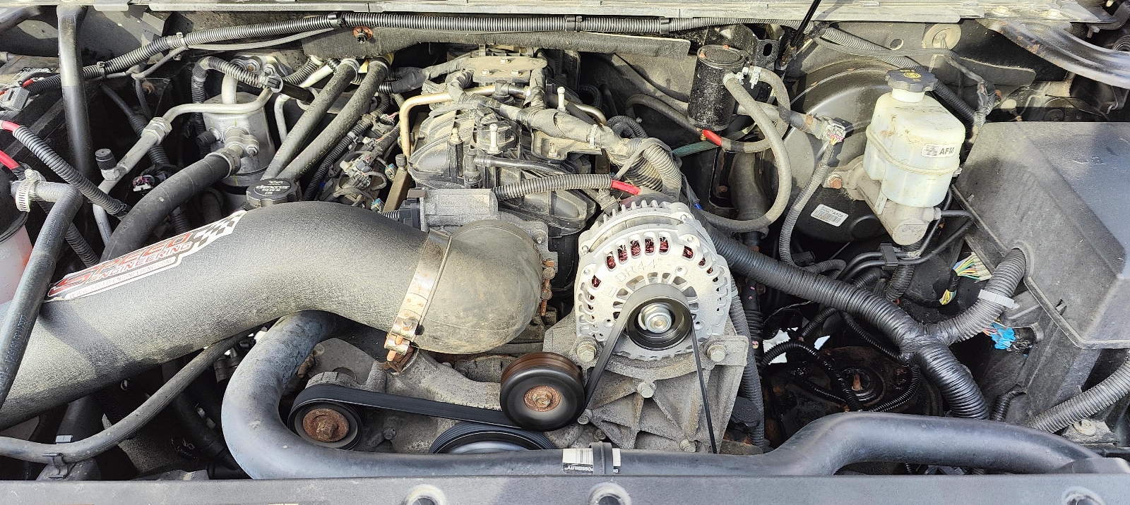

Dropped in a new 160A alternator and serpentine belt. Old squeaks & squeals are gone .
Old
Uck..
New
I also spent 30 mins with the engine running trying to find the coolant leak. You can see the wet spot in the top left, along the hood seal.
The front of the engine is dry, nothing around the water pump or any hoses that I could see/feel, and the heater core hoses & plastic connectors are bone dry.
The hunt continues ...

IF you are losing coolant in that area, it's for sure the heater hose Tee's...
Get the GM ones, not dorman or other brand.. Kind of a PIA to change, but you'll be
stranded and overheat your engine once they "go"
Old
Uck..
New
Dang bro you got leaks everywhere. Valve cover gasket? Brake master cylinder? What the hell is all that fluid all over the driver's side strut tower??

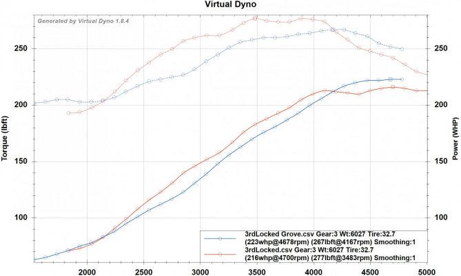

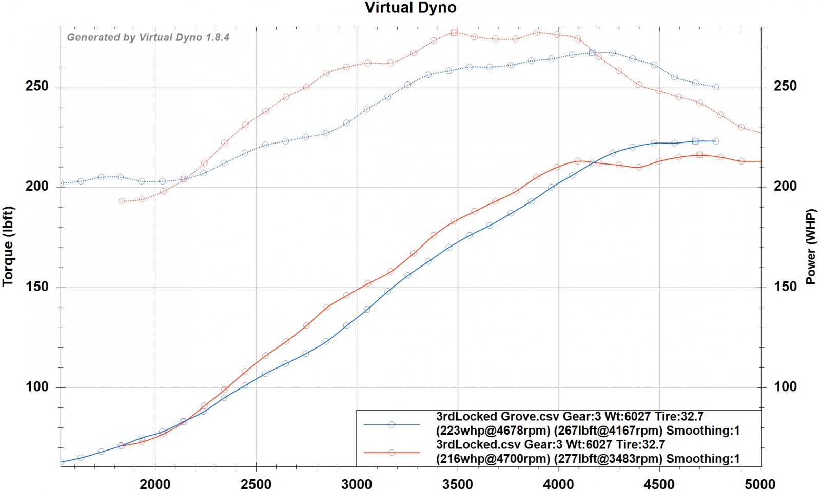

Finally put the "Trans Dyno Tune" on.
Now locking the converter and locking in a gear works perfect.
Had to test it of course. Cut the runs short due to traffic(wasn't an issue before since I always used 2nd).
BLUE line was an on ramp with an incline.
Seems like those numbers probably aren't too far off though.
It's not the tees. Everything up there at the actual connections is dry. It's looking like when the fans turn on they are spraying the leak up that way.
All hoses are dry at their connetions. Next step is to rip apart the front end, and check the radiator I just replaced.
