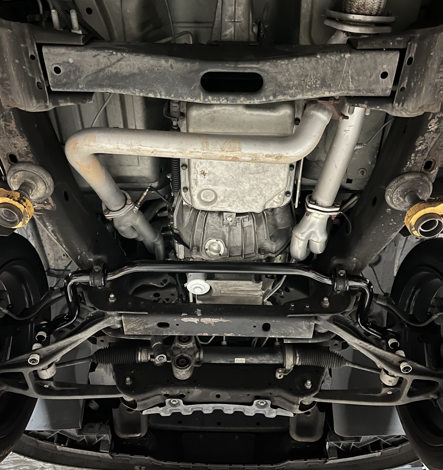

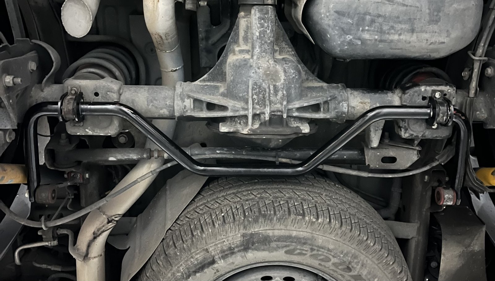

Installed the Nolathane sway bars but couldn't quite finish. They thiccc. Need longer bolts for the rear then set it down to tighten all the end links.

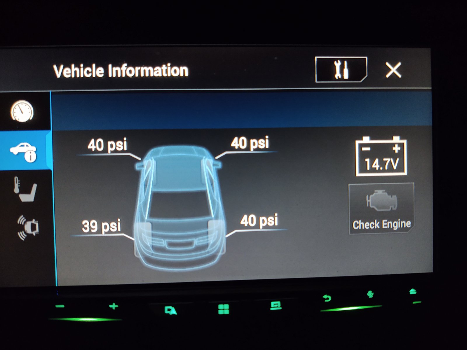

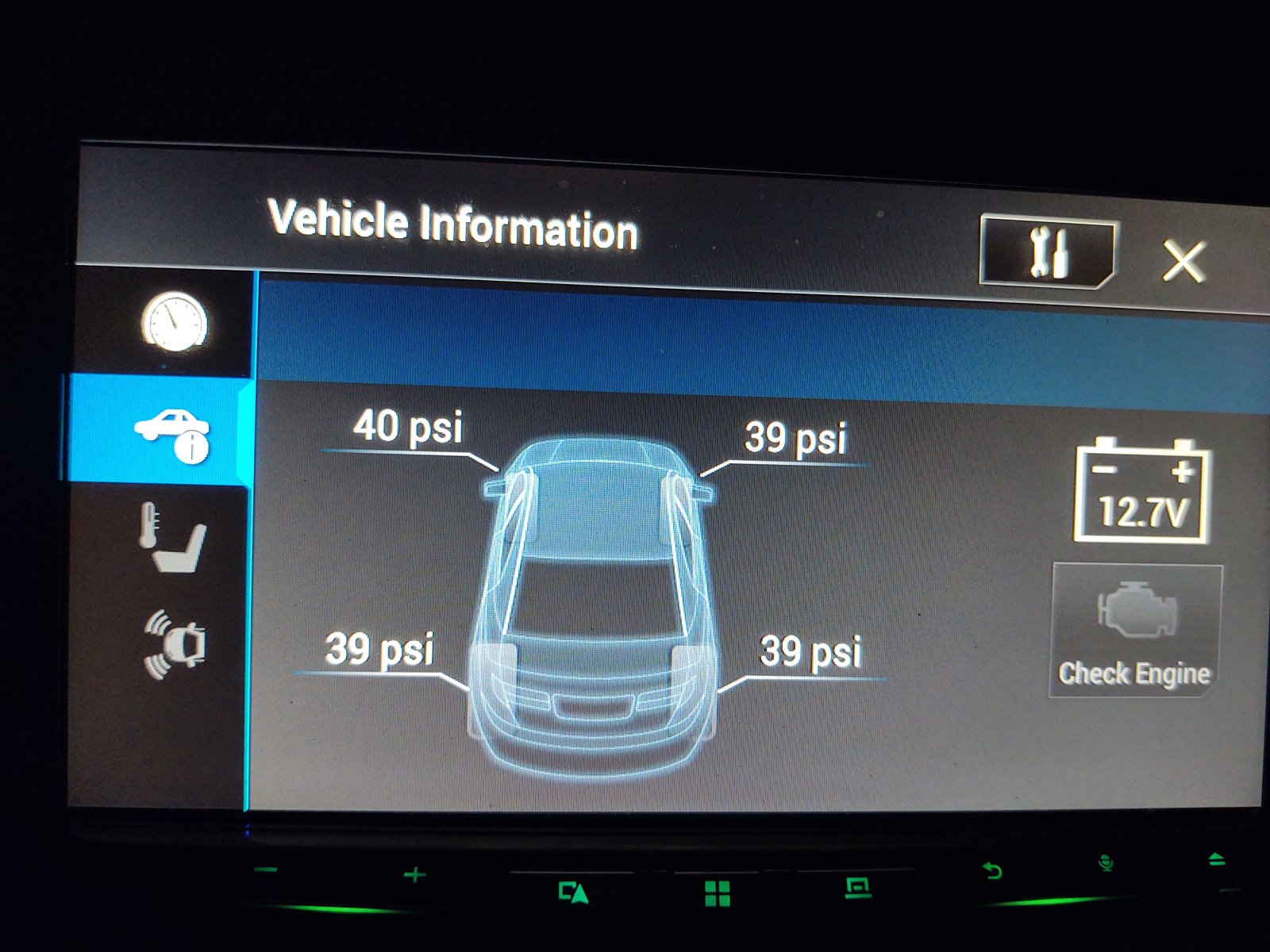

Topped her up with winter air.
Morning cold pressures were getting into the 20's. I try to run 35-40.
She was being Finicky for the pic, but they were even.
30secs later with the key off, 2 more tires dropped. lol

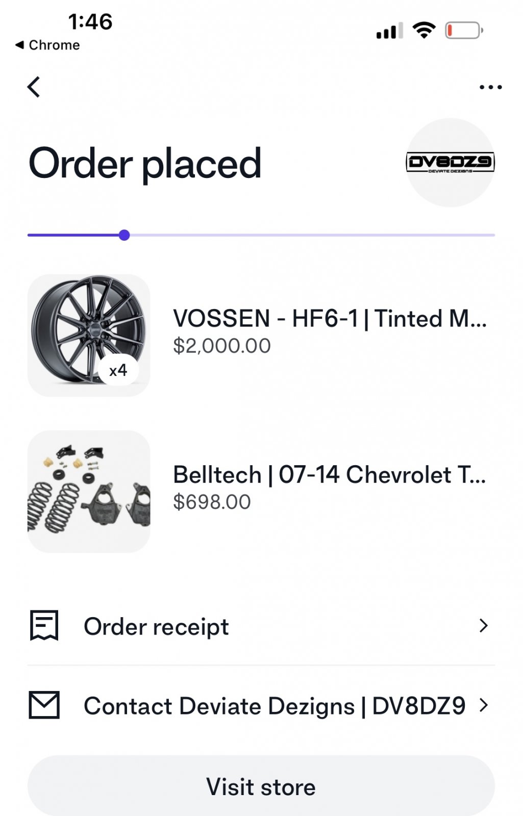

Finally took action on getting new shoes- 24” Vossen HF6-1 in gunmetal grey and a Belltech 2/3 drop kit for my Denali. I have not seen a single NNBS with HF6-1 wheels just many newer ones.
Feel like I got a crazy good deal on the Vossens as they were 850 a wheel everywhere else I looked.
It’s the start of an upcoming cam/SC build that I’m finalizing package details on this week.

Fkn beautiful under there. Can I bring my shit box down there and tinker on it at your place with you on yo lift?

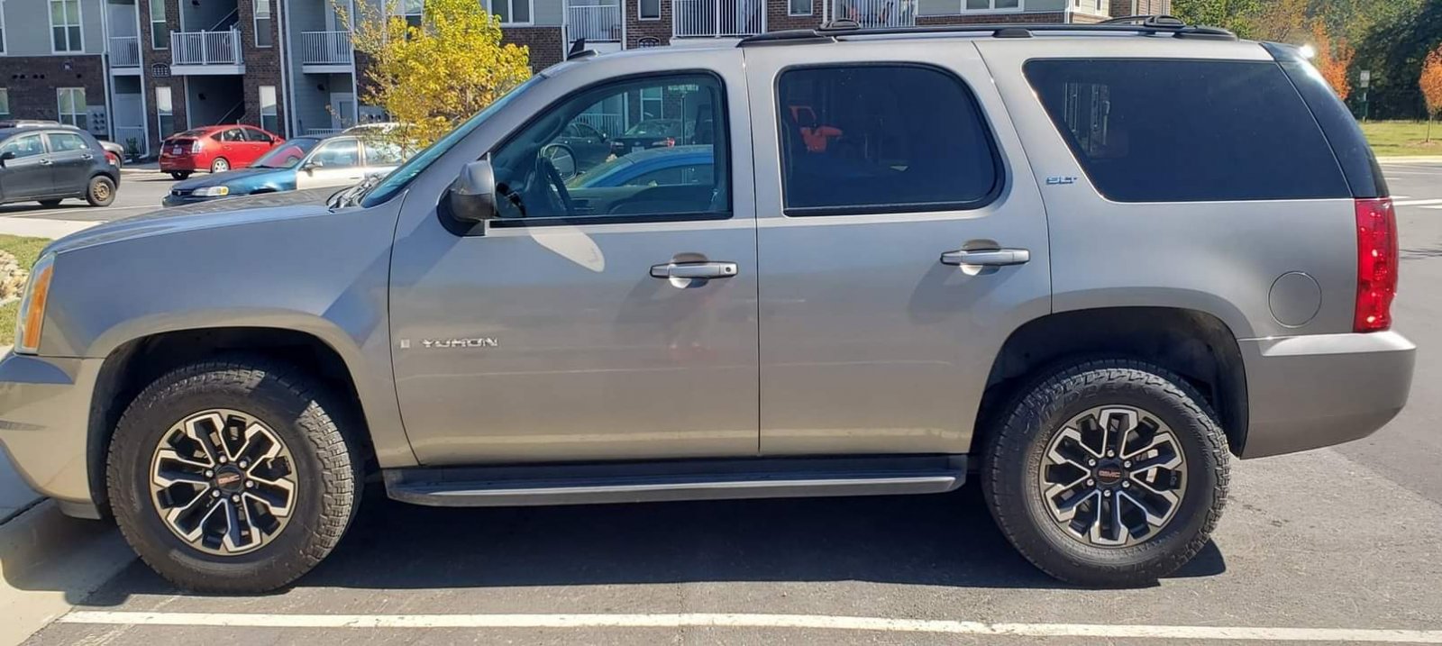

Left and Right Mirror fold motors and gears from gruvenparts.com
Left Rearview Mirror Actuator pn 15874997 (my Yukon build date is 1/2006 2 pigtails...post 4/2006 is single pigtail gen2)
Front and Rear Moog sway bar bushing and arms
Replace faded 3rd tail light spoiler with great used Escalade spoiler
Updated to GM Silverado 2021 option 18" rims
