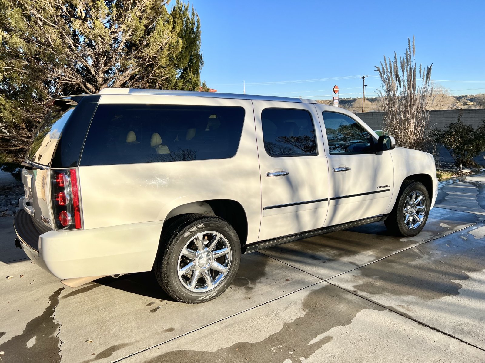

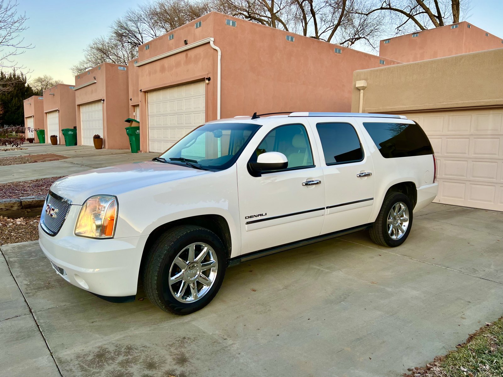

I did a quick ceramic coat before winter set in. I still need a bit of paint correction but wanted some protection especially on the windows and trim.
