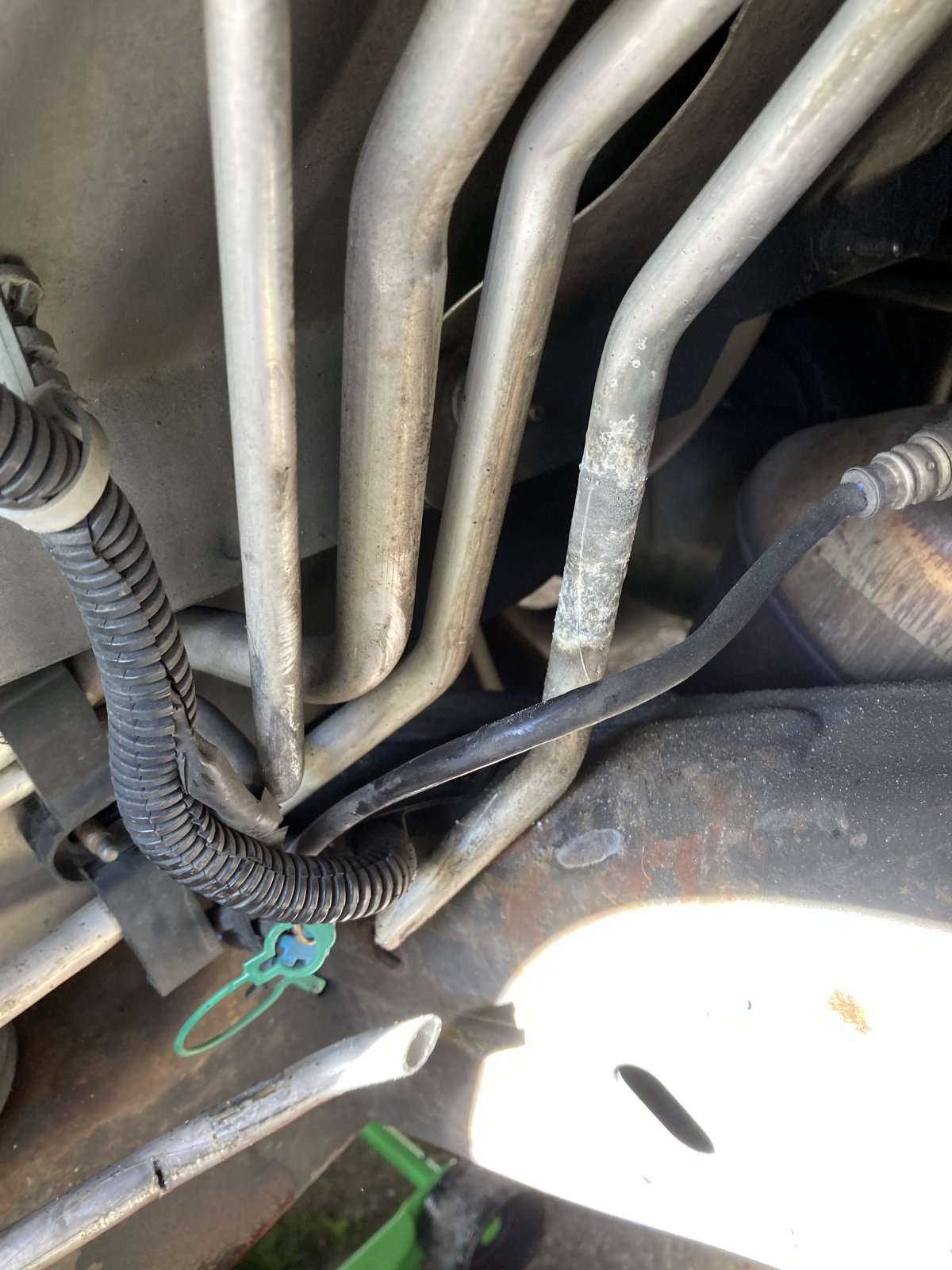

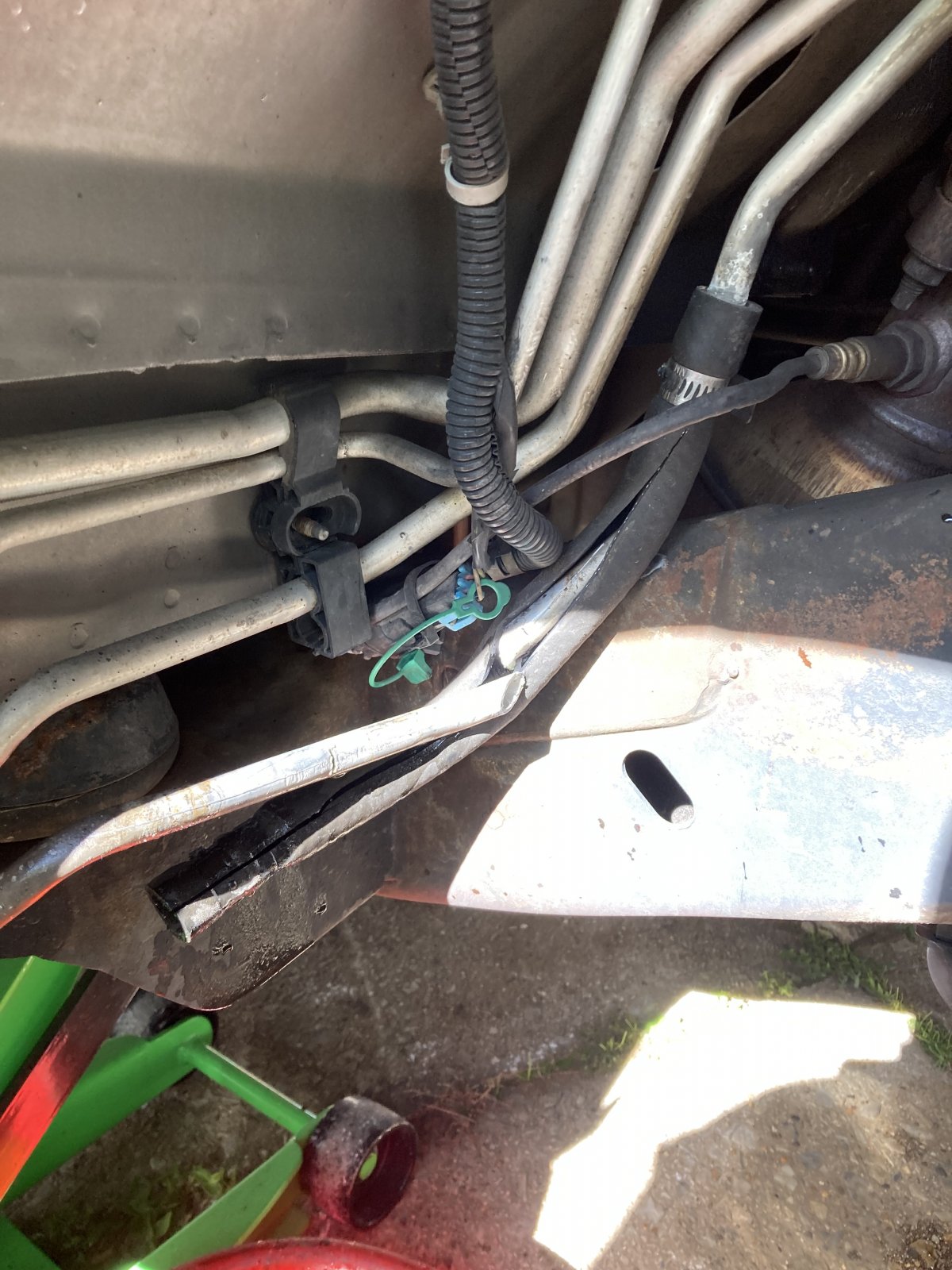

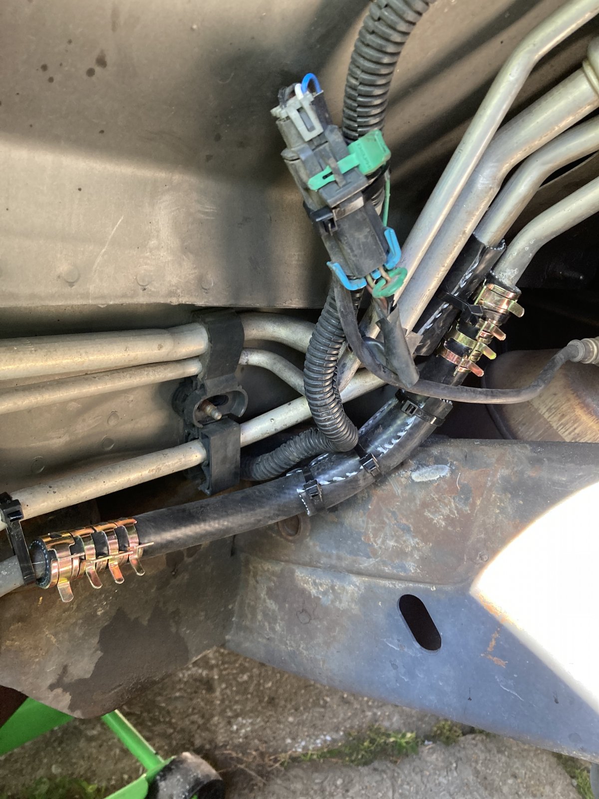

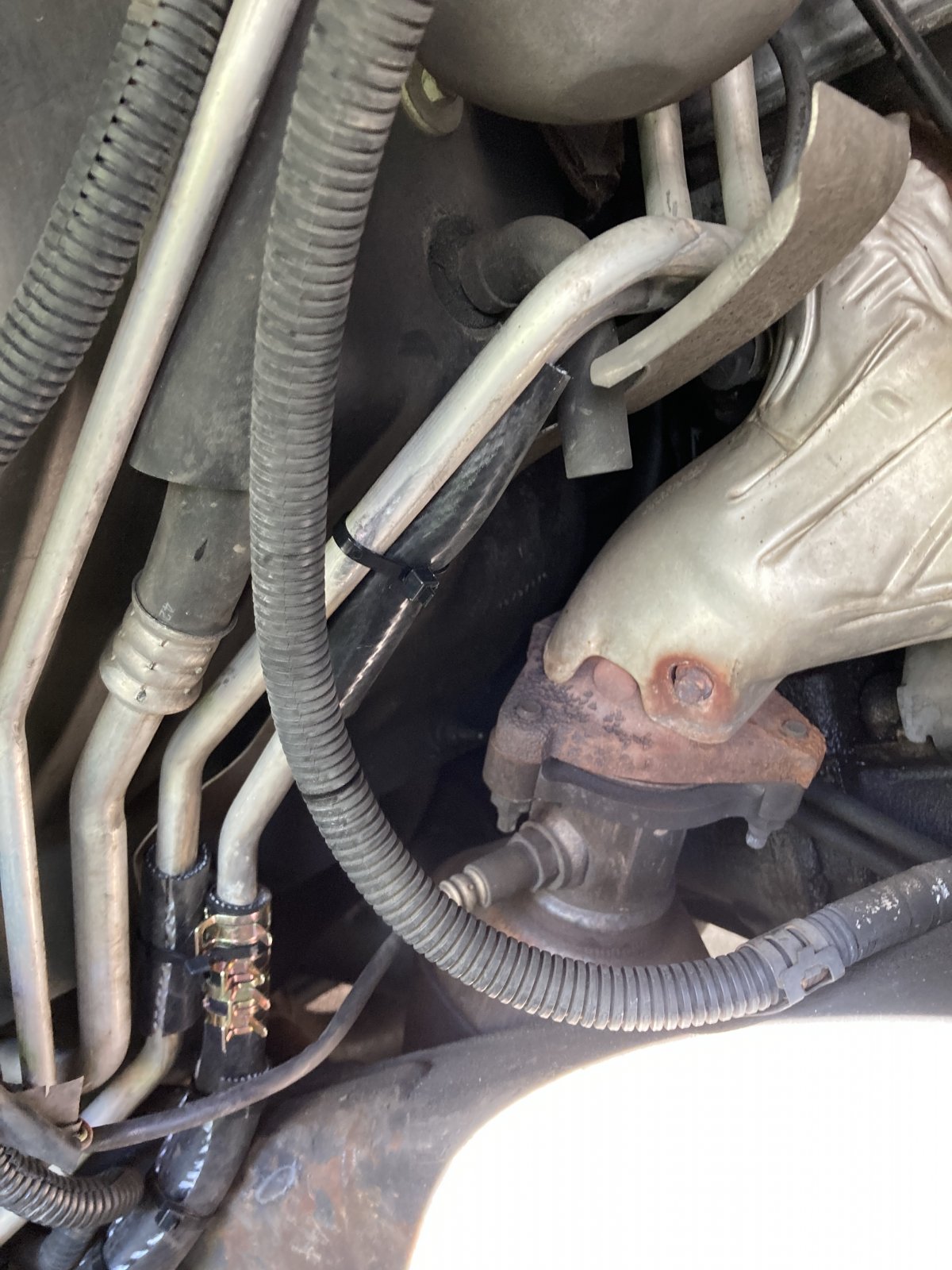

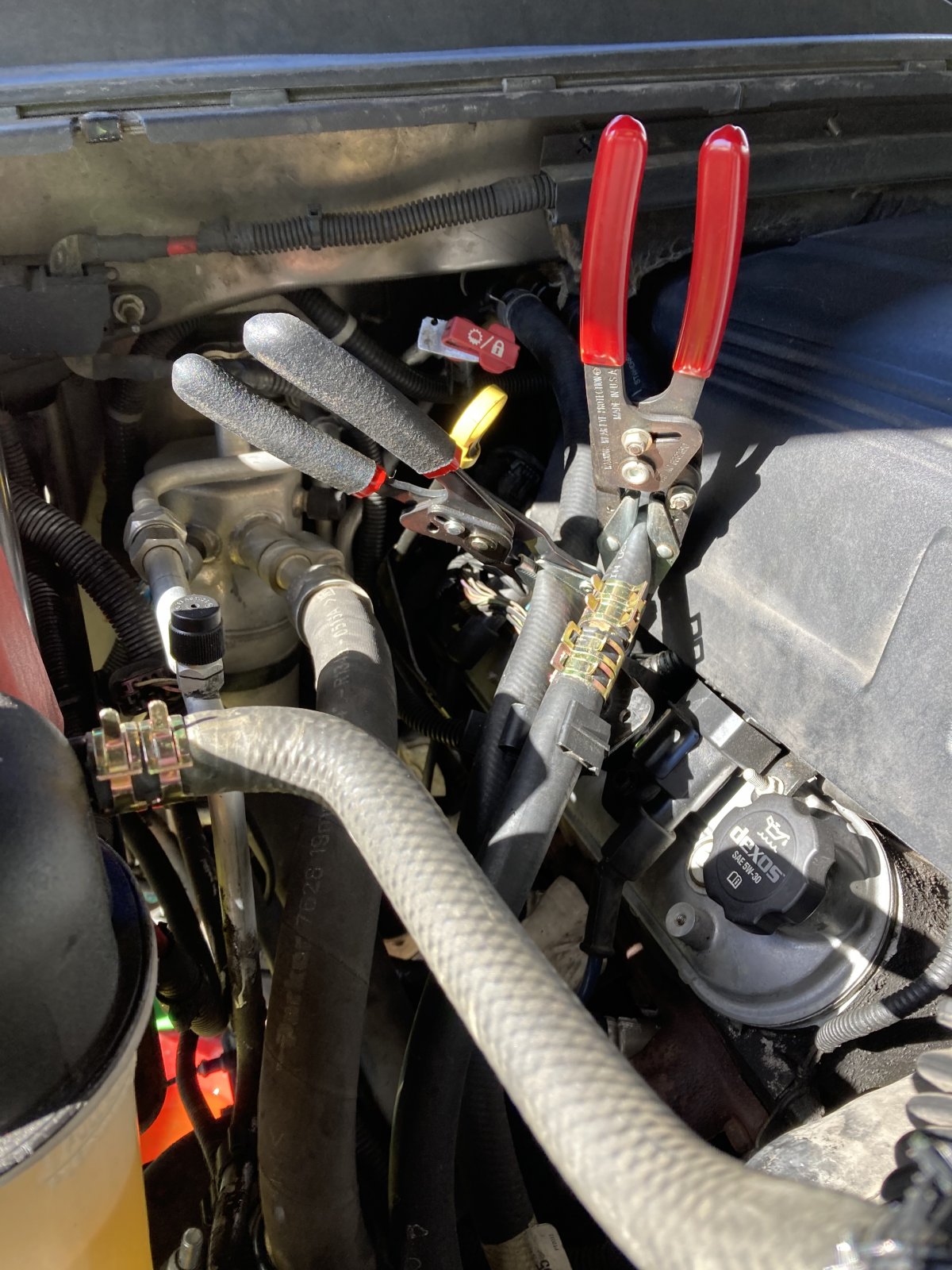

Finally had time to investigate the hack job splice on my heater line in the front wheel well. Oversized hose clamped down with screw clamps. One I sliced the old hose off saw the hacked up hard line. Cut the bad sections out with a tubing cutter. Installed new silicon hose and spring clamps. Made some insulating sections of hose where things may rub. Went a little bit overboard with the clamps just got extra sealing force and insurance. Fired it up and ran the coolant temp and pressure up to test for leaks. Came out great. One less thing on my mind to worry about. That old hose was beat and dried out. I use hose pinch pliers on the engine bay heater hoses to keep the coolant in the engine/radiator from draining out. Drain pan had about a quart and a half of fluid that came out.
