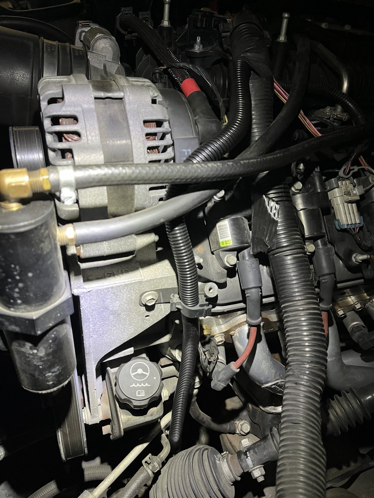

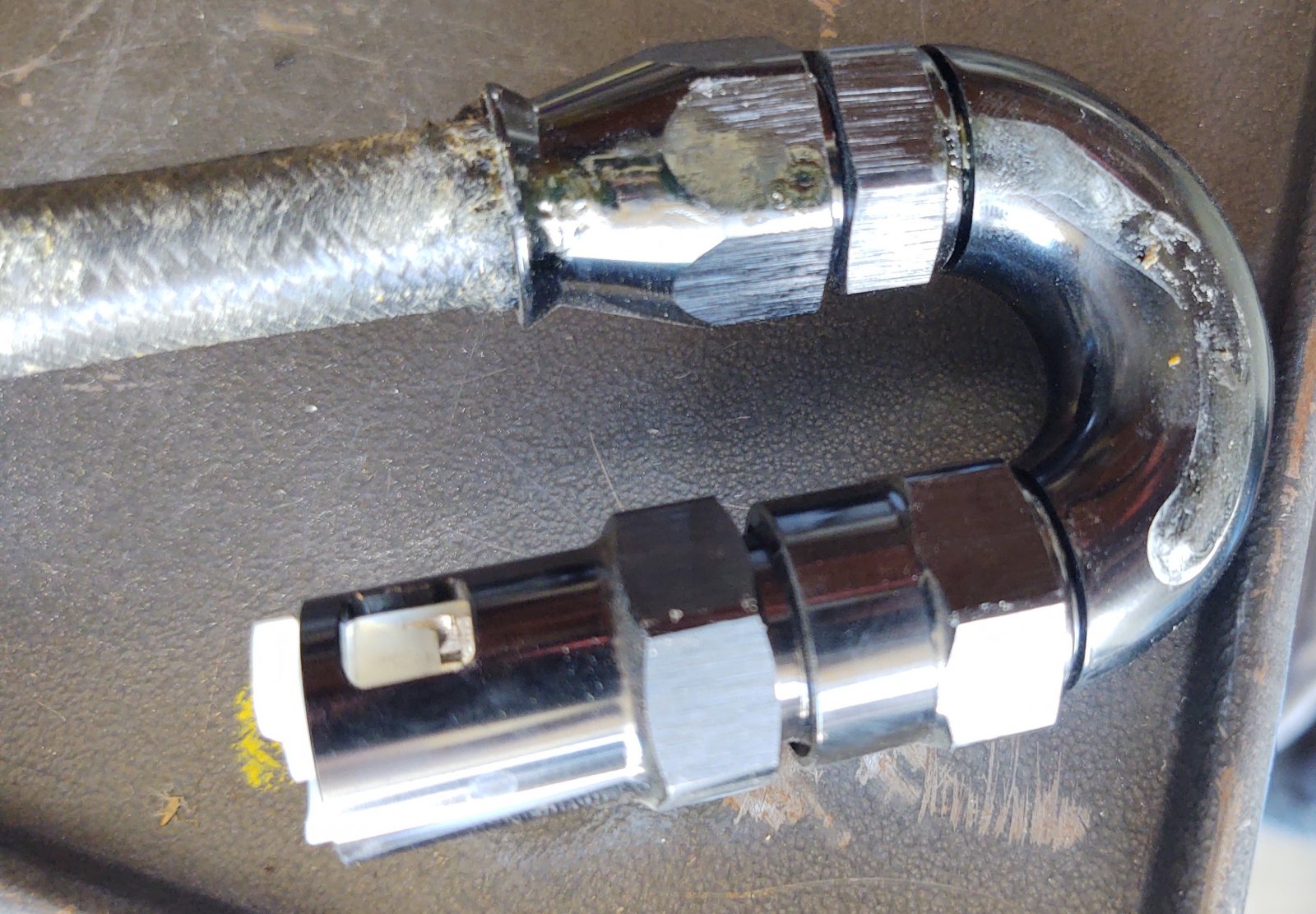

Here's another angle of the routing. You can see the new line that connects the transmission cooler fitting from the radiator to the auxiliary TOC. Some dumb GM oxygen-stealing mouth-breathing smooth-brained dork designed the dumbest thing for this system.
The same numnbnutz that have you remove the front bumper to change a headlight lamp.

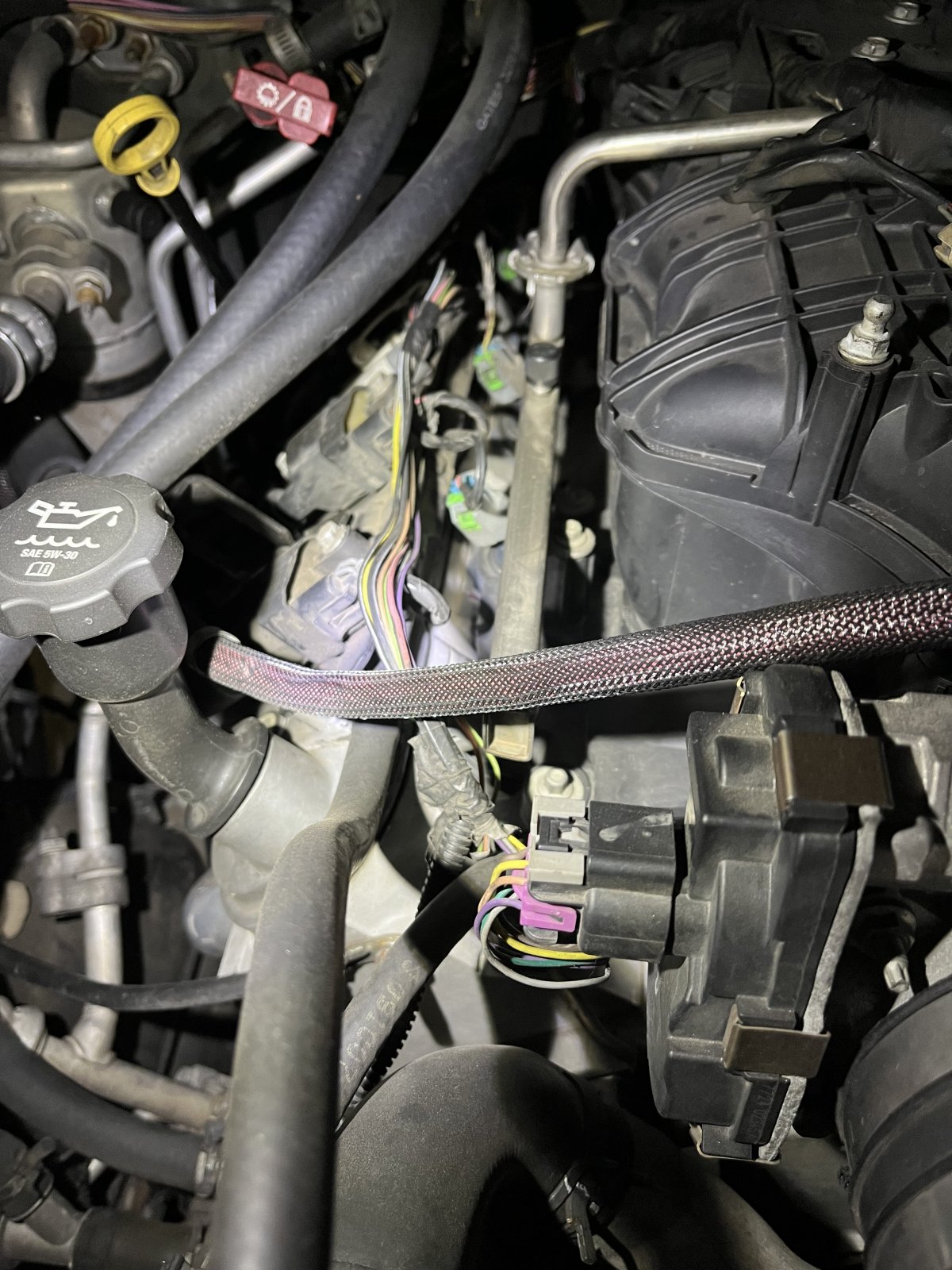

This was actually a week or two ago, but I experimented with the wire loom from Hazard Fraught. I installed it on the exposed wires that run down behind the power steering pump:
It says it's rated for up to 200°F. Either it doesn't get that hot in this area or it's underrated. I had plenty of idling and hard driving on it to get it heated last weekend. Next will be all these other exposed ones. The one I put on is 1/2" and I also bought 3/8". Might go back for the smaller stuff for the injector and coil wires:
I should get some proper high-temp harness tape while I'm at it.
Did you try to unbolt the cooler from the frame to give you some slack?
Need to add this to my to do list.
Is it regular split loom like I see or are you talking about woven stuff?

The hard line on the right (that's the transmission cool I'm referring to) won't go out of the hole my booger-picker is pointing towards.
Ohhhh those!
Yeah, those were "interesting" for me to get out.
You need the whole fkn line free, that means the crossmember under the engine/front axle.
I'm not sure if the front axle needed to be out or not, but the crossmember was in the way 100%
Once it's out, you can tilt it to the side and down and out.
there is also a little bracket on the other side, don't forget it.

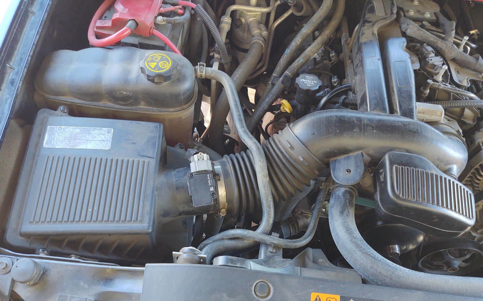

Kind of forgot how loud the intake really was as well. The stock intake is ridiculously quiet in comparison. But I kind of wondered what this exhaust setup sounded like, but I can never tell because the intake was so much louder. Haha
Pretty sure I'll be able to use the Corsa intake box with the Whipple intake tube, the couplers on the factory tube and the corsa tube line up almost perfectly.

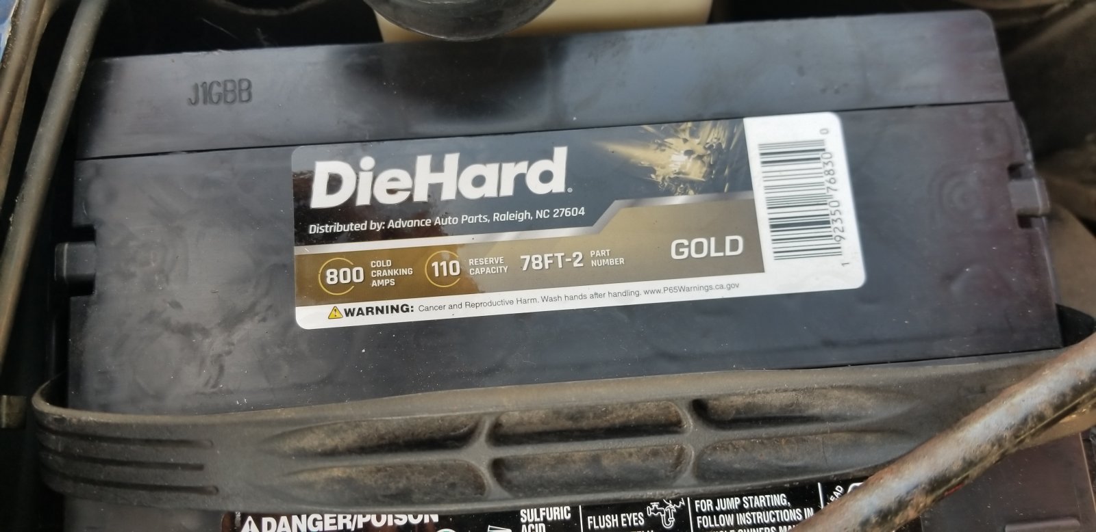

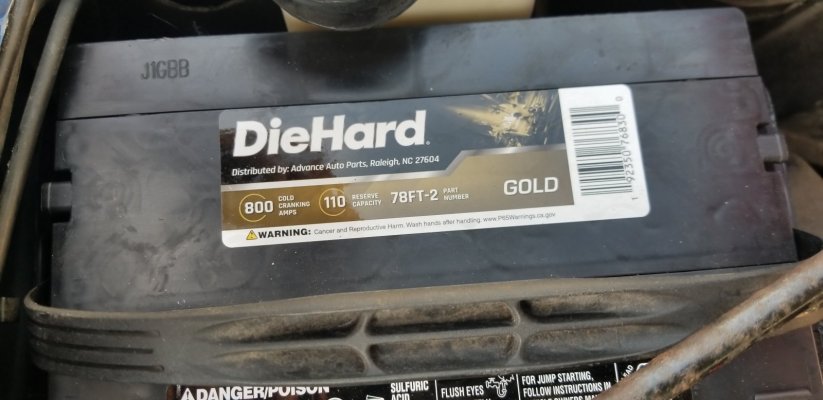

Just did some googling finally, thought I was Sol because my DieHard battery is only 2 years old and dead, I bought it from pep boys, right before they got rid of all of their stores and just kept the service departments.
Turns out advanced Auto parts now Carrys diehard, so hopefully I can get it swapped out from them for free!
33,203
51,461

Just bought my Diehard Gold from them.View attachment 373832
Yeah, mine is less than 2 years old and died a few months ago.
I've actually just been running off of my yellow top all the way over by the washer fluid.
I was thinking about going with a Delco 48 months, and then I realized that it's lead acid and not AGM. And with all the stupid crap I do with this thing, I'm pretty sure I would end up knocking a plate loose inside and ruining the battery real quick. I think I need the AGM to deal with all the vibrations and whatnot.
The clean and shiny stuff in the pic. Regular split loom like what was on there from the factory. I don't know if it's made up of the same material. But it looks, feels and smells "normal" and not like the typical Chineseum plasticy rubber stuff that aromatizes Hazard Fraught. I considered doing the woven stuff. But it's too damned hot to be getting that involved. I'll replace what's missing and dry rotted and close the hood.

Ohhhh those!
Yeah, I had the both lines the make up the assembly completely detached from both ends and all supporting brackets.
There was simply not enough room to move the lines fire/aft enough to grant enough free slack to get the front hard line out.
