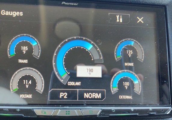

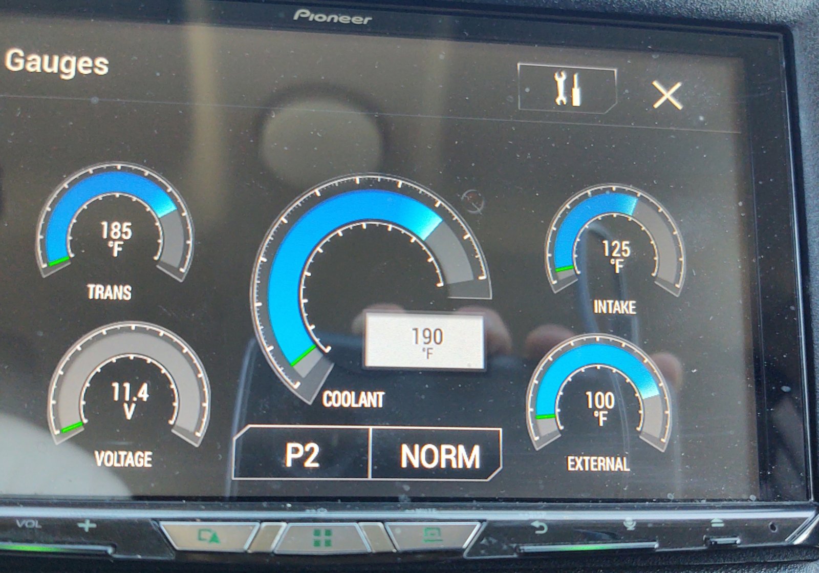

Not sure if something wigged out or what, but on the way home today, AC full blast, sitting at a light.
And then once the engine revs up goes back to 12.5 or higher.
Stopped at BevMo for some refreshments, started it back up and it was sitting at 14-14.3v for the 5 min drive home.

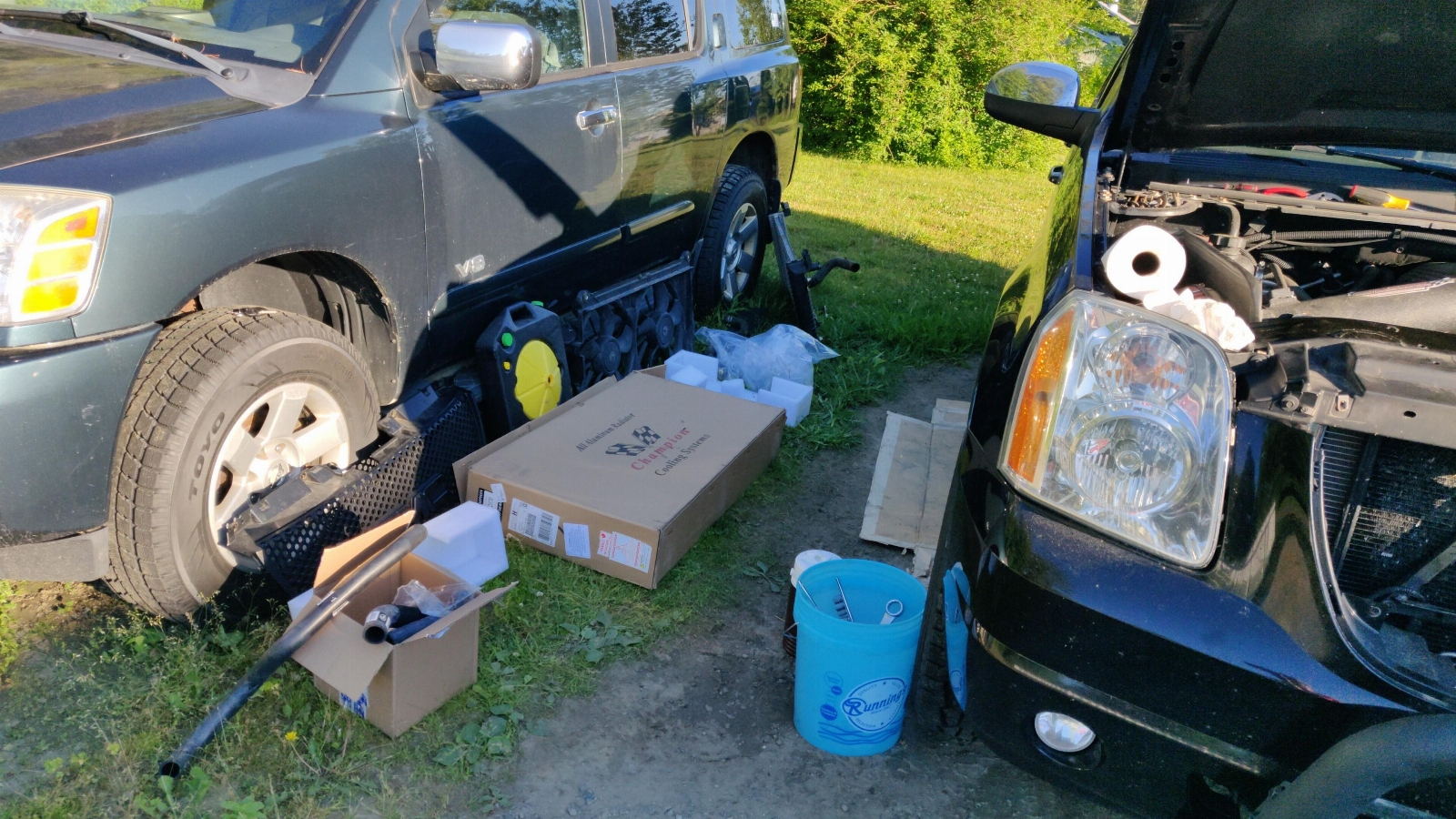

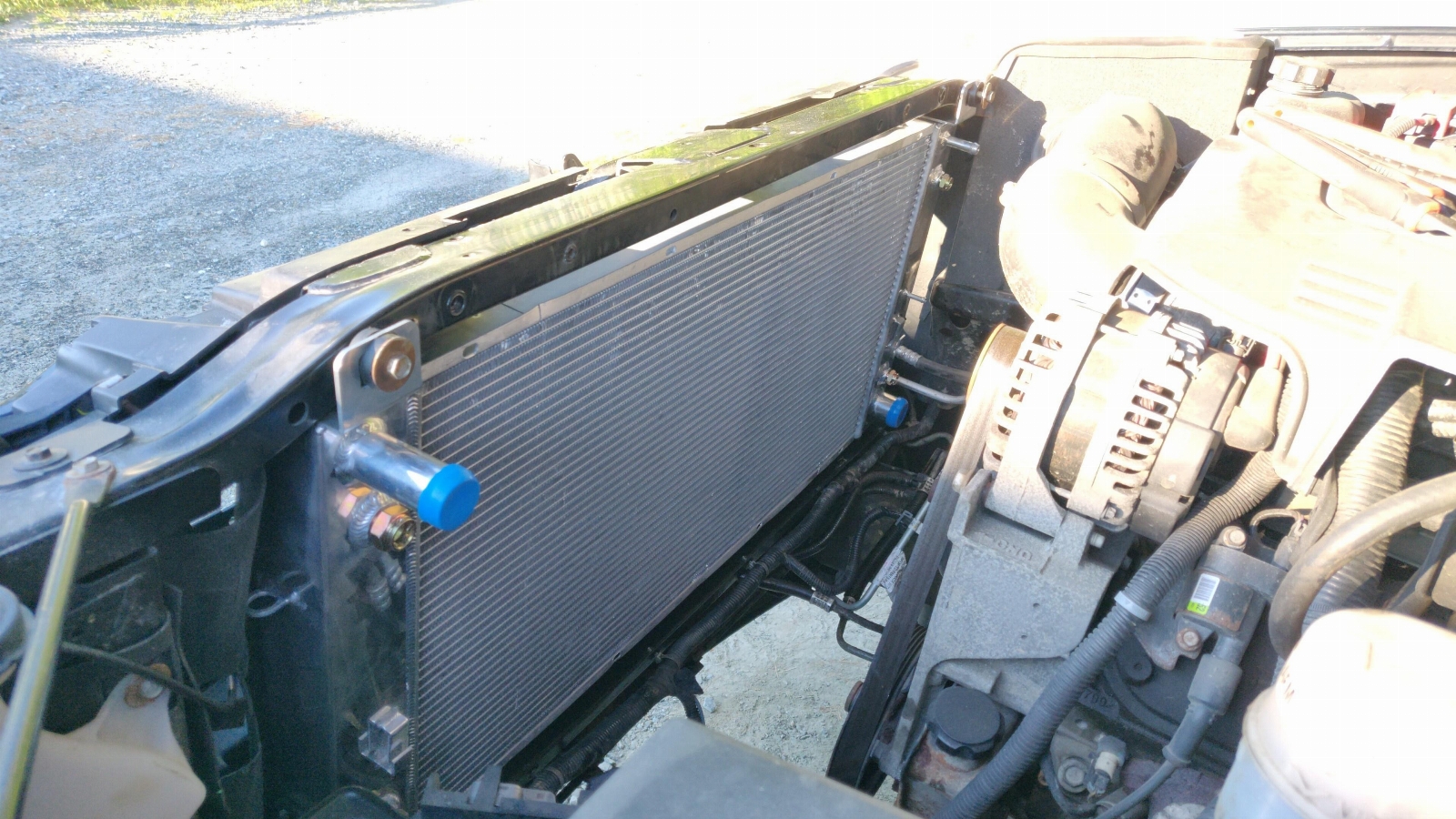

Got around to replacing my radiator, some hoses, and attempted to swap out all the transmission oil cool lines. But some issues popped up.
Had to trim the fan shroud due to the thicker core of this Champion radiator. No biggie, it went in fine, and I thought I was on a roll. Nope.
I can't figure out how to remove the the hardline that connects to the right side of the oil cooler (as you face the front of the grill) from the opening between the bumper and AC condenser.
I disconnected the lines from the transmission, and all clips and brackets, but no amount of twisting, rotating, or pushing would allow for the hardline to make it through the opening.
I ended up reinstalling the old lines because if I can get them out without cutting them, how do I get the new lines in?
Is there a trick for us 4x4 owners that I didn't notice in the videos I watched in preparation for this? The vehicles were either 4x2, or they never showed the removal of the lines.
To add to the fun, after getting everything new swapped in, and all hoses connected, I see coolant leaking out of the reservoir as I'm running the engine to burp the air out.
Wtf! I just replaced that reservoir less than six months ago. Trying to bum a ride from my neighbor to the parts store tomorrow morning to get a new one and finish this garbage.
