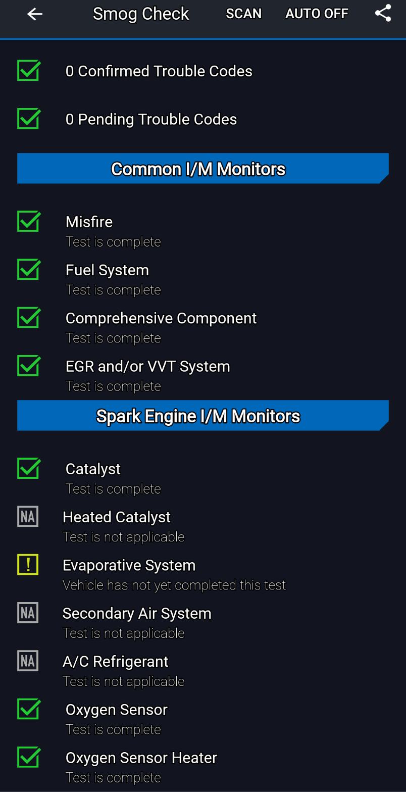

Well, got about a hundred miles on it so far, everything is ready except for the EVAP system...
Sort of running out of time here, not sure if it needs more cycles or if I do have an issue even though there's been no check engine light.
Most states allow one monitor to not be set. Differentiate between being "ready" and being "complete."
It looks like your evap is ready to test, it just needs the specific drive cycle to complete the test. There are very specific conditions for the test to take place -- don't quote me on the specifics -- things like the fuel tank being between 1/8 and 7/8 full (some people recommend 1/4 to 3/4), a cold start where the IAT and the coolant temp are within 8 or 10 degrees, two speed cycles up to 55 mph, then coast down to 25 mph without using the brakes (or something like that, without getting run over). Anyway, it's not going to test unless all the conditions are met, and if your check engine light isn't on you should be good to go.
