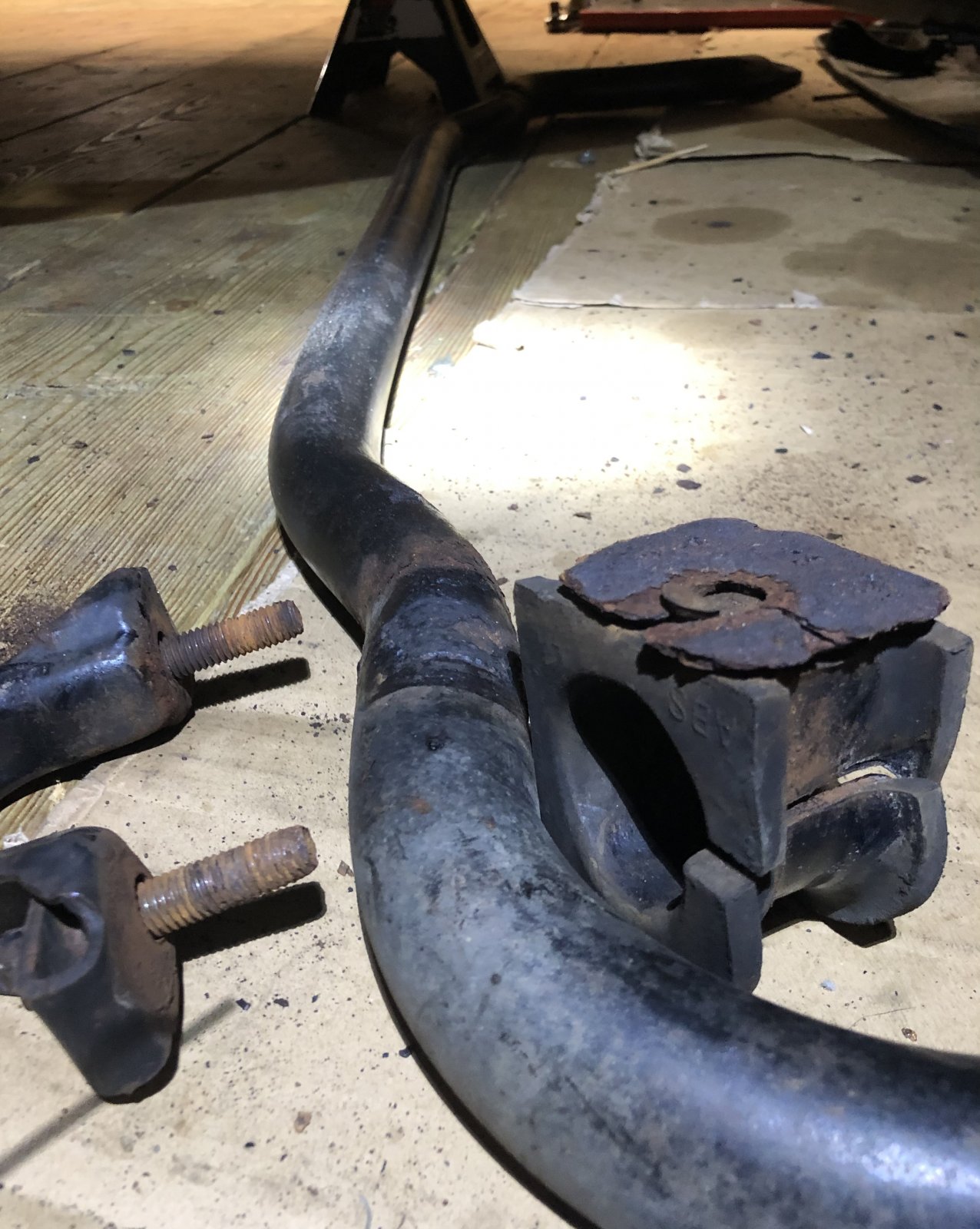

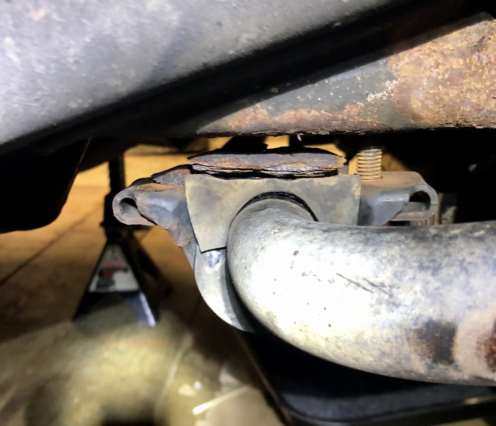

Coil Springs driver and passenger side each have approx a 3” long by 1/8-1/4” deep rust crack on opposite ends of the bottom portion of the coil and are turning to dust…ready to go at anytime. Almost makes me leery working around them, I’ve been really easy lowering the Jack.
Control arm bushings are dry rotted and one of the ball joint boots is blown (I’m 99% sure was from the shop who did my alignment. I swear someone used a needle greaser but I can’t prove it. I know for sure that both boots were fine when I took it in there, but when I got home the grease I found spewing out and slung on everything in the passenger wheel housing was a different color than what I use. And not a different color as in darker used grease, as in: red vs green).
End Links were in “ok” shape, but might as well be replaced while I have the sway bar out.
Sway Bar has a similar issue on either end of it similar to the coils. Almost like someone lubed it up with some power steering fluid every oil change. *if this were the case it wasn’t me* I’m thinking the previous owner just spent too much time on the salty roads in the winter and then let the snow, ice, salt and sand just sit there and eat away at it.
I found this “gem” when I removed the front sway bar. There’s a TSB about this mounting area completely rusting out on some GM trucks/SUV’s and needing a new bracket welded on. Luckily mine wasn’t there quite yet. I did find it odd that the front sway bar bushing was installed with the slit facing backwards.
View attachment 349305View attachment 349306

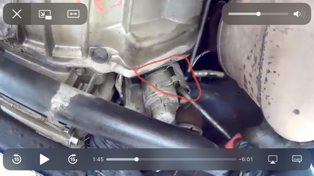

So…. today I bought a new starter. Went to install it and the first thing I found was a loose cable on the starter. Really loose, like 2-3 turns on the nut. SMH. Tightened it up, can’t tell any difference in cranking speed.
This makes me think it’s not original. Also there’s no heat shield on top of the solenoid like I’ve seen in videos. Should that be in place on a 2008 model?
Here’s a pic from a vid showing the heat shield that clips on top of the solenoid.
Now I’m debating whether it’s good insurance to go ahead and stick the new one in, or just a waste of time and money.
If the cable was loose, I would return it NIB.
I think the OE have the heat shield. P/N - 12668713
take that new starter back you solved your problem. wet-loose-cable no go.
*Thanks guys! I appreciate the info, guidance and feedback.
ehh, you have a rust issue. I won't buy anything that has been east of kansas, bleh, get yourself a nice Texas rig no rust!
