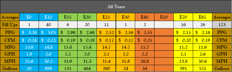

Did you ever run E85 with those funky plugs?
Yes & No
No, the grubby plugs are pics of when I first purchased the vehicle and before I cleaned them and did all the other work I previously described(Dec 2018). They've been in the vehicle untouched ever since.
Yes, in 2020 I drove it for about 6 mths and 3000 miles on a 20-25% mix of E85 and regular 87 octane unleaded.
Since 2018, when those grubby plugs were cleaned, it has been driven on "all" grades of unleaded gasoline. Only once in the 3 yrs and 40k miles that I have owned it have I gotten a knock sensor DIC. That was on a long hwy trip while running 87 octane.
In 2021 it has only been feed premium unleaded.

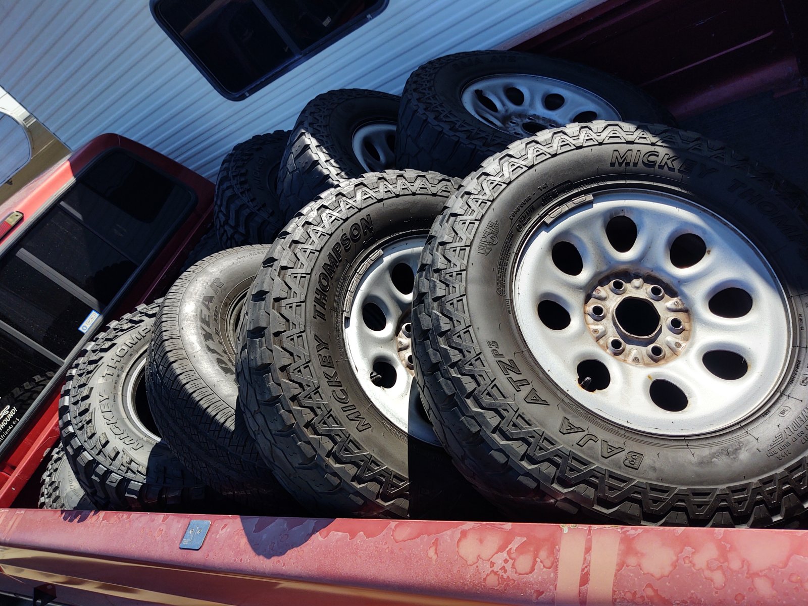

Gave her the 150k blood transfusion.
Threw some new shoes on her too.
The mud terrains are actually quieter and smoother than the all terrains... Which tells me that the all-terrains likely had too many heat cycles and were a lot harder than when they were new.
Filled up the tank with corn as usual.
Still needs a bath severely.
