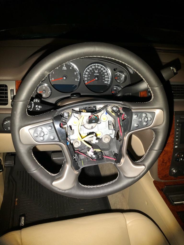

So this fits. Just have to map the wiring.

Nice. What year is that from?
15-20 GM full size SUV. The diameter of the outer wheel rim is larger and feels better in my hands than the 07-14 style.
I removed my factory one for a deep cleaning. It’s leather was very shiny and sticky. 8 yrs worth of eww.
I had the 15-20 wheel laying around and thought I’d try it.
Depending on what’s easier, I may swap out the coil spring on my 2012 with one from a 15-17 and make an adapter harness so the connectors on the steering column match up.
