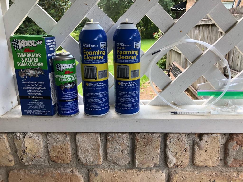

The retrofit is very easy. Once you remove the lower beauty/sound cover on the passenger side, you can see the outline on the bottom of the HVAC plenum.
I went with the Dorman 259-201 kit. It comes with the carbon filter and a good set of instructions.
Dorman 259-201 Carbon Cabin Air... https://www.amazon.com/dp/B00NF1SK1M?ref=ppx_pop_mob_ap_share
For cleaning, I referenced this video. In addition, I also cleaned things from the inside the cabin using the opening I cut for the filter and used the cleaner with a nylon brush. I also dropped the sensor and fan to clean in the plenum. There was lots of dust. Lol, I also plan to remove the wiper cowl and clean from the top side. There’s debris on top of the outside air intake screen.
Plans to also do something similar to the rear HVAC core/condenser & plenum. I don’t expect it to be as bad since it only pulls air from the cabin.

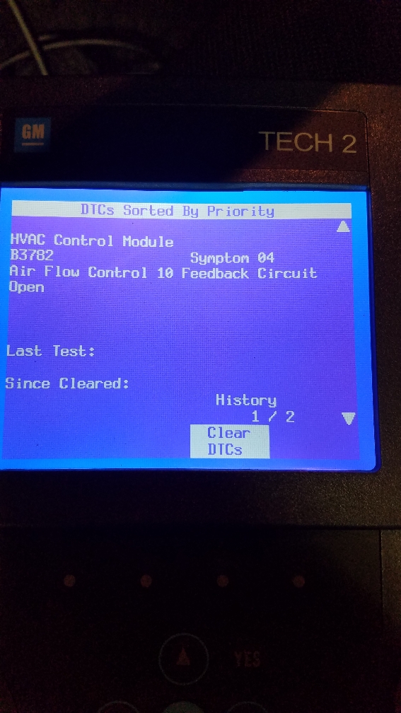

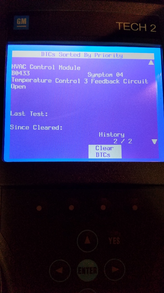

I was just out in the garage hooking up the Tech2 to reset the trans fluid monitor. I didn't have the engine running, just the key on engine off. The headlights, radio, and HVAC all came on and I turned off the headlights while I stood next to it with the door open and the Tech2 sitting on the seat.
I decided to check for DTCs while I had it hooked up and got 2 for the HVAC system as pictured below. Are these because I had the vehicle on with the engine off and the HVAC still turned on?

Did you try it with the engine running to find out?
