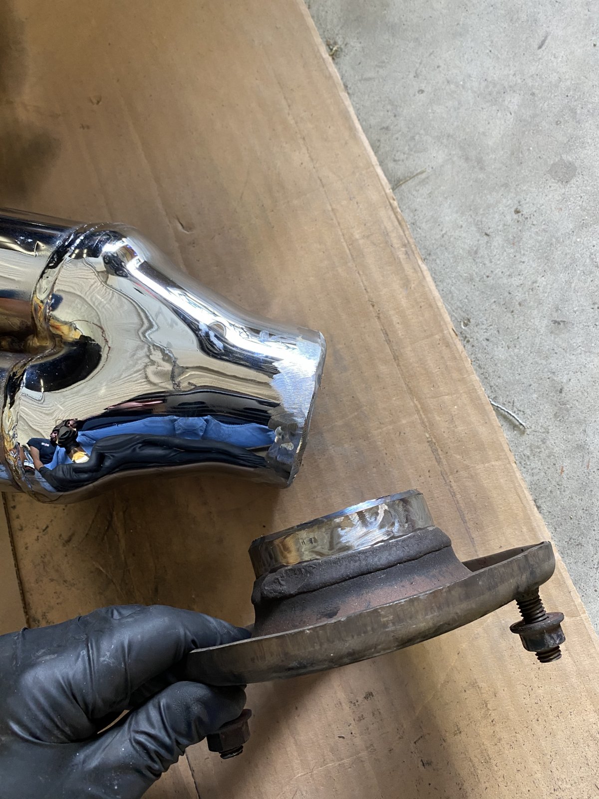

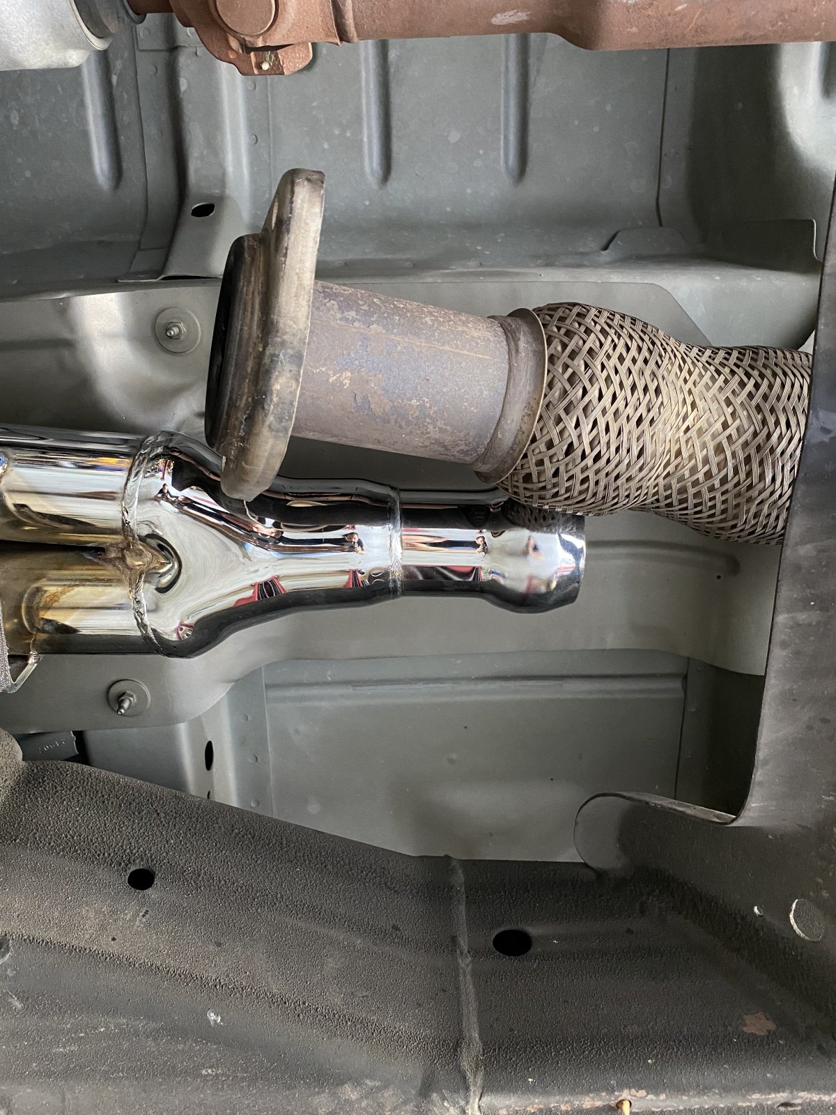

Doug Thorley Y-pipe has the ball-and-socket connection, my Tahoe has the flared flange:
Used a grease pencil to mark the collector where I wanted to cut it, before the tapered-down part:

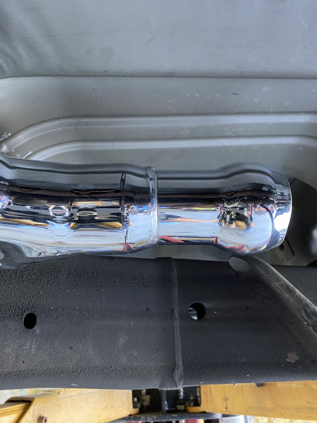

Cut off the ball-and-socket from the collector and the flange from the factory Y-pipe and beveled the edges of each since it was a butt weld:
Finished. Cleaned the welds and sprayed with high-temp primer and paint. I also sectioned out a couple inches between the flange and flex joint:
It's still much too loud for my liking, but at least it's now coming out the tailpipe instead of under the floorboard. I have an electric cutout on the way so I'll be chopping up the exhaust again. I may install a second flow-through muffler in series with the current one to quiet it down or maybe reinstall a factory muffler. With no cats, I'm sure a stock muffler would still have a meatier sound to it.
