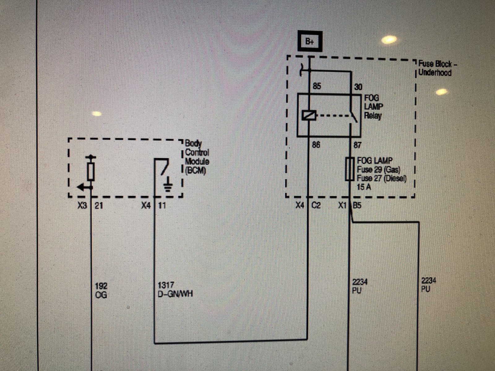

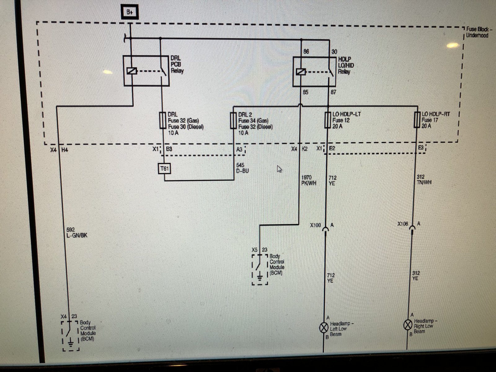

There’s a separate DRL relay that’s triggered by a different wire from the BCM than the one that triggers the headlamp relay so that should be no. I’ll check tomorrow. If you look at the schematics you can see the negative signals from the BCM. The fog relay is D-GN/WH going to pin 86 on that relay, the headlight is PK/WH going to pin 85 on that relay and there’s another trigger that goes to the DRL relay. I’m jumping the fog and headlight trigger together.
Edit: now that I look at it, the fuses are after the relays so there’s no way to “piggyback” two lighting circuits onto one fuse. I checked and those fuses only show voltage when that set of lights are on.
20A359EB-A949-4858-8623-0BCE5F2010A4.jpeg 9895715B-BBDF-4582-B34F-D6E6409690C5.jpeg
