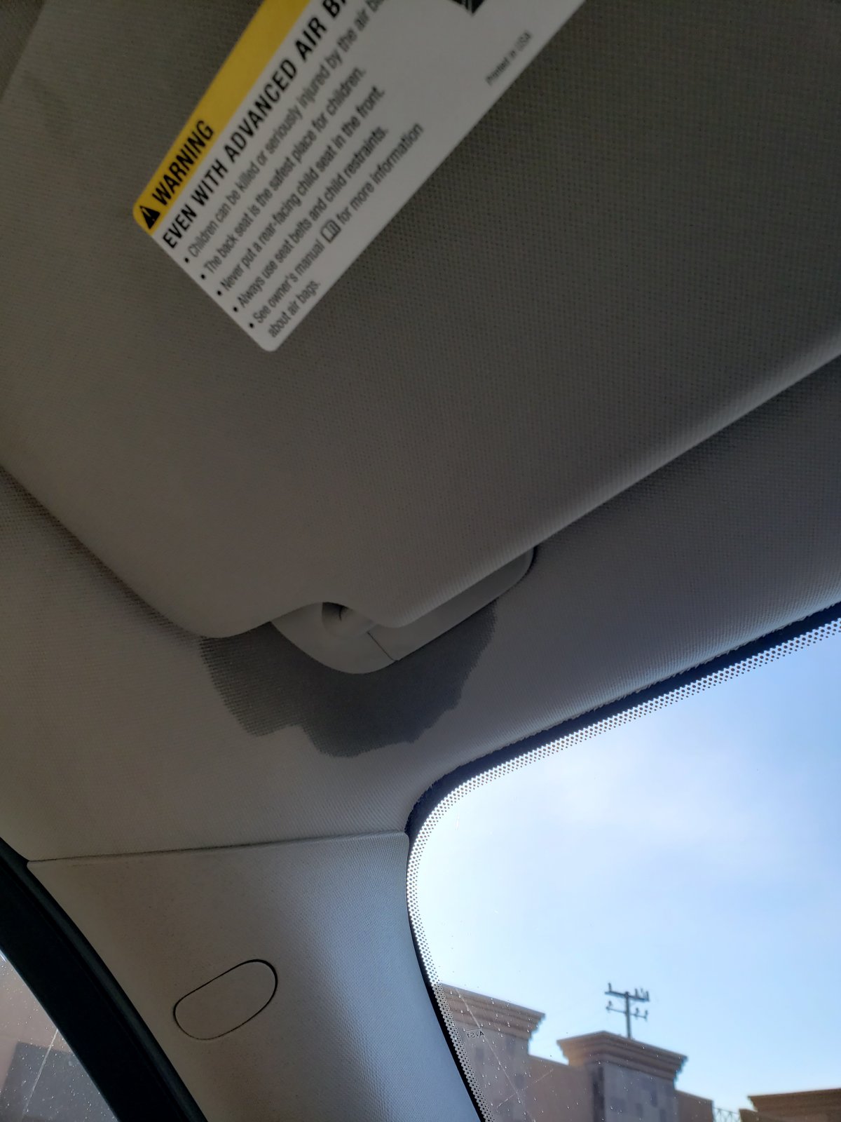

Just drove through a car wash and this happened. WTF? it also sounded like water gurgling when i jumped on the freeway. View attachment 246031
That’s a lot of water.
Do you have a sunroof? If so, check your two drain lines at the front corners of the sunroof. I use string trimmer line to snake them out.
I would also check your OnStar antenna to make sure it isn’t loose.
You could also use that canned compressed air to blow out your drains. The type you use to blow out your keyboard.

Yeah, i have a sunroof. Its never been an issue going through car washes till today
i have to the close the shade on mine when going thru a carwash or it pisses a few drops on me thru the glass seal but the corners have never leaked and it doesn't leak when it rains, just from the high pressure water spray, I have read of some people cleaning the drains out with air pressure, you can try poking something down the drain hole's but from what I understand the drain line is plastic down inside I wouldn't try to force it.
