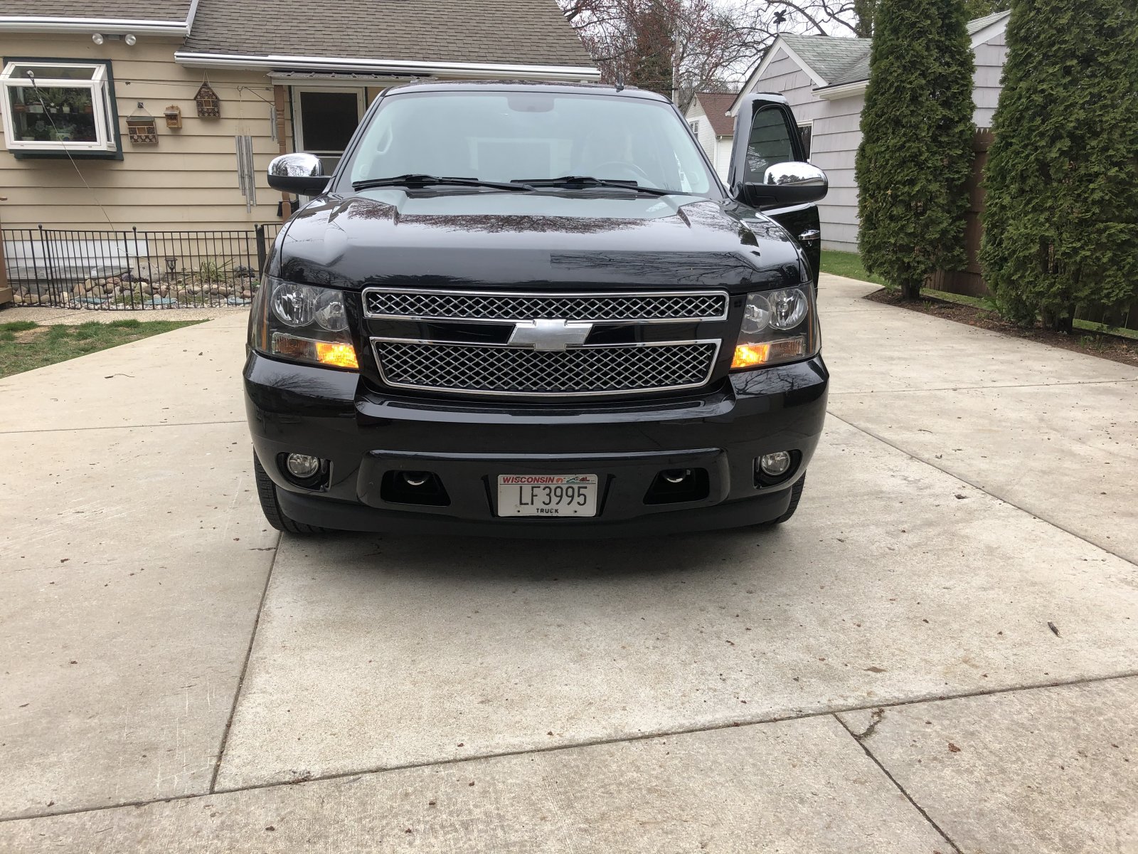

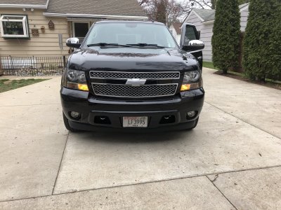

Had some busted headlight mounting tabs so I pulled them both and made repairs. Went to amber DRLs while I was in there. What a job that is!

Thanks! I should have taken more pics but I was having trouble with my back and needed to get done to go get a trailer load of fire wood. I ended up doing both of the bottom ones the same as the photo and one outer top one. Turned out good. Need to check the aiming of them now.

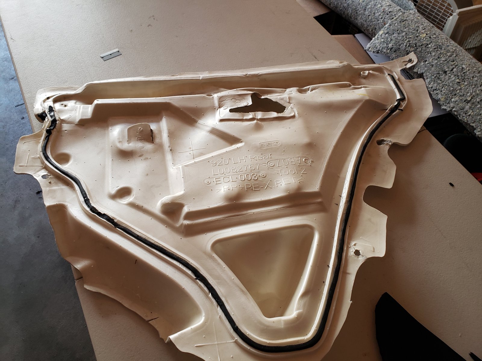

A week or so ago I mentioned adding padding to the rear wheel wells, I didn't get pictures and got rightfully scolded. I don't want to tear it all apart again, but today I was able create an example. I also added a layer of padding over the insides of the doors and up around the door handles. Here are the pictures:
This is what I started with in the rear, this isn't my Tahoe but it's an example of the lack of insulation.

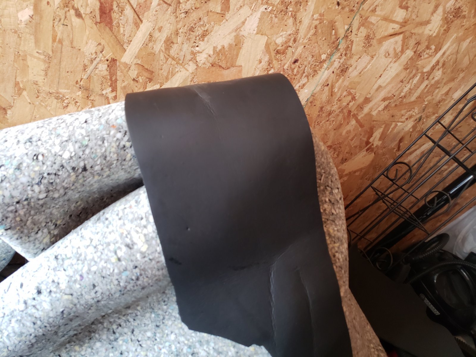

This is the materials I used to cover the wheel wheels, the jute then the black stuff over the jute and up the side wall
Here is a front and back picture of the black material

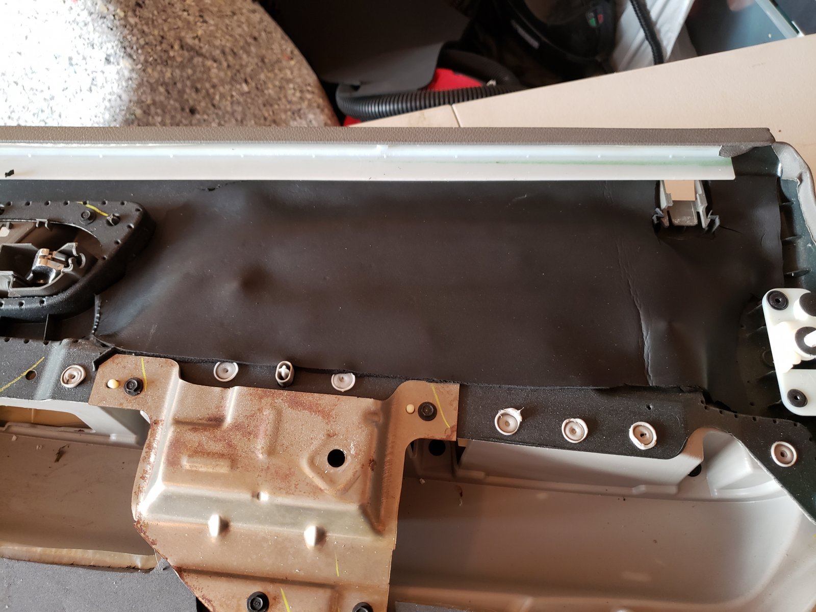

I got the idea of lining the door skins from looking at 05-06 Escalade Platinum door skins. Normal Escalades in those years had just white cotton stuff, but the Platinums had a black layer over the cotton. Since I work at a packaging place, we have all sorts of foam for all sorts of purposes.
All of this work has paid off, it is super quiet inside and I can't hear any rattles

Just curious what you used to attach the extra materials? Spray adhesive or?
