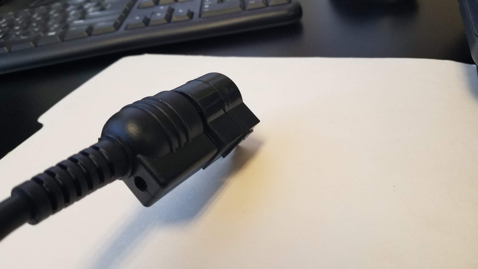

Video I saw had the Tech 2 reboot after the starter cranked. Even with the 12vDC cord plugged in, the Tech 2 tries to draw power from from the OBDII port first. As long as there was power detected from the OBDII port, it would not kick over to the 12VDC feed from the other power supply. The switched extender cuts the power coming through the OBDII port, but the rest of the data does its thing. Since the power is cut off from the port, the Tech 2 will run off the 12VDC supply.
This may only be with the clones... Maybe it was only an issue with older clones, that has been since resolved? The video was from 2020. Maybe the problem has been fixed by Vetronix already?
The guy in the video found that his rebooted when initiating the engine cranked over. The switch seemed to solve that. For about $11, i figured it would be good to have if it kept the tTech 2 from rebooting during a diagnostic session that requires starting the engine.

The guy in the video had the 12VDC supply was plugged into the port on the cable...
Not on the port on the bottom of the head unit...
If using the port on the head unit prevents the voltage drop from causing a reboot when the engine cranks, then I might have wasted $11 on the Ebay switched extender.
Maybe mention of this in our discussions will actually save people from thinking they have to buy that cable.
Anybody want to buy an unused switched OBDII extender cable? LOL
Follow-up: Vetronix instruction book says 12VDC "To ensure proper ground, power tester through the DLC power jack, NOT the power jack on the Tech 2". They are referring to the port on the cable for proper ground... However, that is showing the 12V power being fed from the 12V cigarette lighter power cord. Use of the AC to 12VDC power supply would be properly grounded (one would expect) at the wall outlet, so it can feed directly to the power port on the bottom of the Tech 2 device.
