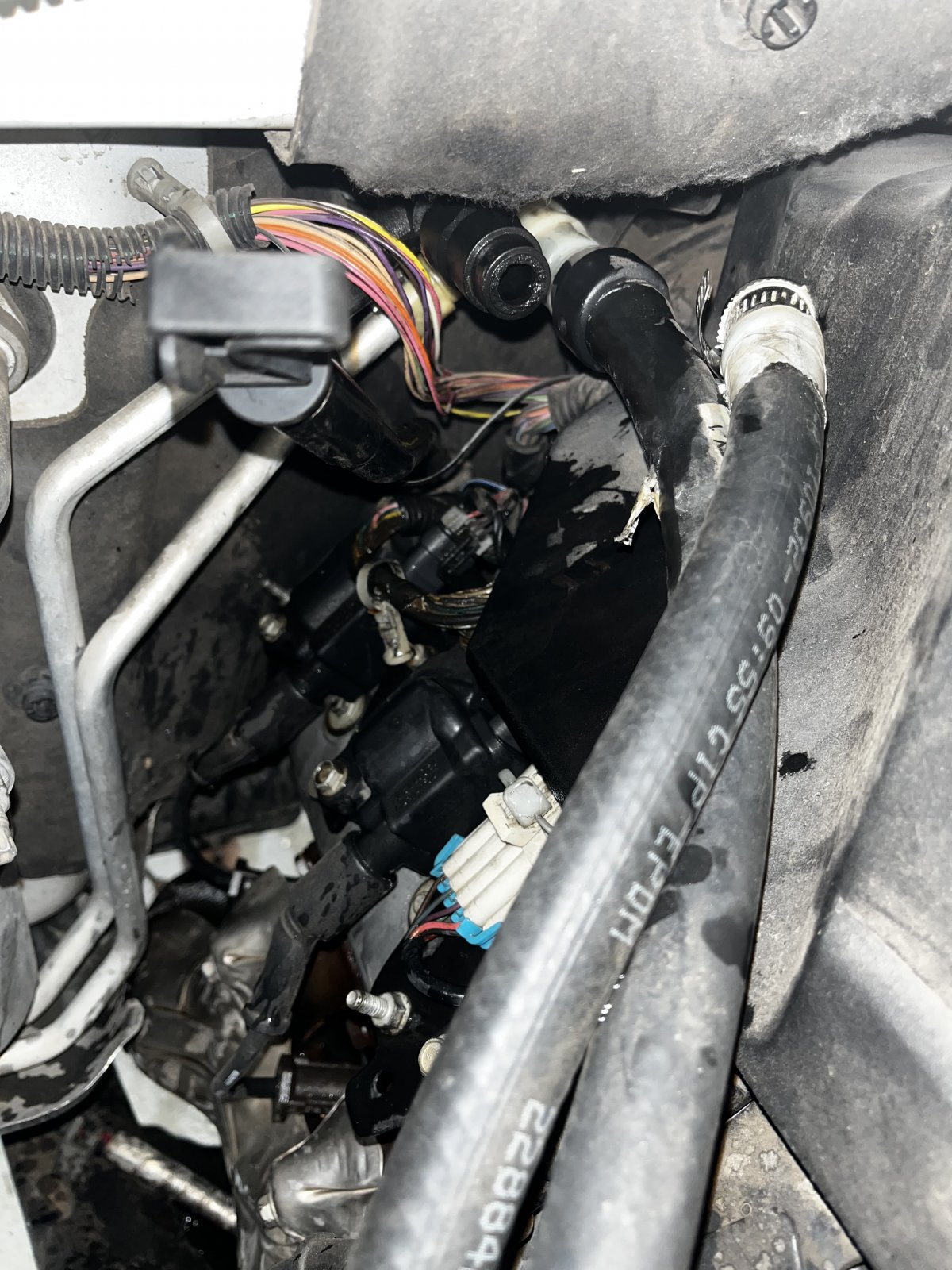

Due to the offset on the Tundra wheels I added a 1.5” hub centric in the rear to bring them out closer to the fenders. I saw one the heater core tees seep coolant. When I went to tighten the clamp, it broke off . Took the opportunity to get the all metal Dorman tees for both.

These Dorman metal tees are interesting, but I wonder what "metal" they are made of. Kind of wondering if there will be any reaction between the heater tubes on the SUVs and these.
