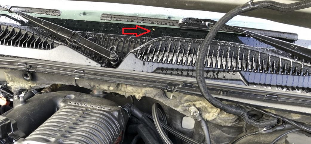

Fine i cleaned the leaves out. Now get off my a$$. :DView attachment 363234
missed one

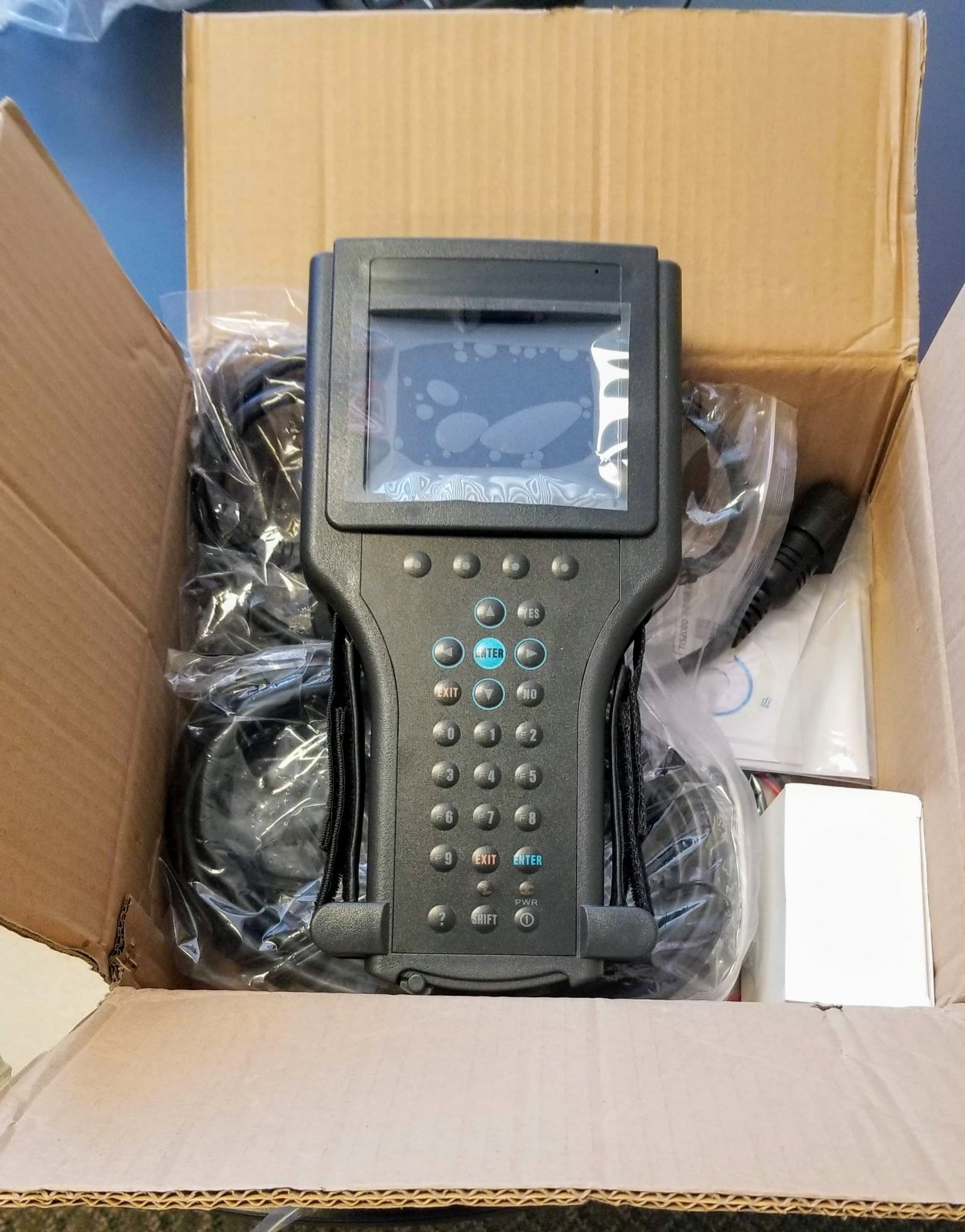

Chinacardiags.com shipped my Vetronix Tech 2 clone really quick; and I received it in less than a week.
Having come all the way from Hong Kong, I am pleased with the condition that it arrived in via DHL. Carton was in near perfect condition!
I can't wait to begin saving all kinds of time and money!!!
I also ended up ordering the OBDII switched extender cable, so I can plug in the external DC power supply and avoid the Tech 2 rebooting when cranking or starting the engine.
That was on Ebay...
I don't see the purpose of the extender cable, all you need is a 12v dc power supply plugged in to a external source other than the car battery. the voltage drop is what makes it reboot, applying external power prevents that. the cable supplied with the tech2 will reach the length of the vehicle.
