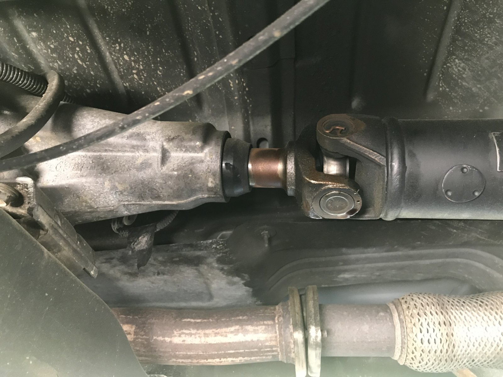

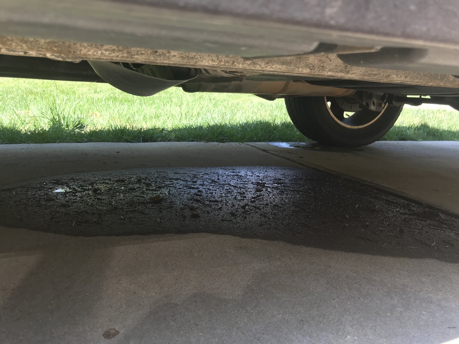

My RWD 2008 Yukon has been sitting in the driveway for a couple weeks now because of the work at home thing. I haven't used it at all in that time and yesterday I noticed a big wet area under the vehicle.
The driveway has a slight incline so the front end of is slightly raised while parked. Looks to be a slow drip from the transmission extension housing. I actually replace the transmission extension housing about 2 years ago, which came with a new seal already pressed, so I find it odd it's leaking.
I am going to assume this behavior is not normal?
Maybe just replace it with a new one because maybe the one I got was bad? Suggestions?
Is there an online parts catalog where I can confirm the part number?
Thanks.

Pics of the "big" area would help. May have a yoke problem as well so check for that when you slide it out. Sounds like the incline and the long sit contributed to this since you never noticed a leak before. You can just top off fluid and drive it and keep watch to see what happens. Can you park on a level surface anywhere close?

the thread title is 'wet concrete, am i to assume it is a "grey muck" as opposed to an oil leak? you dont drive it through those bullshite auto washes that blast the under carriage with water do you? it is a longshot but liquid grey concrete is not oil its corrosion? and the vibration that started with the slip yoke replacement is likely the yoke/ujoint out of alignment. if you can feel the vibration in the vehicle somthing is getting the crap whooped out of it everytime you maintaine that rpm or "frequency" i balance helocopter main/tail rotors for a living. vibration destroys components.not to freak you out or anything:eek:

Yea, he said a small drip from the transmission tail housing. I ASSUMED red fluid.
52,949
Nobody thought it strange he said “wet concrete”? To me that means water or coolant. Although I guess transmission fluid is wet , when I see it on concrete I don’t say the concrete is wet. I say there’s trans fluid on the concrete. So what is it @YukonCrazy ? Trans fluid? Water? Dexcool? Oil? This is killin me lol.
