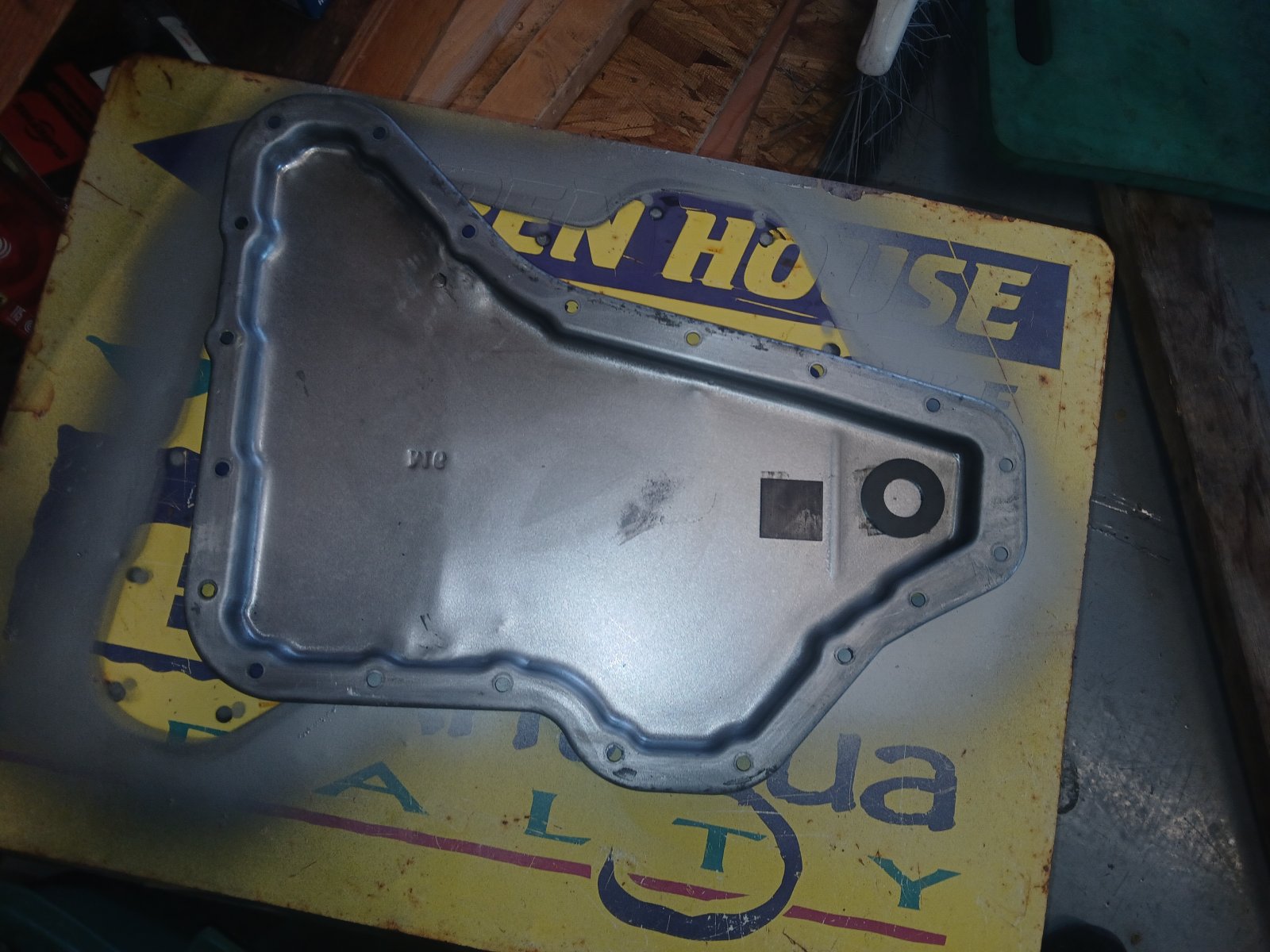

I finally got around to dropping the pan. INSANE, I've never seen a pan so clean as that. The magnet had little of nothing on it. I'm actually impressed with this transmission. I'm at just shy of 220k miles and it looked soooo clean! I even went longer than I should have (100k miles?) between changing the fluid. Although the random shift clunks are annoying.
after brake clean and whipping the magnet. There was a little slime but not much...
For good measure I painted the outside of the pan.. and placed a second magnet... The original magnet wasn't glued or anything. It was just placed on inside the pan. So I did the same with the additional magnet, making sure it wasn't in a place that wouldn't impede the filter.
