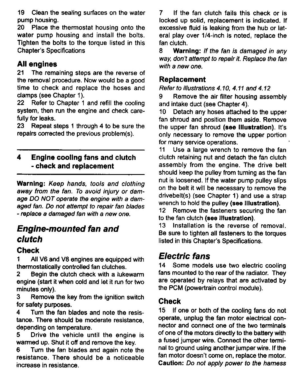

Haynes has a test to determine if the fan clutch is engaging. Note that we've heard of aftermarket fan clutches that cause excessive noise/roar so, when replacing, use OE if available. If not available new, a junkyard unit might be a good choice.
