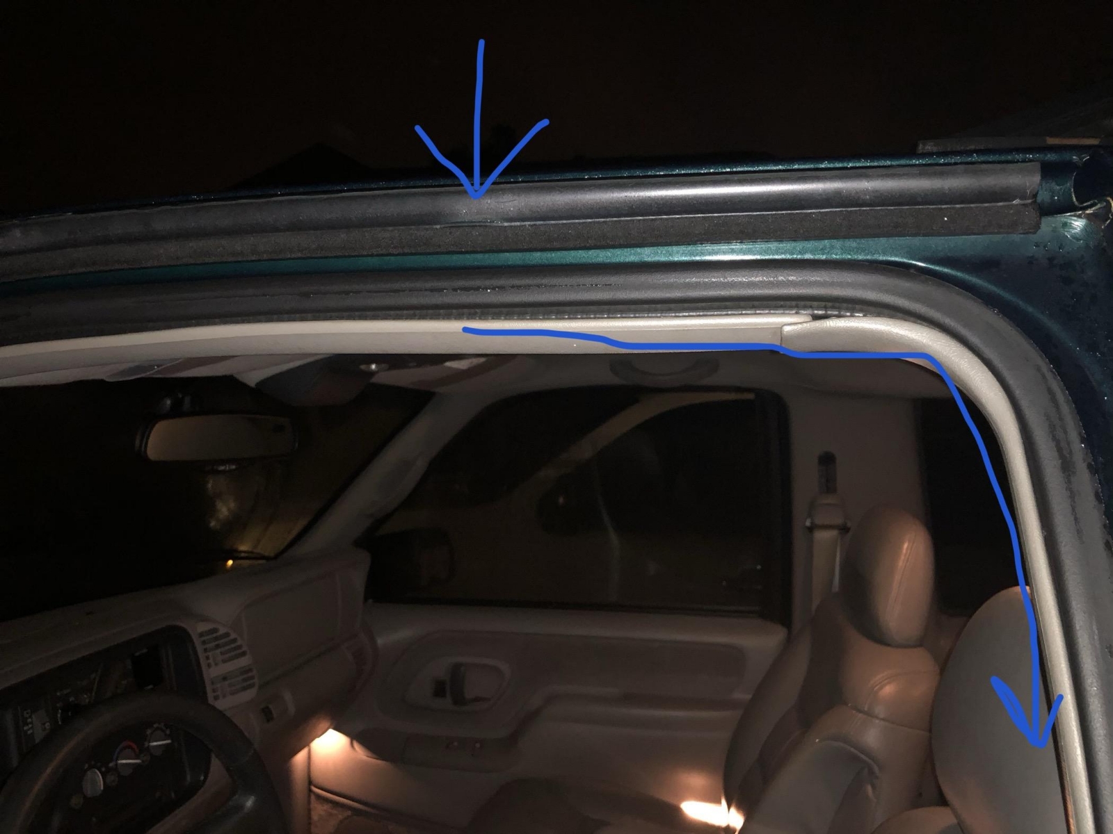

Another thing to check, mine leaks at the top strip and runs down into the sill plate area. Blue arrow at top shows where it comes in...

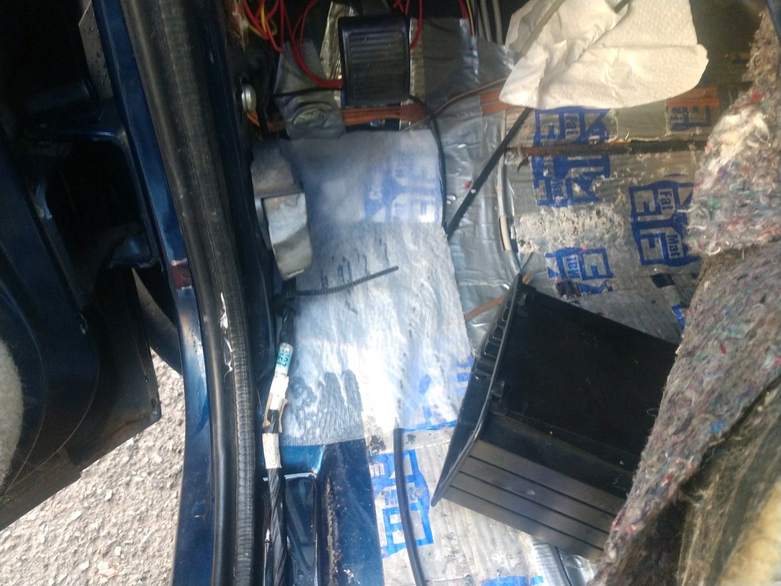

We had some a ton of rain last night and one of the paper towels was wet this morning and a small pool of water was in the rocker sill.
Here are some thoughts...
- This leak has been here a while and I never noticed because of the WeatherTech mats. The amount of water I sucked out of the carpet and padding was way more than the pic. Orders of magnitude more.
- This looks to be an issue with the Driver Door seals in some way.
I'm going to have to sit in the truck and have someone (the kid) spray the truck like crazy and see if we can locate the source.

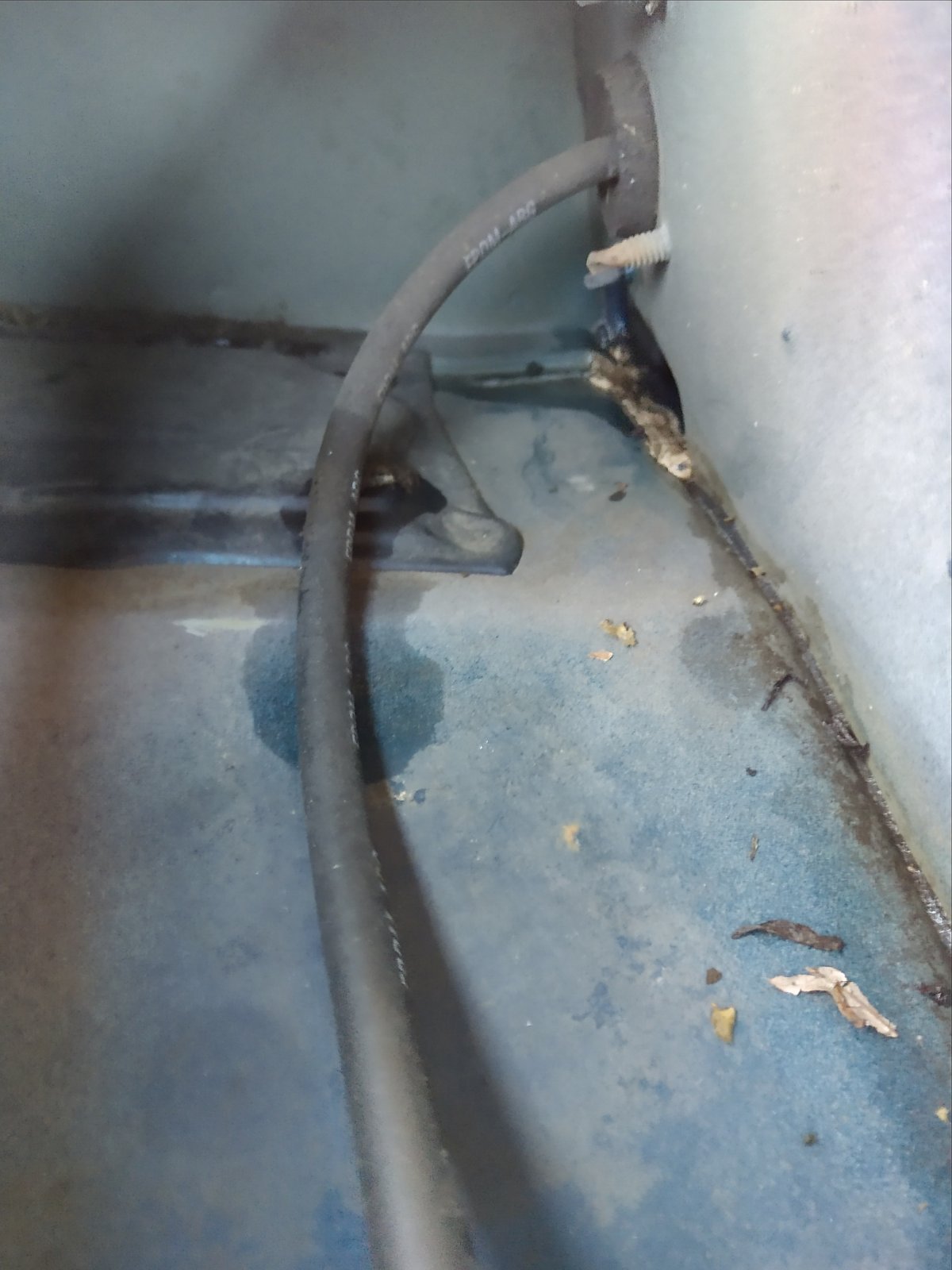

I found where the water it is actually entering the cabin area. It's the Hood Release Cable grommet at the firewall. And it was the tiniest little leak ever in the history of leaks. I soaked the drivers door and windshield for 10min with the hose and only after it sat for a few minutes, did I finally see some water pooling, but not much. I had about a dime sized pool after that. Confirming my thoughts that this leak has been around for a while and I never noticed because of the WeatherTech floormats. Not to mention, my carpet is OEM and has the rubber backing under the carpet, that separates the padding below. Which is where 99% of the water really was. Seems simple right...but no, it's more involved.

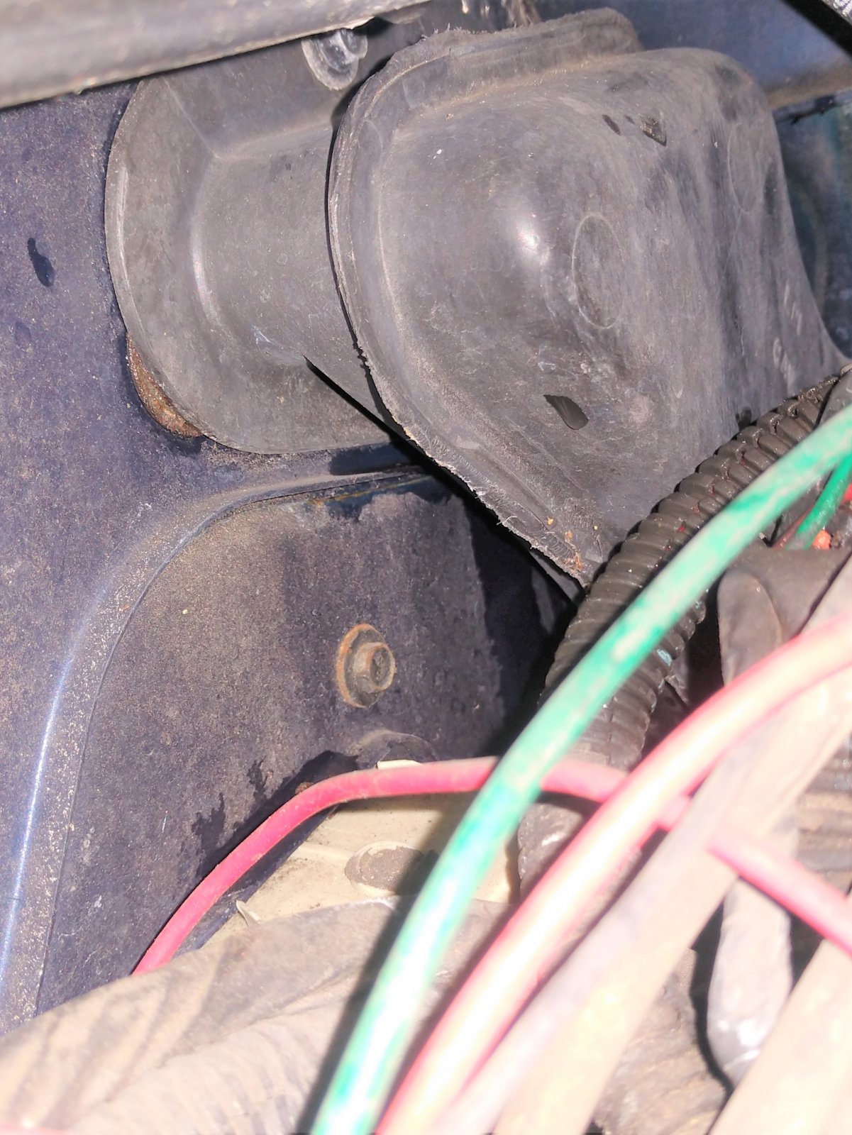

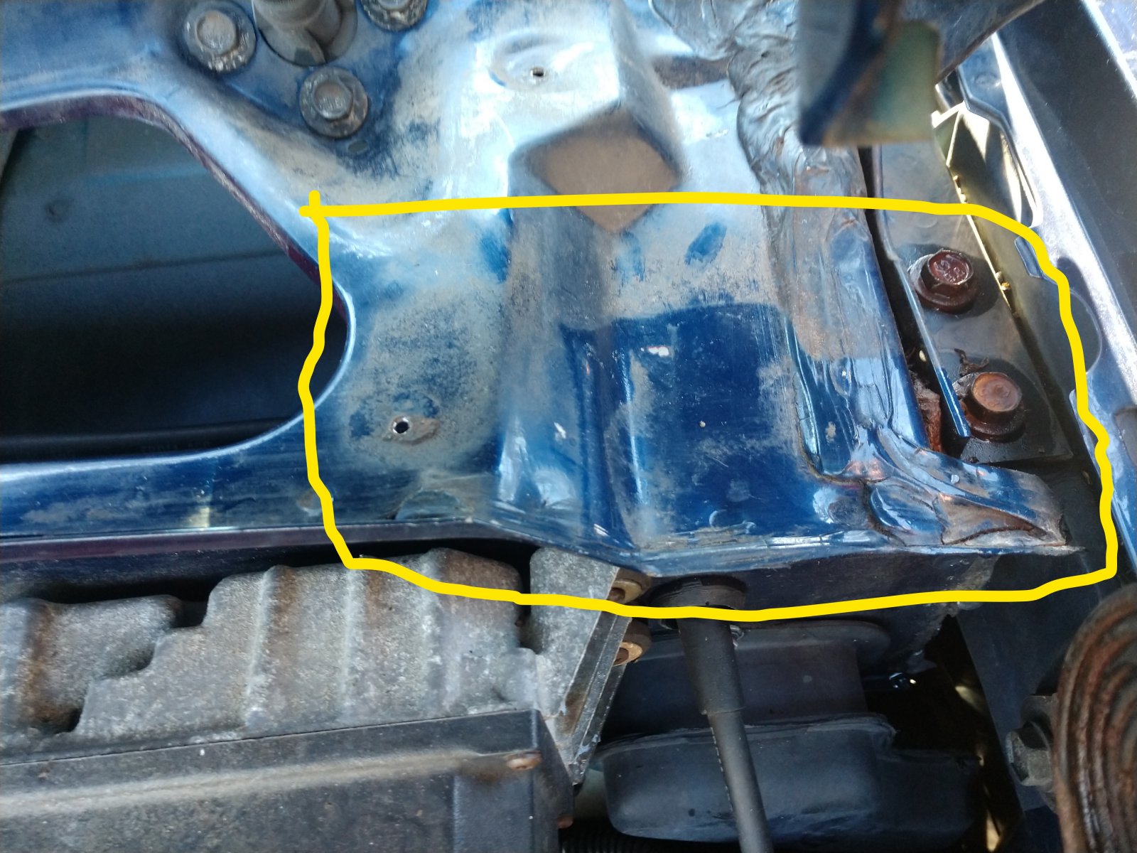

The bigger issue is how the water is getting to the grommet on the firewall. It's a two-parter. The "Cowl Drain" and the "Hood Hinge Seal"(never heard of this before). But mostly the hood hinge seal. The Hood Hinge Seal is mounted to the hood (pic below) it's a rubbery foam mounted to the hood that seals against the cowl/firewall to keep water from entering the engine compartment from up top. This location is directly over the cowl drain and the grommet. The Cowl Drain (the black plastic box thingy) has a seal from the cowl to the firewall, I'm not certain, but it appears to be leaking as well. (So +1 to whoever mentioned the cowl as the culprit, I owe you a Coke!). So between the two seals, I'm confident this is the issue and what needs to be fixed.

Where Hood Hinge Seal mates to Firewall (notice the lack of clean surface, it's not sealing to well)
Cowl Drain
Cowl Drain box thingy/diverter
Hood Release cable groomet (wet)
