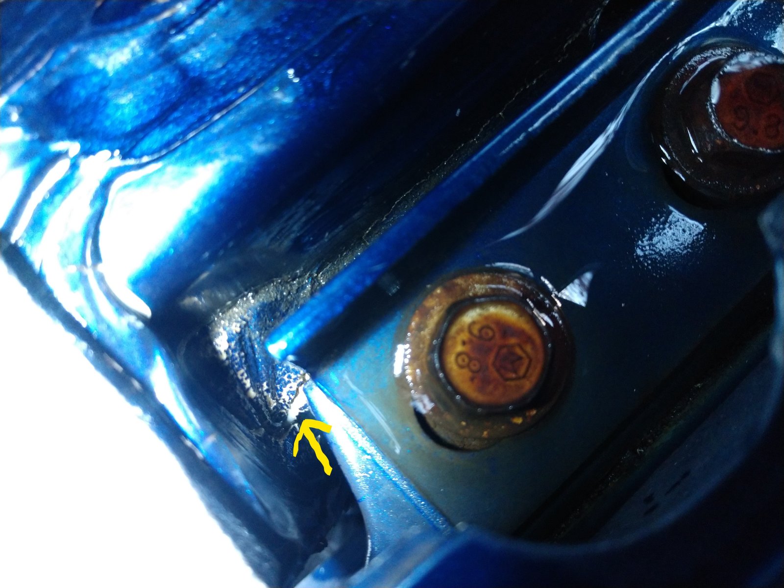

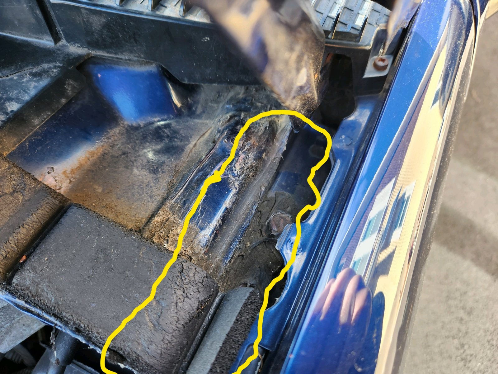

Great you found and fixed your leak. I wouldn't use RTV or anything with silicon. Silicon has a tendency to peel off and nothing will stick where silicon has been. Seam sealer, urethane or drip check sealer work well.

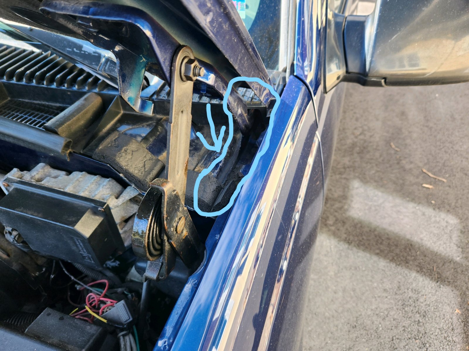

can you post pictures of the area that you are using the sealant on? i know you said near the cowl.. and what all did you have to take off to get to it? was it necessary to take off the fenders.. ?
i have the same thing .. water pooling in the drivers side door sill and then it keeps growing until it gets in the foot well.. i could just do it like a jeep and drill a hole there at the lowest point and let it drain.. haha.. but i would like to fix it.. i cant see where mine is coming in.. but it looks like it could be running down somewhere from the rubber door seal.. as the inside of that is wet.. i pulled it off and looked at it..
@housed
Here ya go. It's by the hinge where the two top bolts are, that hold the fender. In my case the seam sealer had cracked and allowed water coming off the windshield to drain down and enter at the cracked point. You probably don't need to take the fender off, I got lucky that I didn't have to. (Sorry the pic is dirty, been a little cold to a good wash here in NJ)
