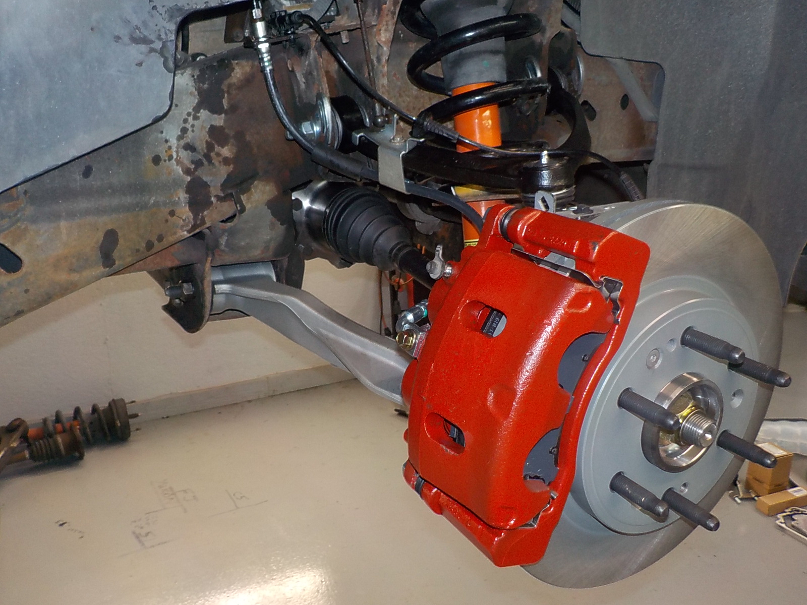

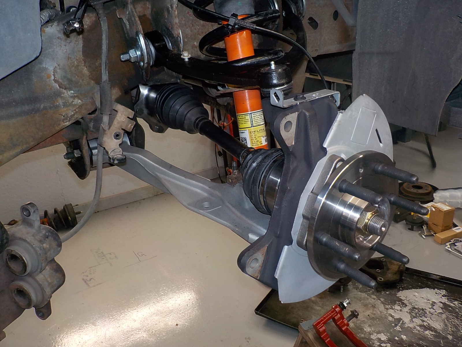

Started tear down to replace:
All 4 control arms w/ball joints, bushings, hardware
CV axles
Bearinghubs and bolts (3)
Innerand outer steering tie rods w/boots
Caster& camber adjusting kits
Rack& pinion bushings and mount
Rotors
calipersw/brackets
brakehoses
pads

07 Denali w/193k miles.
Current tires are 5+ yrs old and 63K+ miles. The ball joits now have a little play in them. This is causing greater tread wear on the inside of these ole tires.
It needs a new set of tires, so I'm fixing the front end first.

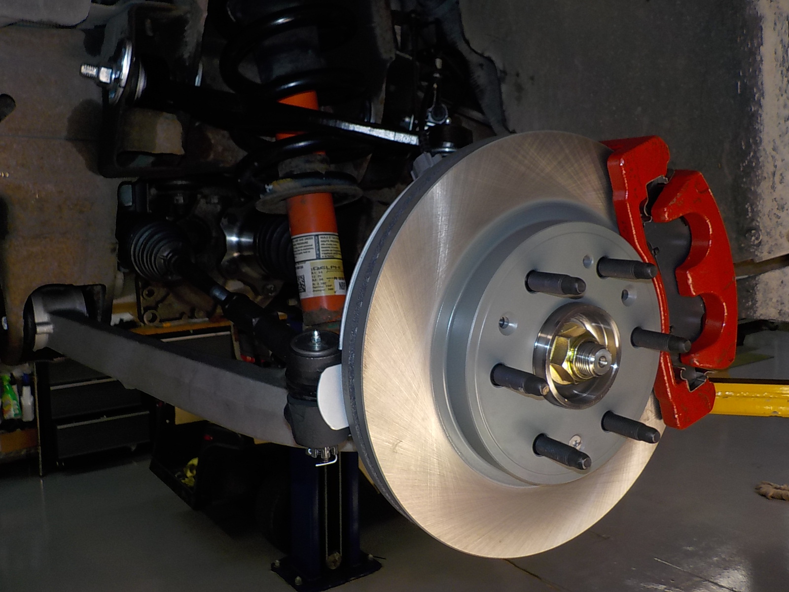

I've been driving it for a couple of days now and everything is good.
Ole front brake pads were near minimum meat left. Upper ball joints were a little loose. Tires are at minimum tread 4/32s after 5+yrs and 63+k miles, and showing more wear on the inner tread.
I set the camber at +.5*degree, and toe 1/16th" in.
