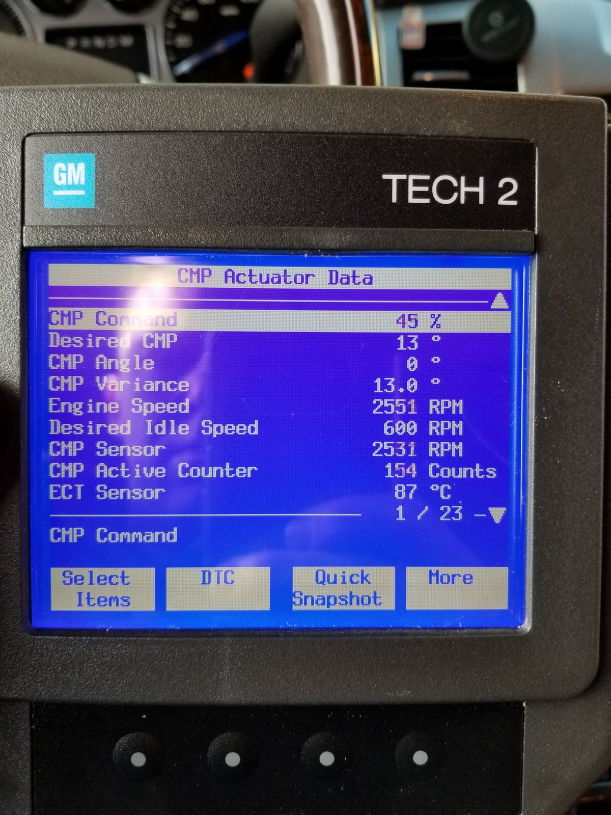

Looks like it's definitely broke. Got my Tech 2 in the mail today and this is what I found.

So the magnet that actual changes the cam timing is bad? Wonder if that's my issue too...o don't have a fancy device to test thou lol

It's gotta be that or the solenoid itself I would think.

I got HP tuners today and the first thing I did was disable the VVT and set the a/c to turn off above 60% throttle. Took it for a test ride and no check engine light. Eventually I'll get to fixing the root problem by putting a different cam in.
