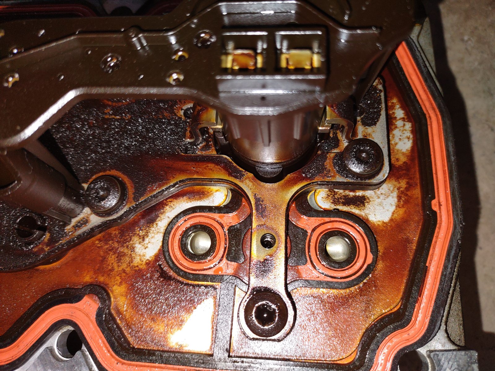

The complexities of the AFM system can easily create oil pressure issues by itself. (Beyond the normal items like the pickup tube o-ring, oil pressure relief valves and such) On your engine valley you have the VLOM plate. To make matters worse, most of the time you will find at least half of the bolts holding it down loose. For some reason GM decided not to use loctite on the bolts. When you look at the underside of that plate, and realize the crazy concoction of routing oil that exists and the many places for it to leak and bleed off pressure.... You will really start to question the wisdom of what engineer designed the thing.
This is the underside of one removed and around 170,000 miles. The clean areas where you can actually still see aluminum are obvious places oil had been spraying out. Although the gasket looks like originally it was some type of rubber, it was very hard and brittle.
Don't forget you also have a metal screen underneath your oil pressure sending unit. It's known to collect crap, preventing the sending unit from receiving the full oil pressure. So for starters you can swap out the sending unit and replace the little screen under it ...see if your oil pressure comes up.

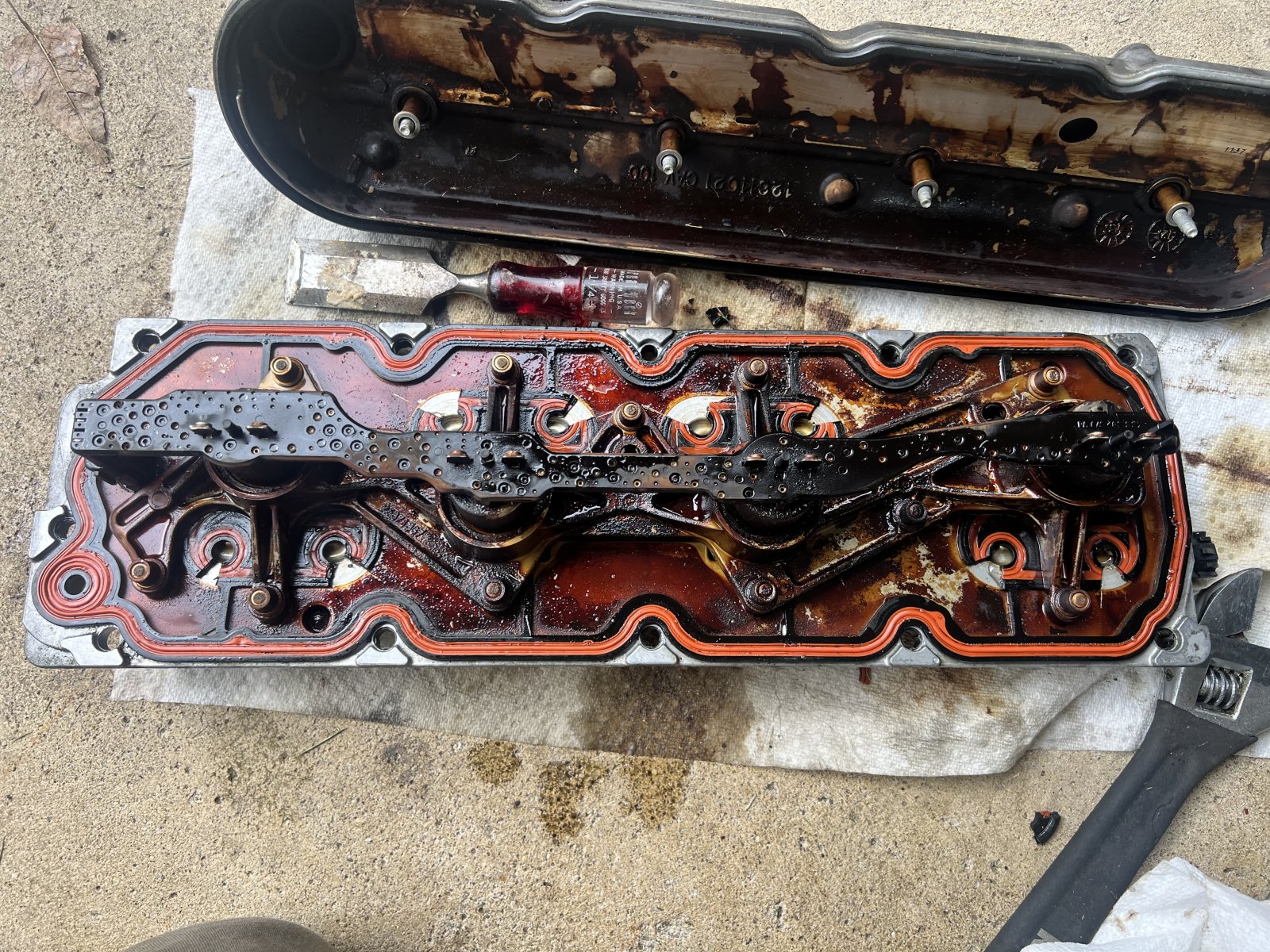

You will want to be 100% sure you don't have an exhaust leak. I guarantee you that many of them sound exactly like a lifter ticking. Make sure all your manifold bolts are in place. A smoke machine does wonders when trying to locate a leak between the head and the exhaust manifold.... Or there's the old school way with that big cigar. (Probably frowned upon by the EPA these days!)
If it's a lifter, doing the delete is pretty much a no-brainer. I can't imagine anyone wanting to spend the money to repair the AFM system, knowing it's reliability is in doubt.

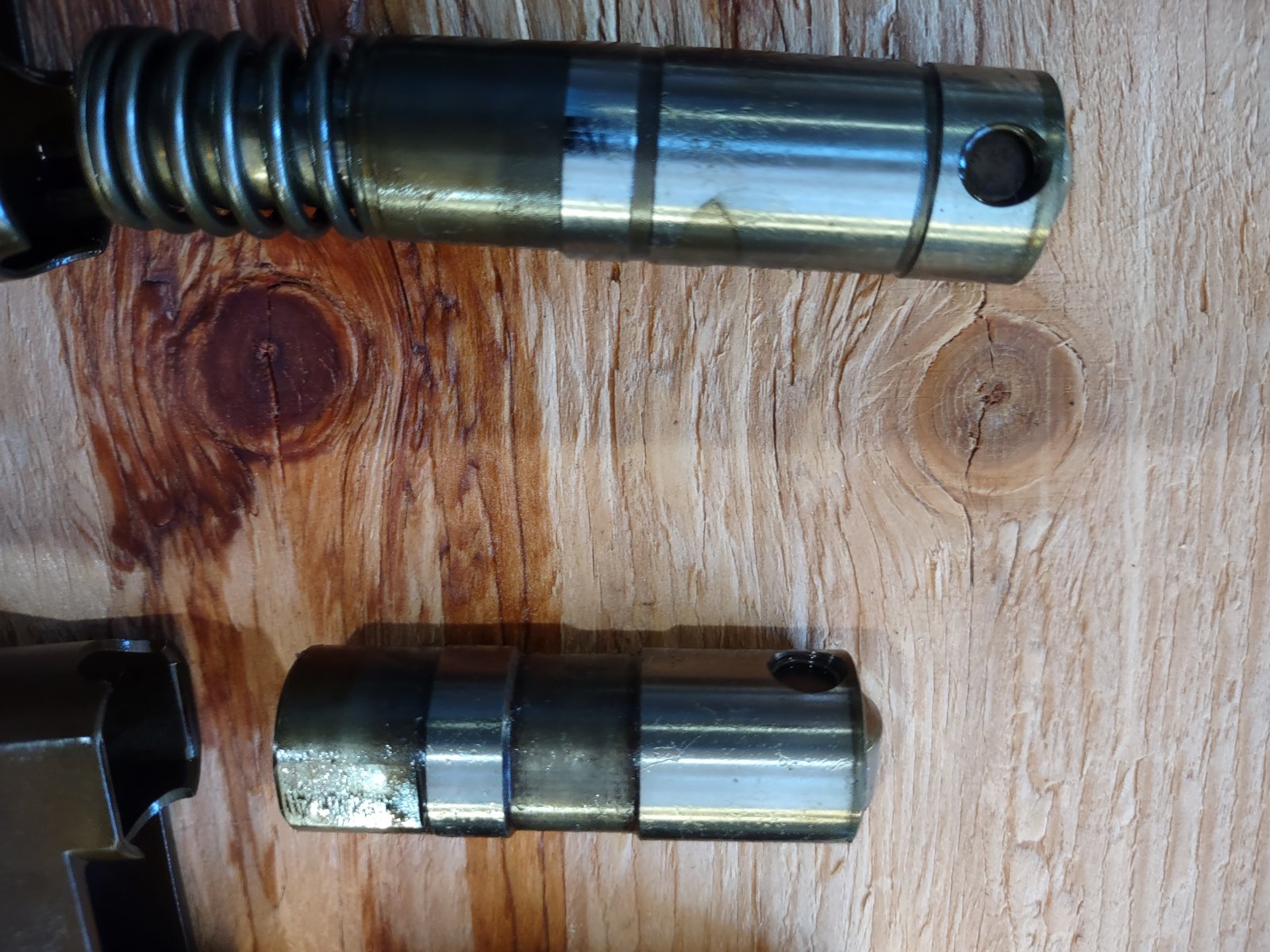

As for the AFM lifters themselves, wait till you see the big spring on the end of it.... And just ponder how long that supposed to last!
Lifter on top is obviously the AFM lifter. The one below is a normal lifter.

I am sadly all too familiar with the VLOM. I cut the gaskets on mine since I had a lifter collapse, and then I took a circular plug and blocked off the passage to the VLOM. Just ends up being a 3x fail safe with the disabler, cut gaskets, and plug. This itself gave me a good 5+ psi...
All from CPR's lifter release kit.
