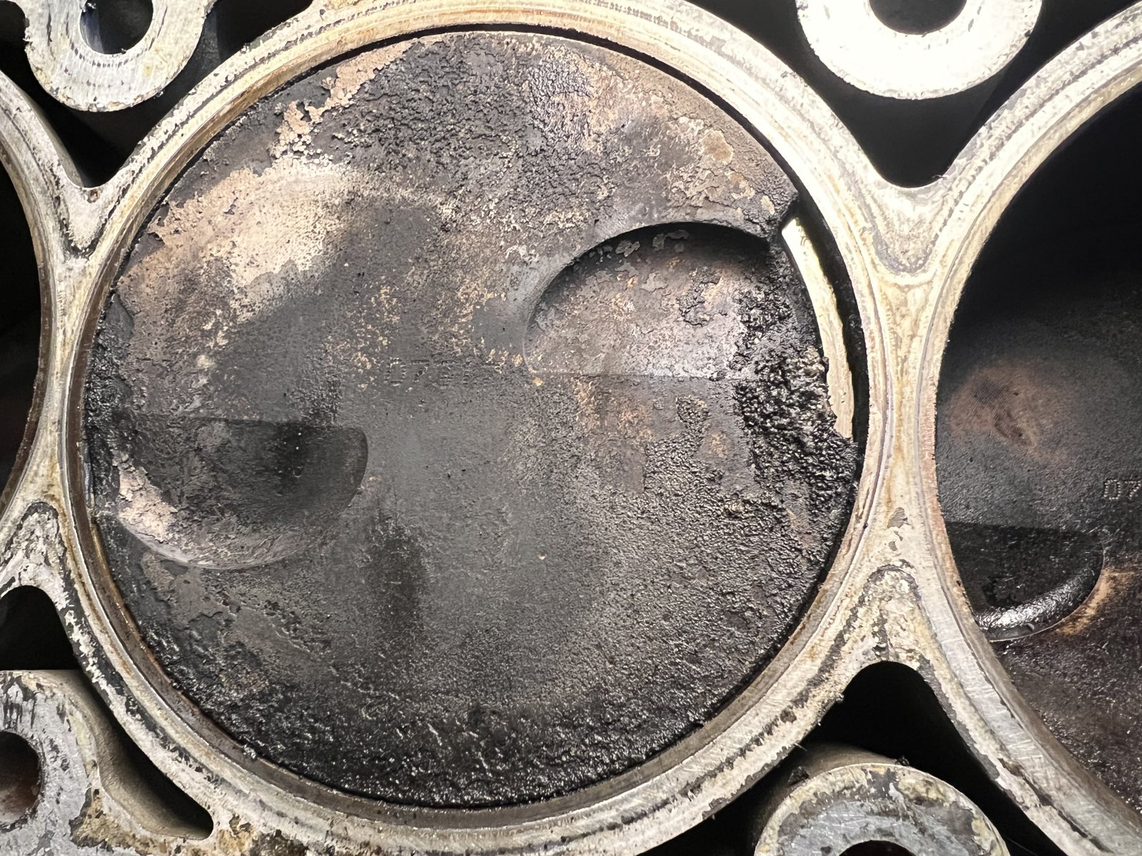

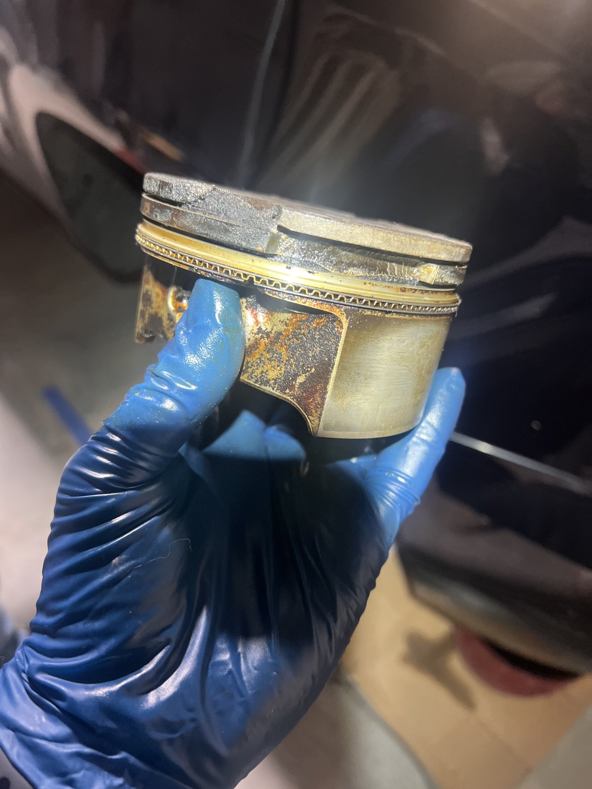

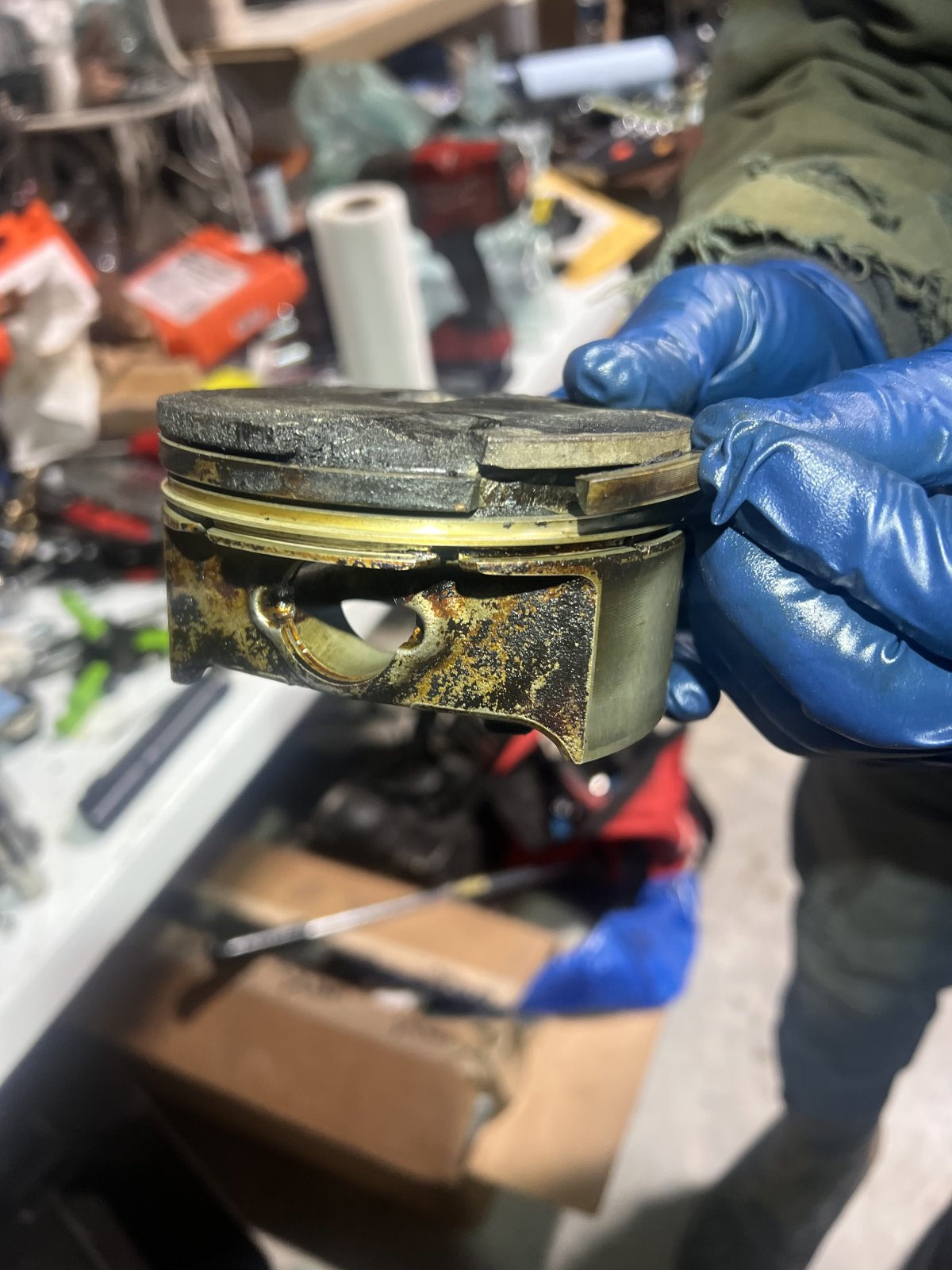

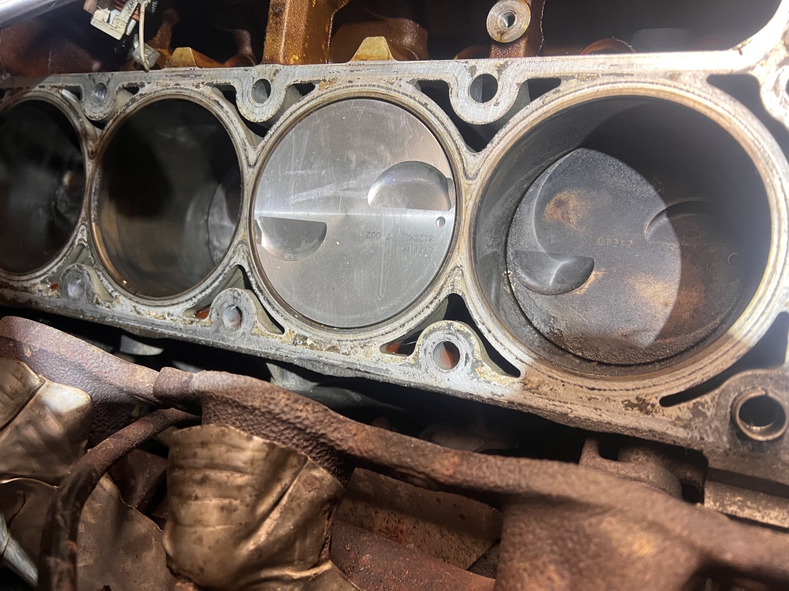

I went ahead and did a DOD delete.. found out my #4 piston was cracked. Not sure if that was my noise or not, but I don't hear a ticking noise anymore. I put a new piston in and have put about 6k miles on it in the past 4 weeks.

I found that crazy crust on my cylinders came from the PCV hose into the intake palenium after I cleaned my cylinders during my delete, soon after the PCV stopped working and I had a big oil burn from the oil. I also had to reseat my head gaskets, seperate issue. So I got back in there. I had to reclean my cylinders and I put a catch can in line. Im sure that the original engineers hated to see oil get fed into the intake and waste the internals. Valve stems take the biggest hit.
