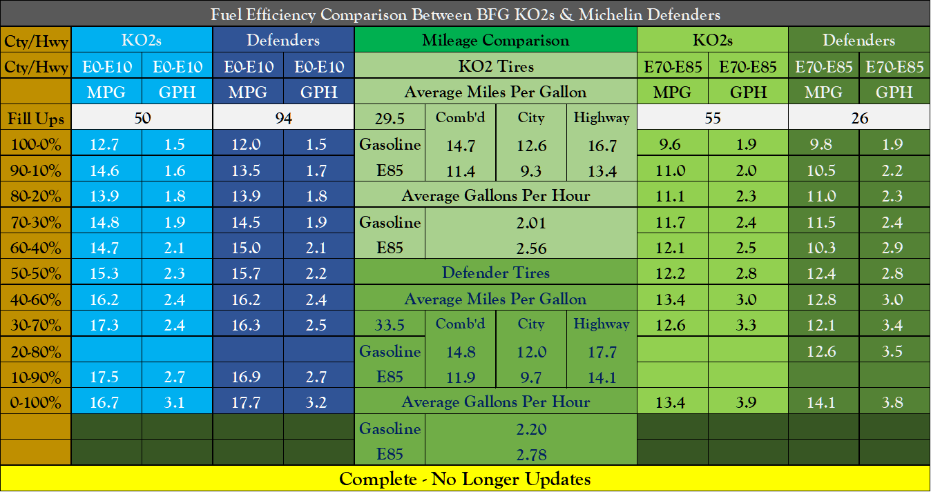

The Yukon XL ran KO2s in load range C shortly after I bought and they lasted 4 1/2 years and just over 50K miles. I made a spreadsheet to compare the mileage between those tires and the Defenders and the data was surprising. The Defenders have gone to most of the places we drove through with the KO2s and never got stuck. The truck coasts for a long time on the Defenders whereas letting off the gas with the KO2s was like deploying the speed brakes or a parachute to slow down. The KO2s picked up road hazards all the time and 3 of the 4 were patched. Defenders are road hazard free. The Sierra had KO2s as well (Load Range E) and the first road hazard to ********* the tread destroyed the tire. Defenders quickly took their place. She got her speed and horsepower back after that. She turns 14s in the 1/4 mile and is bone stock.
What do you think of this chart?
Let me explain the center section to you. The EPA considers 100% city driving to be an average speed of 21.2 mph and 100% highway driving to be an average speed of 48.3 mph. The city and highway averages pulled their data from those 225 fill ups in their respective categories. The Gallons Per Hour averages came from all of the fill ups with those tires on that kind of fuel and it is to be noted that the KO2s were driven at an average speed 4 miles an hour slower than the Defenders which is why the defenders show a higher fuel consumption per hour (29.5 mph vs 33.5 mph).
This does not include the change to 3.73 gears. That's a different spreadsheet!

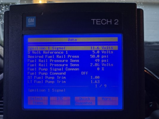

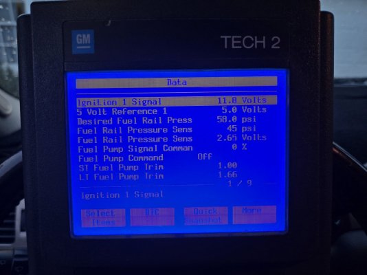

There are regular questions as to what fuel pressure these trucks run at. This post and the one following will show you what the 2008-2014 SUVs with the 5.3 and 6.2 engines run at. I know that the 4.8 and 5.3 2007s are wired differently and do not know about the others like the L76 6.0 engine.
Let's get after it!
Alright, the 2009 Yukon XL hadn't been driven yet, so it was cold iron when these readings were taken:
First photo is Key Off:
Now the Key is On (pressure only went to about 52psi):
Engine Started (Now we know it does not run at 58psi with engine running):
Engine Shut Down, Key Still On:
Key Off and then On Again (sufficient pressure to not prime the rail):
Compare my LT Fuel Pump Trim with your own. There is a separate thread on that topic.
The Yukon has a 5.3 LC9 engine with about 217K on it.
An astute observer will notice that the Yukon's battery was a bit low as I forgot to turn off the headlamps and AC while taking those photos.

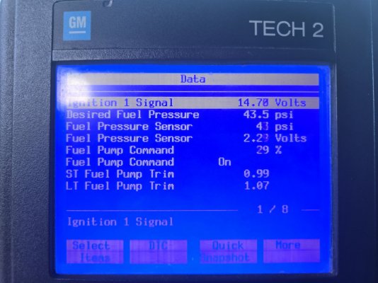

Now, here are the photos of the fuel system for the 2013 GMC Sierra with the bone stock 6.2 L9H. She was also cold and has about 127K on the clock.
Photo Below is Key Off:
Now the Key is On:
Engine Running Now:
Immediately After Engine Shutdown:
Key Cycled Off and On with Engine Off:
The lights and AC were off for these photos.
Next, the duty cycle of the Sierra's pump is less as are the Long Term Fuel Pump Trims. It's obviously a healthier pump. It could also be that those 54lb injectors allow for a lower duty cycle percentage on the 6.2 engine.
