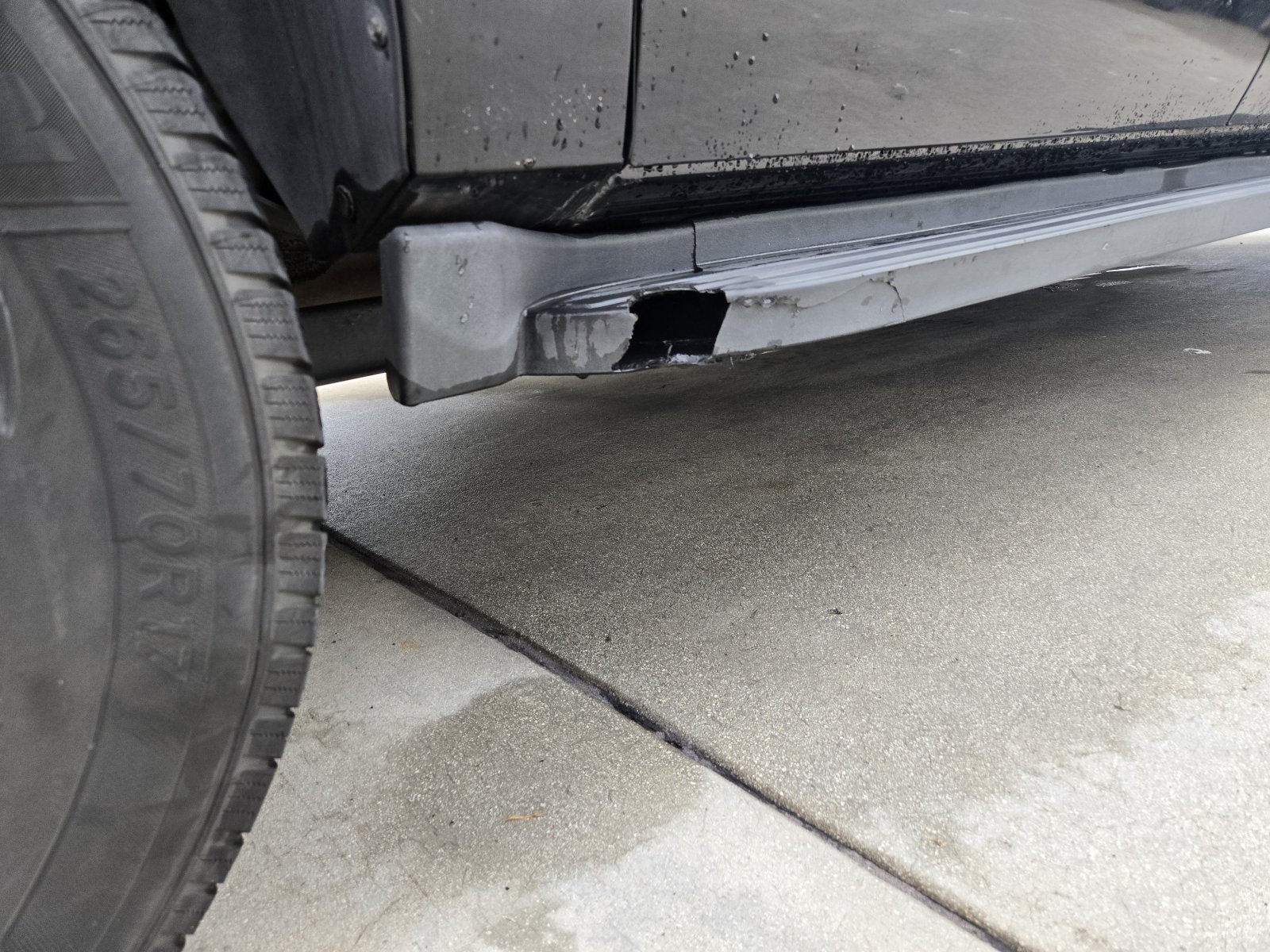

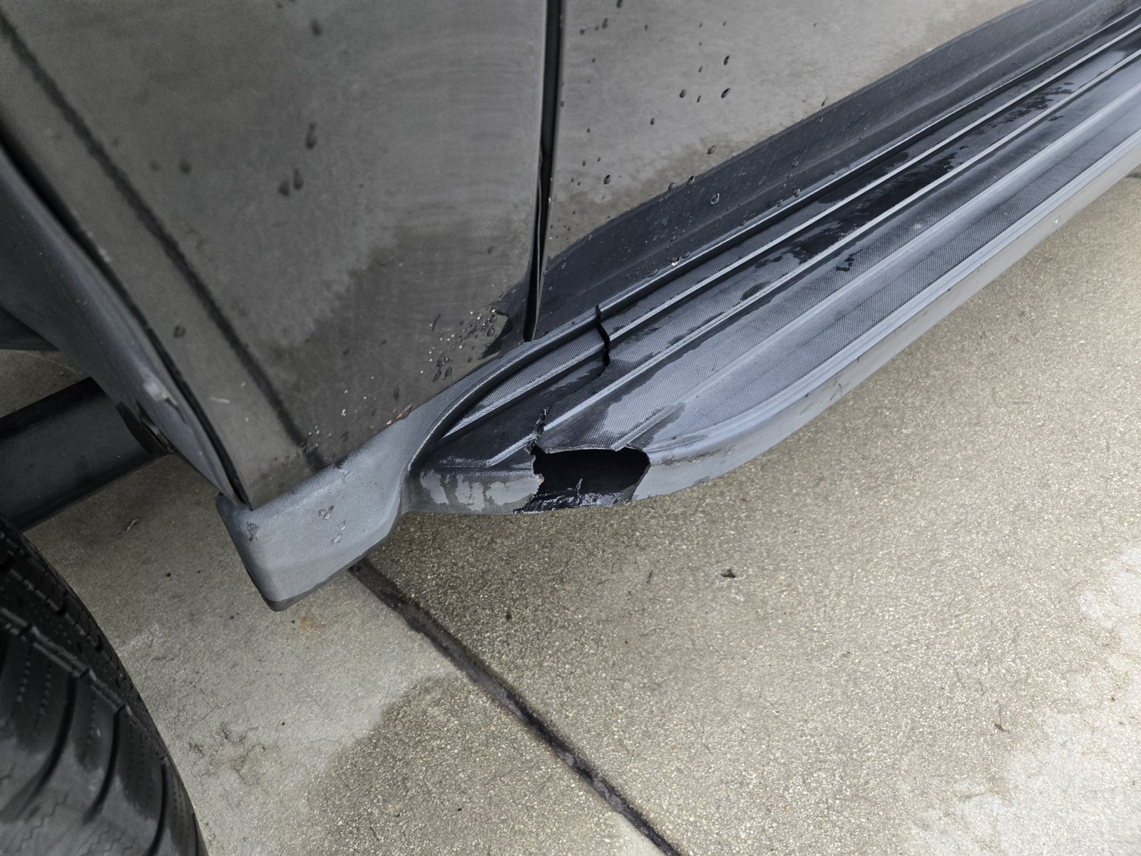

"Hey Dad, come outside and take a look at this", my daughter said!
So, do you think it might be a road hazard or maybe someone hit it in the parking lot? None of us recall jumping or backing into a curb.
The hunt has begun for a replacement...

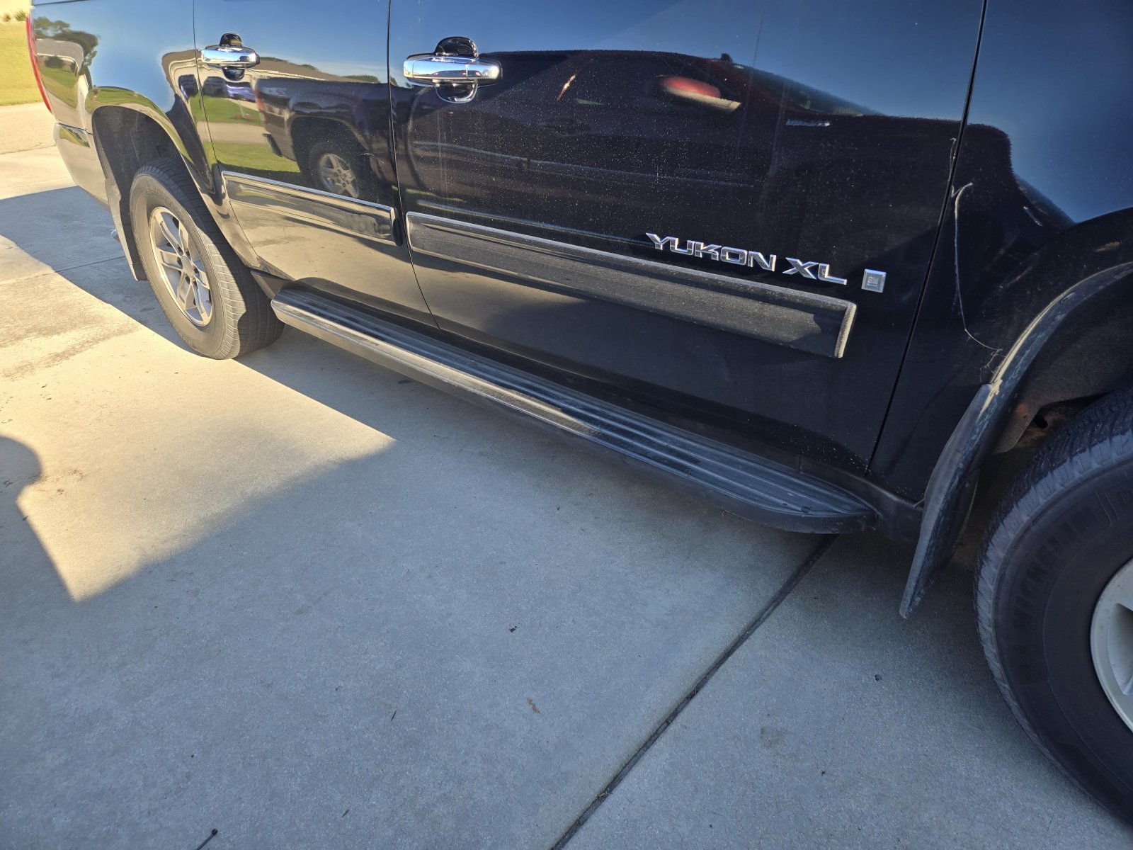

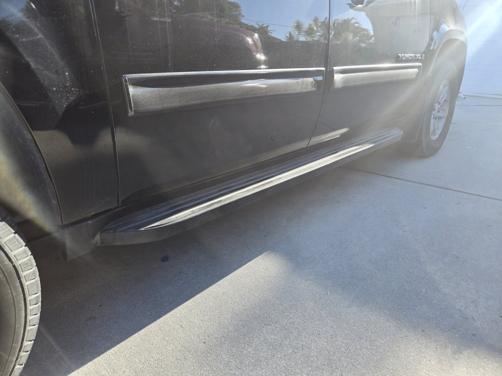

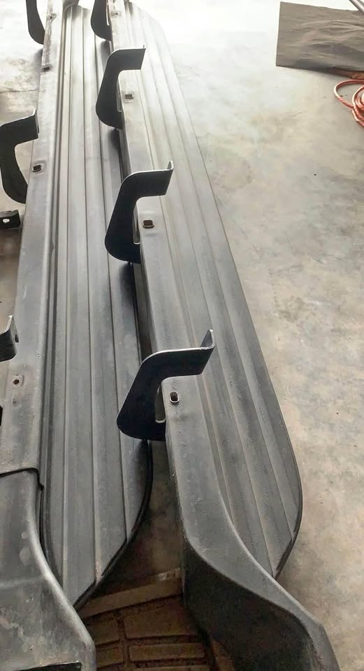

The search took about two weeks. Finally connected with a guy in LaBelle and got them home and switched out the passenger side. Came off a 2008 Yukon XL.
The drive out to LaBelle and back was nice with my bride by my side and we got to have breakfast at our favorite diner in Okeechobee.
2 of the 4 inserts on the old board were broken, the brass threaded insert molded into the board that the bracket bolts to. Not sure if they broke because of my fat butt or from the impact.
Truck is filthy, she was out on the country roads in 4Hi and 4Lo the other day, giving my city slicker nephew some seat time since he got his shiny new learner's permit.
I did not know that GM offered the 5" nerf bars as an accessory. The brackets between our truck and the pickups have different part numbers, the boards appear to be the same. I saw plenty of those for sale and considered them but could not determine whether they would fit or not. It's too hot for me to swap boards from my Sierra to the Yukon and back right now. As it was, I had to have my helper come over for dinner and swap the old one out.

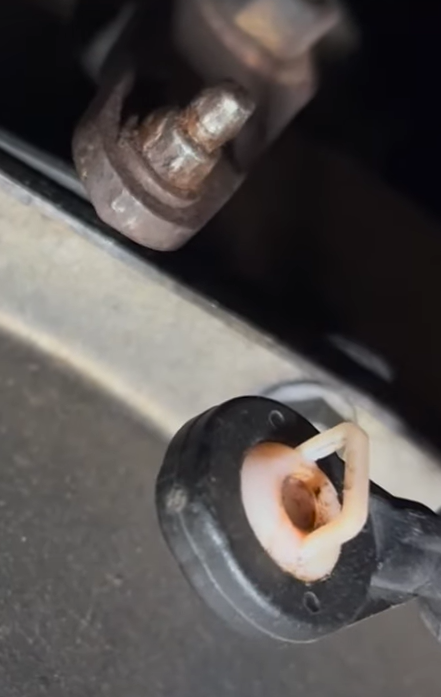

Wife and Granny went out to the country butcher to pick up our supply of beef and chicken and when she got back into the truck the shifter did nothing.
Sent a helper over who put the cable back on the lever on the side of the transmission and she was able to back out and drive home. A few minutes later, one of the Dorman 14092s was softened up in hot water and then snapped into the hole and the truck was shifting fine again.
Well, we got lucky, had checked it a few months ago and all was well. A piece of it had broken off. It lasted 5,825 days and 216,367 miles!
Mine popped off at 221,401 miles.
I didn't need hot water to get the 14092 bushing installed on mine. My bushing end wasn't ovaled out or anything.
Bushings felt pliable in hand, perhaps my ambient temps were higher idk.
Mine looked just like your video. Now to see how long this dorman can last..
Mountie's first video showed a failed dorman apparently, but looking at that shifter pin (1:40), it could be worn.
Maybe grease obscuring the pin, but if it's worn out, that could explain why some people had bad luck with the dorman bushing.
Also, his bushing looks deformed, as he said "swollen". Might be something to look for on the dorman as a sign it's starting to go..
