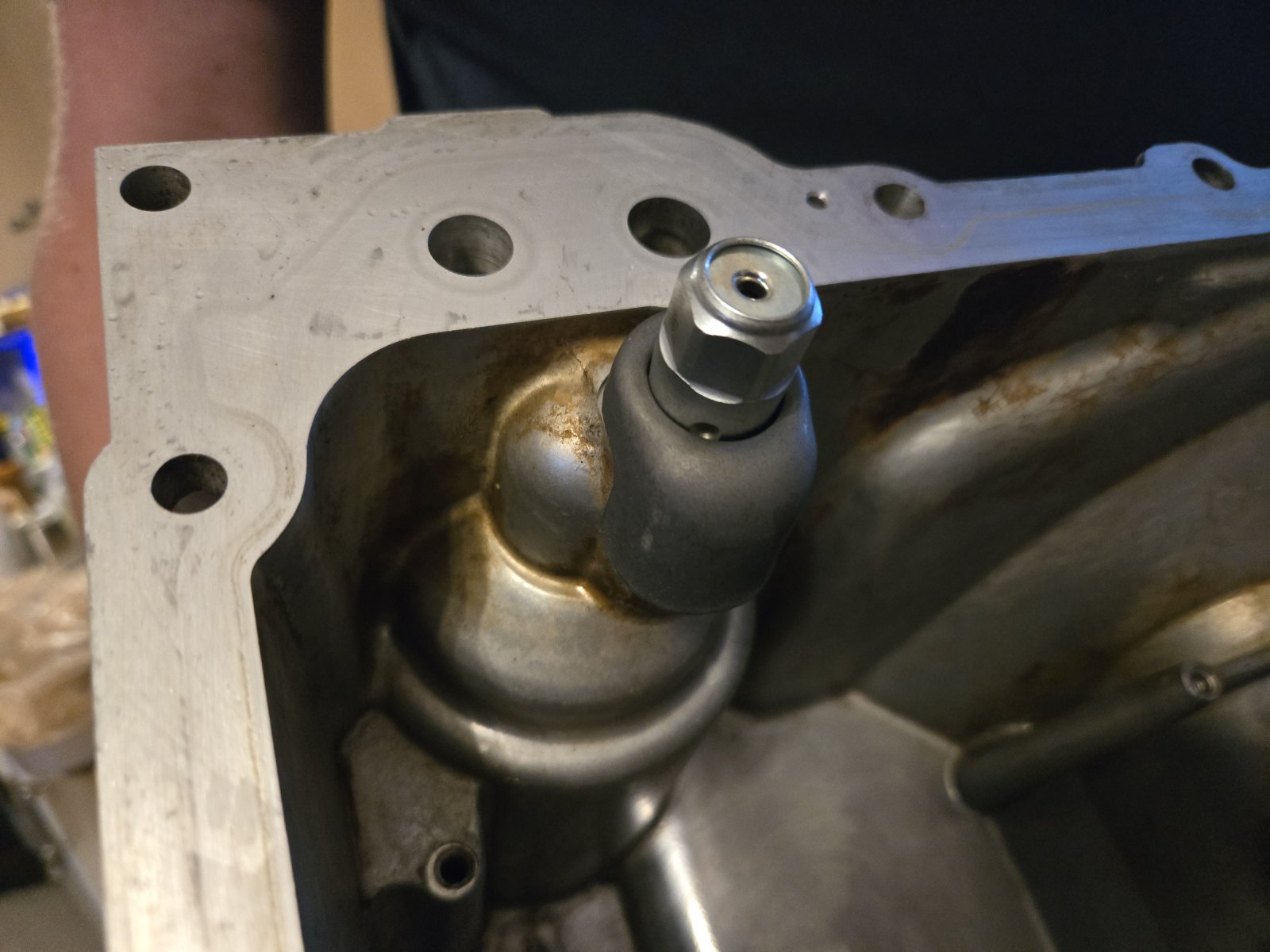

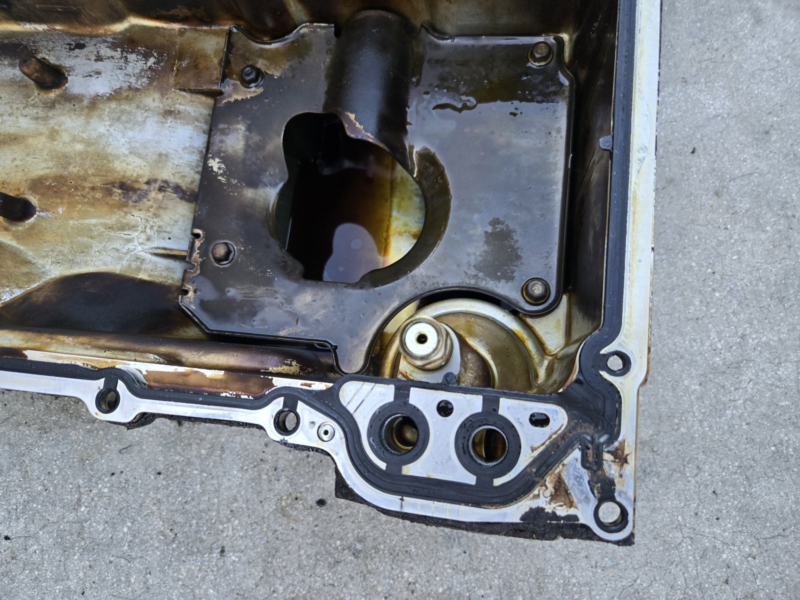

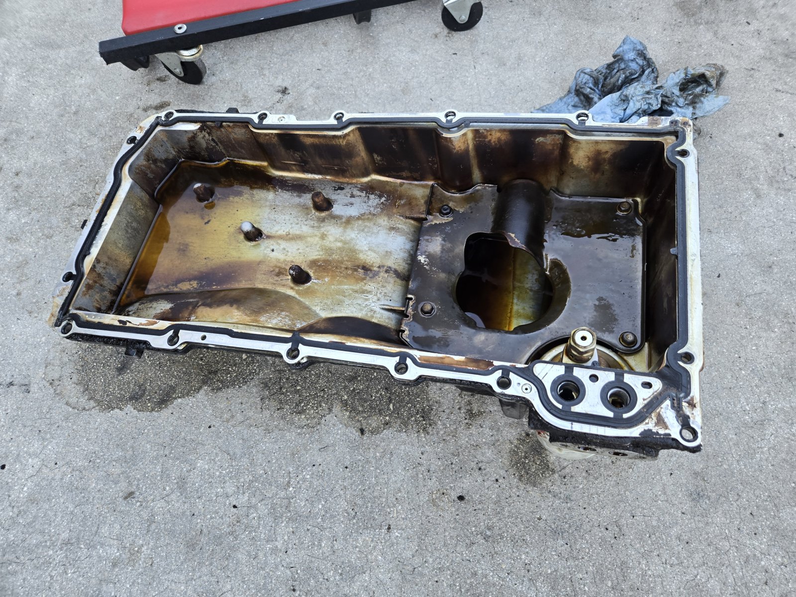

Throughout 2025 the truck began rattling on start up, no oil pressure for the first few seconds and then it came up and the lifters quieted down as they were finally pumped full of oil.
With all the weddings and holidays out of the way my son-in-law finally had time to get after it. He's fast, before I knew it the truck was in the air and the front diff was put in the garage. The next day he dropped the steering rack and pulled the pan. We drilled out the two rivets and he cleaned the pan inside and out, replaced the drain plug, the pressure relief valve and installed the oil deflector. The o-ring broke as it was removed from the tube.
There was an accumulation of gunk near the oil drain that restricted the flow of the old oil from draining from the pan. Those hardened pieces were scraped away. Other than that there was nothing of substance, no timing chain tensioner parts either!
I've only driven her a few miles, the pressures were higher than I remember (not saying much with my memory) especially when cold, but seemed to drop down to just above 20 when hot at a traffic light in gear. No more rattling on start up. Will test that out again tomorrow.\
The last photo shows the relief valve not screwed down yet. It was screwed down so that little hole is now under the shield where it's supposed to be! Both the old and new valves tested out just fine.

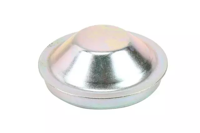

Has anyone's truck come from the factory with these? My pickups have them, the Yukon XL does not.
23203672
These are dust covers that fit on the hub and cover the front spindle nut if you have a 4x4. The new design CV Axles have a dust shield on the other side so that alone ought to extend the life of the hubs. Thoughts?
I bought them for the Yukon last year and keep forgetting to put them in at the next tire rotation.

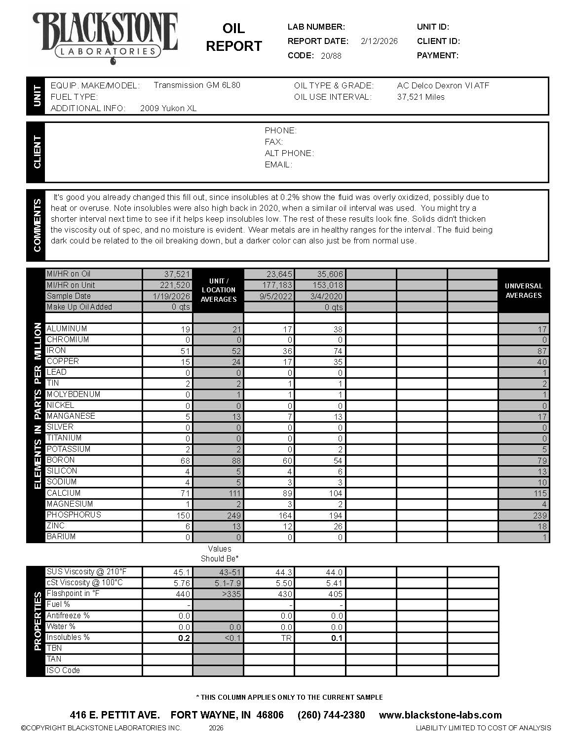

Well, here are the latest test results of the Dexron VI fluid in the 6L80.
The analysis says the fluid is wore out and I had noticed for some time that it was very dark.
A long time ago, the bracket on the transmission dipstick tube separated from the tube and I removed it from the truck. Since then, the dipstick tube flops around and often pulls up when we remove the stick for service. The gasket is still down there but is loose.
I bought a new gasket and have had a new dipstick tube since I bought the truck but have not installed either. We tried about a year ago when the intake was off but that didn't work out. The rear crossmember has to come out and the driveshaft and then the whole assembly allowed to drop low enough to provide enough clearance to install the new tube. I reckon it will stress the motor mounts if not break them if the angle is too much.
Anyhow, it is my belief that the dark fluid and insolubles is because of the loose tube allowing air and maybe even some water to get in there. Air will turn the fluid dark according to the internet.
What say you?

... it is my belief that the dark fluid and insolubles is because of the loose tube allowing air and maybe even some water to get in there. Air will turn the fluid dark ...
This, 100%.
Motor oil is formulated with repeated environmental exposures and combustions in mind, yet it also needs changed out roughly 10x as often as ATF.
To oversimplify, ATF should stay in a well-sealed-off case for 40,000 miles.
