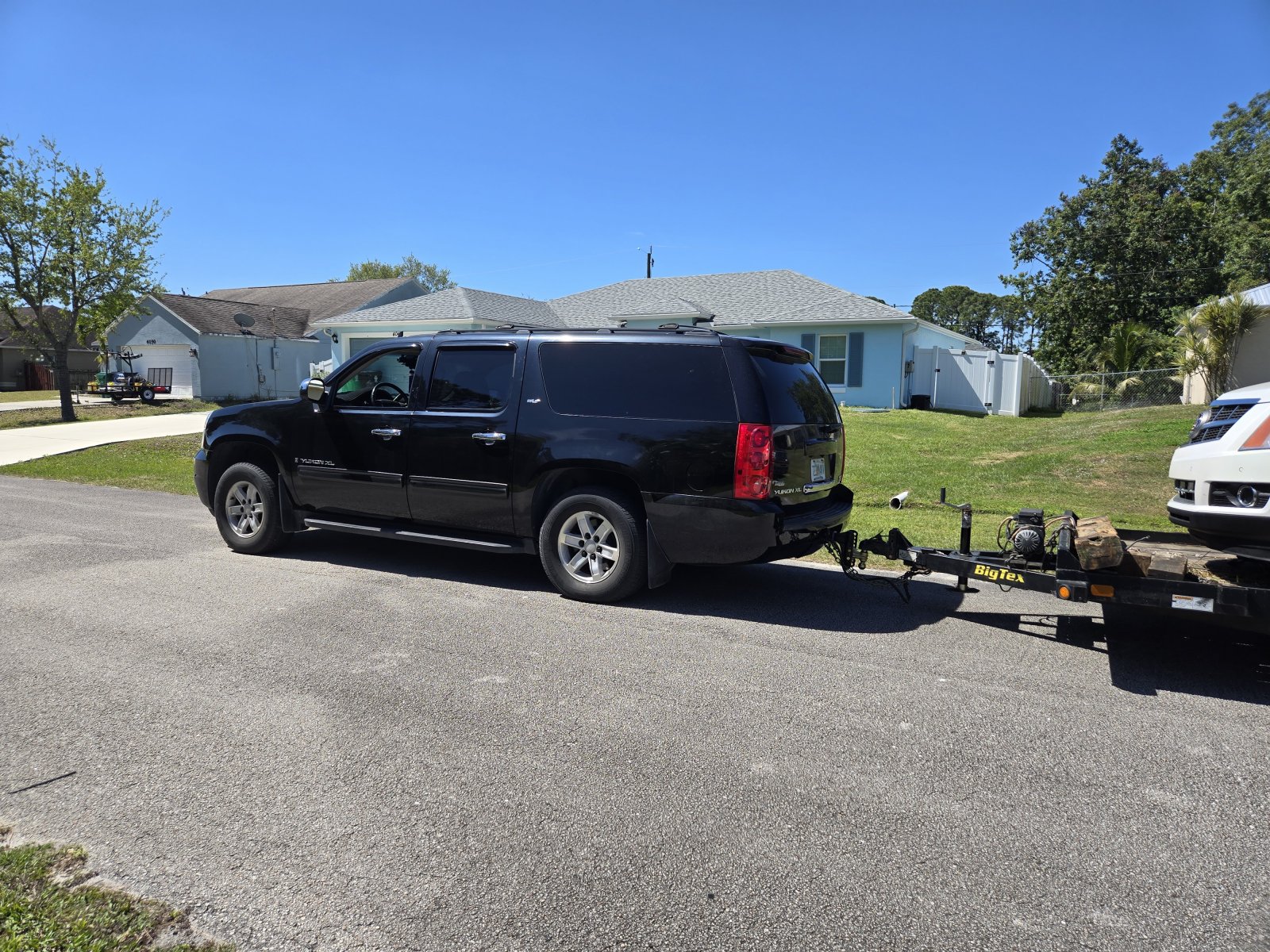

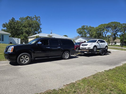

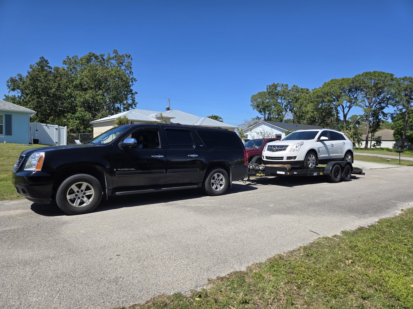

Helped my father-in-law purchase a new vehicle. We thoroughly checked it out and test drove it and then he purchased it; a 2012 Cadillac SRX. The next day the car broke down on the highway. Had it towed to my driveway and the codes referenced the fuel pump computer being bad. Diagnostic testing confirmed the code. Bought one and programmed it, the car still wouldn't start. More diagnostics and it appeared the fuel pump was bad. Ordered one of those too.
Towed the car to the country shop so the work could be done on a lift. Replaced the fuel pump and the car now runs. BUT! The gas gauge doesn't work. Turns out the tank also has another sending unit and that one has to be replaced when you replace the other with the fuel pump. Didn't see that in the shop manual but a youtube video mentioned it. It's now on order but he can drive it while topping it off every 100-150 miles. The code for that didn't come up with the old FPCM in the car but did with the new one even though she ran on the old one. Crazy.
So, that resulted in this tow. Photo shows the car too far forward at first. We pushed it back a couple feet and leveled out the truck. Towed great. transmission never hit 190 over 21 miles.
GCWR was about 13,600 total and the towed weight was about 6,700 pounds.

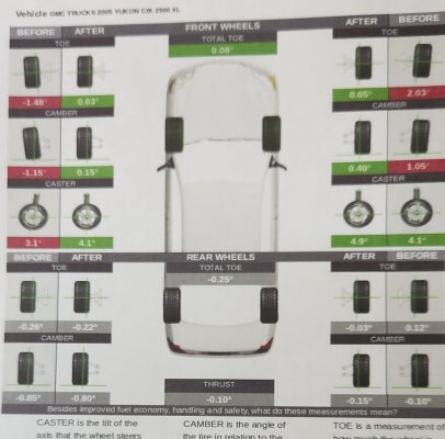

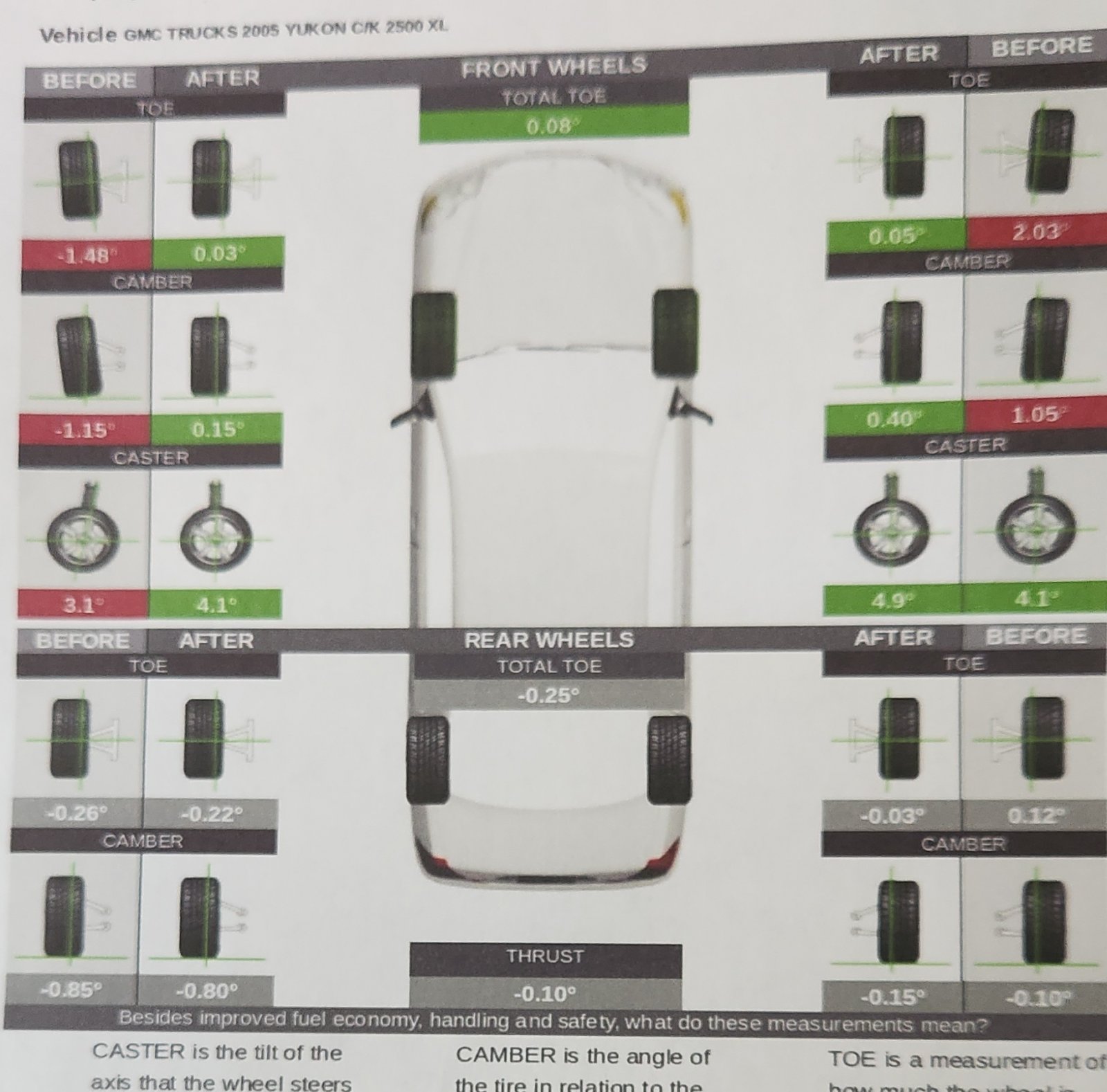

I'm re-posting this from earlier today....
I just had my A-arms /ball joints replaced.... Needed also, my tie-rods replaced....
The shop also did the 4-wheel alignment.
With 180,000 on the clock, my '05 XL feels brand new! ( Check out the alignment sheet )...
( I thought, Swathdiver might like to peek at the numbers......
  • Yukon wheel alignment 3:2025.jpg
