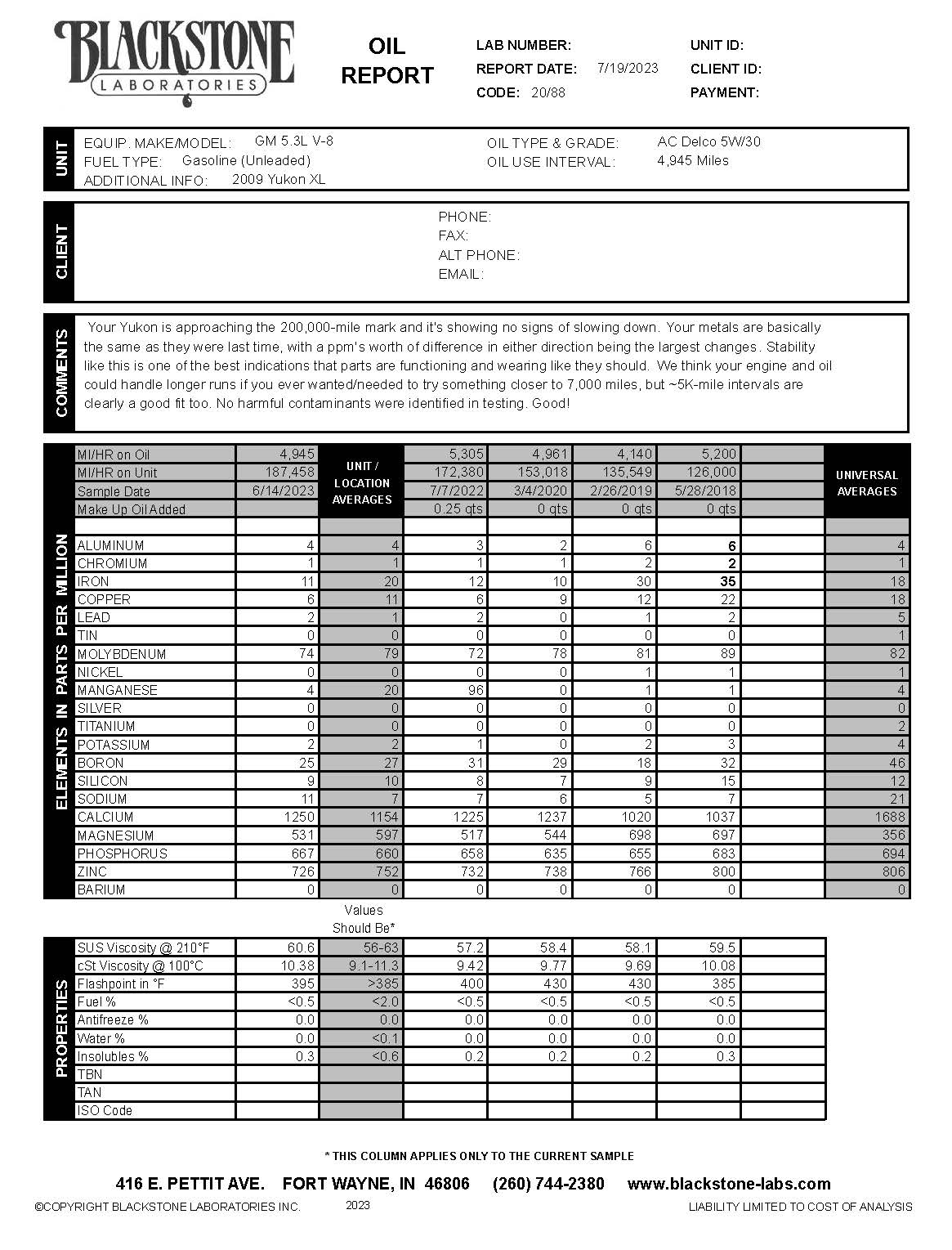

Blackstone Labs report came back for the Yukon today. Now we have 5 samples over 5 years and 60K miles.
I noticed something interesting, a trend if you will. The first two samples were with regular Mobil 1 synthetic oil. In June of 2019 we switched off of that and have been using ACDelco's oil since. You can see a definite drop in metals after the switch.

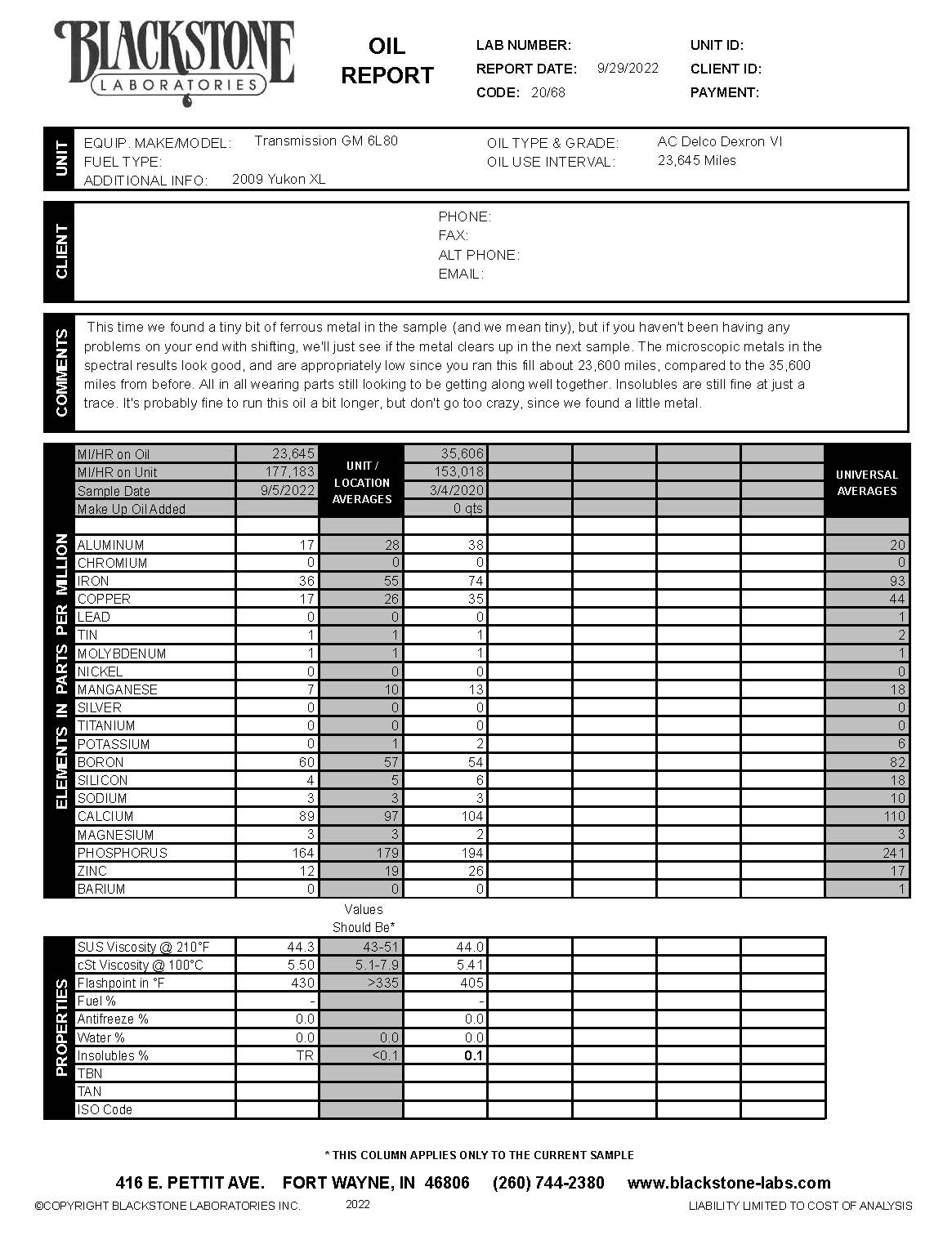

For those interested, the first sample came back for the transmission on the 2013 Sierra. Blackstone's report in a nice way alluded to the transmission oil probably having been changed before, which is great! I've attached the reports from the Yukon's transmission for comparison.

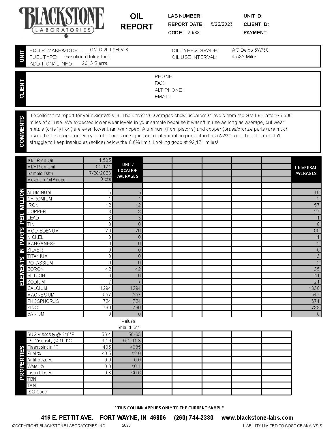

First oil analysis came back for the 2013 6.2 Sierra. This was based on 3 oil changes with ACDelco's 5W30 oil. We are now going to run 3 more oil changes with Quaker State full synthetic and then do another analysis. This oil has similar viscosity numbers as ACDelco but not as high but still higher than Mobil One. The motor does not rattles on start up.
