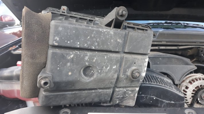

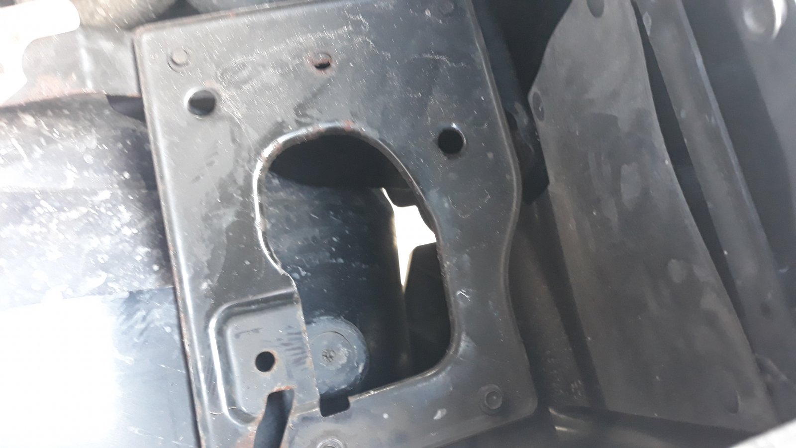

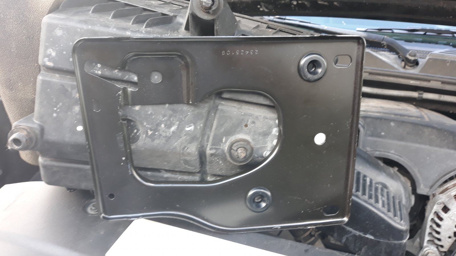

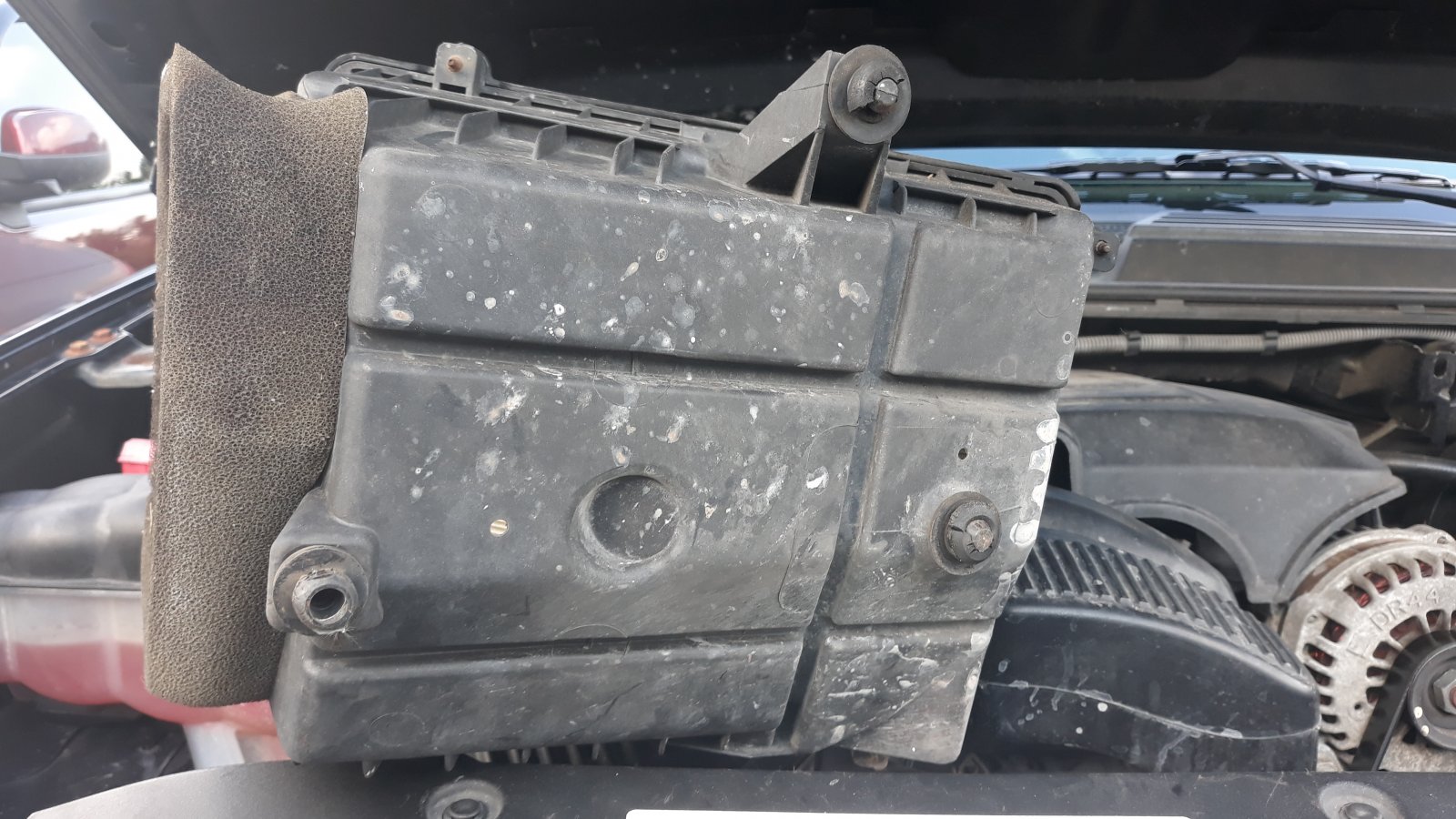

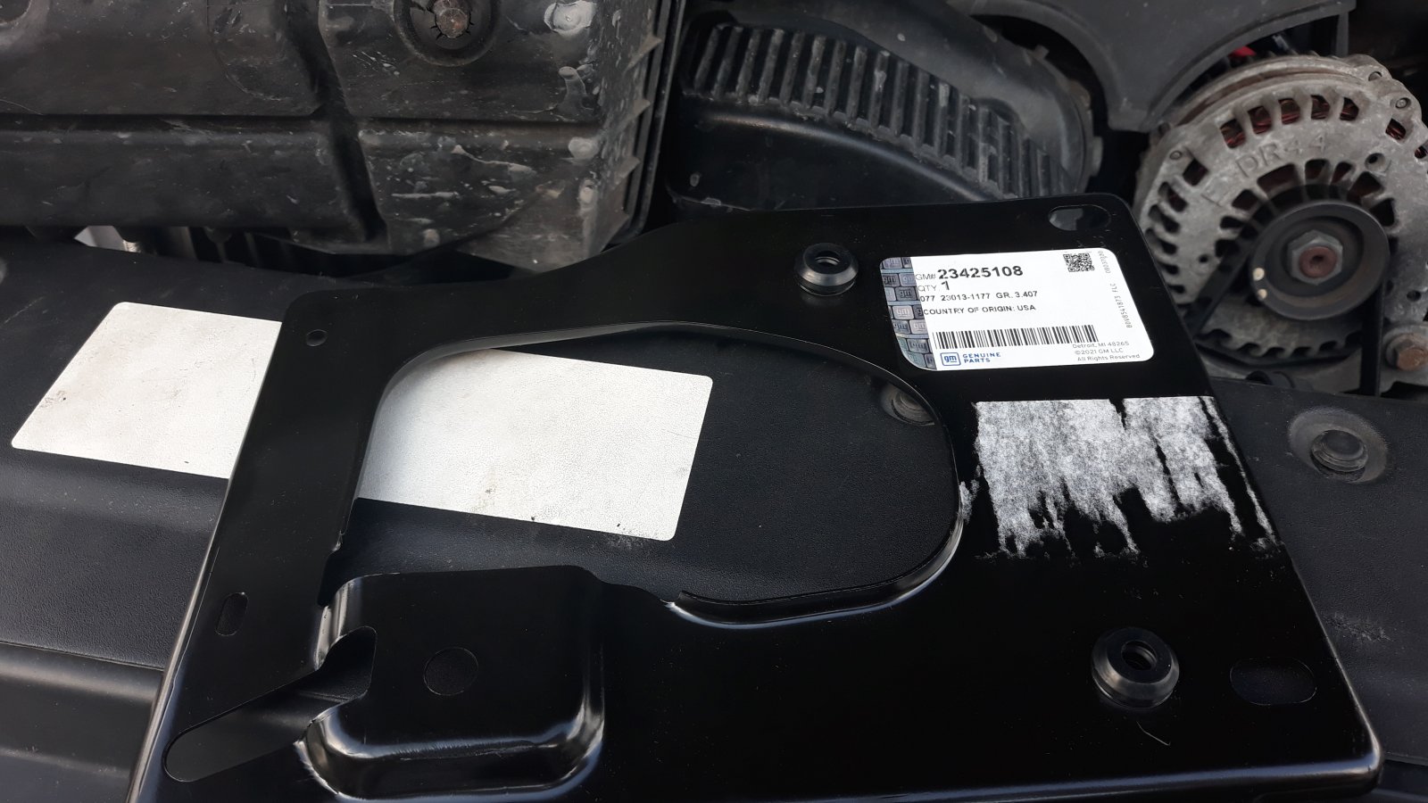

A member whose name is lost to me now showed us how to replace the grommets at the bottom of our airboxes. To do so, we have to purchase a new mounting plate.
GMPartsGiant had them for about $14 so I bought one. The part number is 23425108.

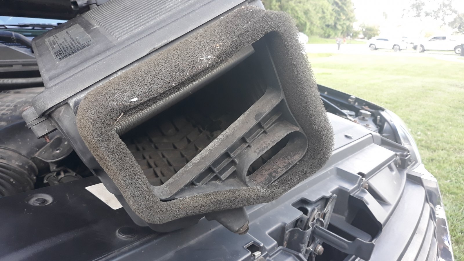

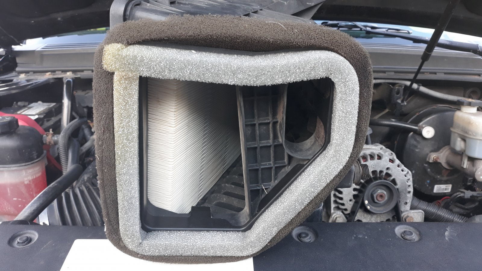

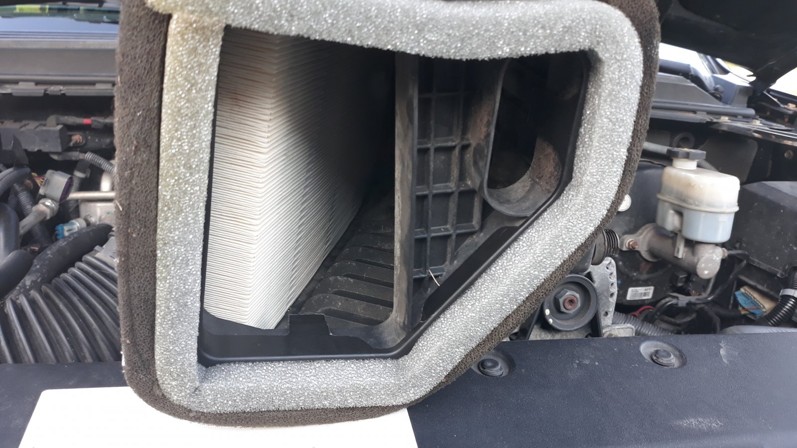

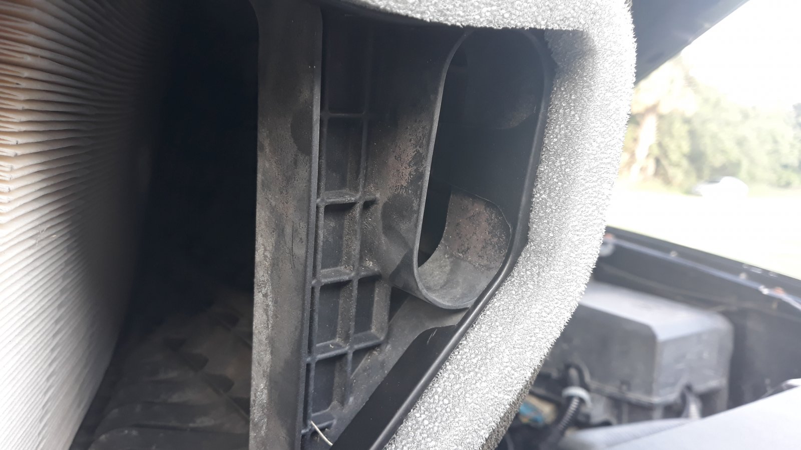

Ok, so the next thing was to put new foam around the airbox to keep hot engine air out as the old foam has seen better days. You keep the original foam and slip this inside of it and it clips in place. Pretty ingenious I thought. The air cleaner seal is part number 22844822 and was also purchased from GMPartsGiant.
