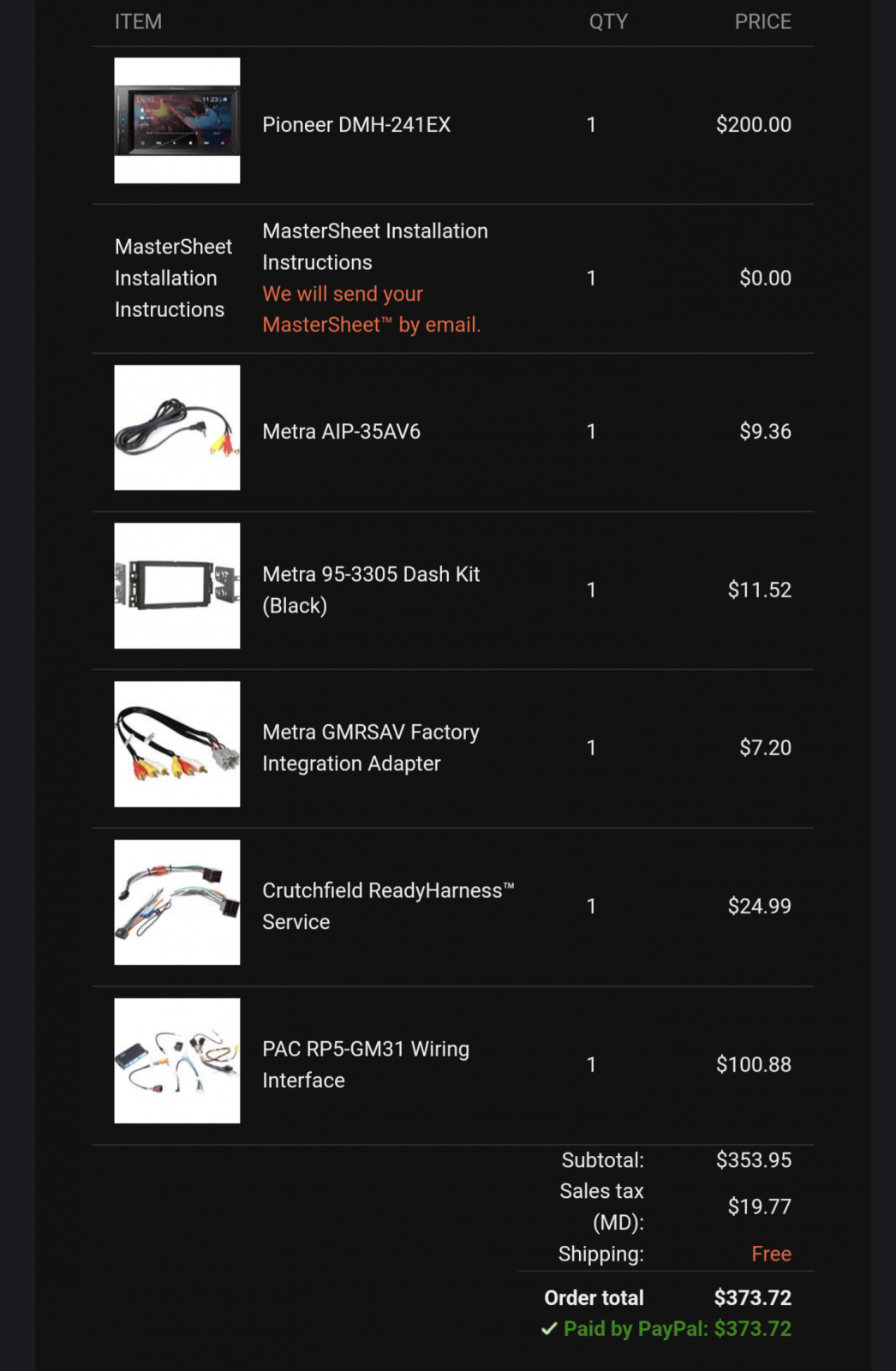

This is the head unit and setup I went with. Looks like I got the pac rp5 you mentioned
I wonder if something isn't connected correctly in this case, because the sound is peculiar
Well, damn. I guess all of PAC's stuff just has a particular sound, and it's lame.
I doubt it. If everything else is working as it should, then it's probably just "that unique PAC sound". :disgust:
I'd say that you probably saved me the hassle of swapping the interface again. But, I'll probably do it anyway since the RP5 has the steering wheel controls built-in and I need the universal Axxess SW-1 for another project. I might look into the Crux. My Tahoe Twin buddy has this and I think his turn signals are factory-like in sound and volume.
