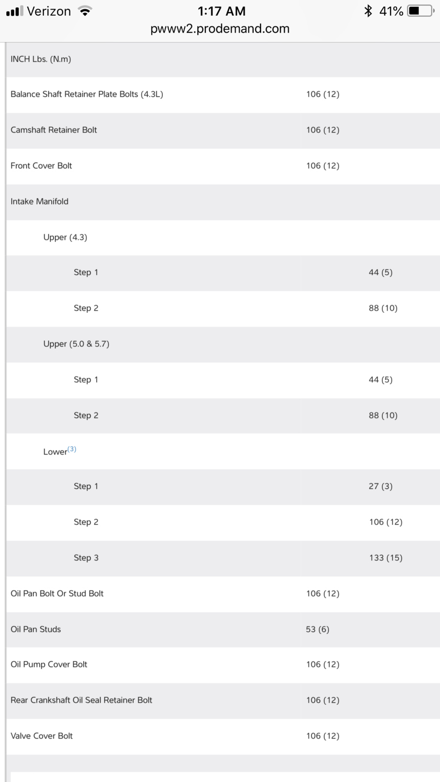

Here’s your torque specs brother
Thanks man, I appreciate it! Gonna be another long weekend. We are down to one vehicle, so need to get this thing up and running.

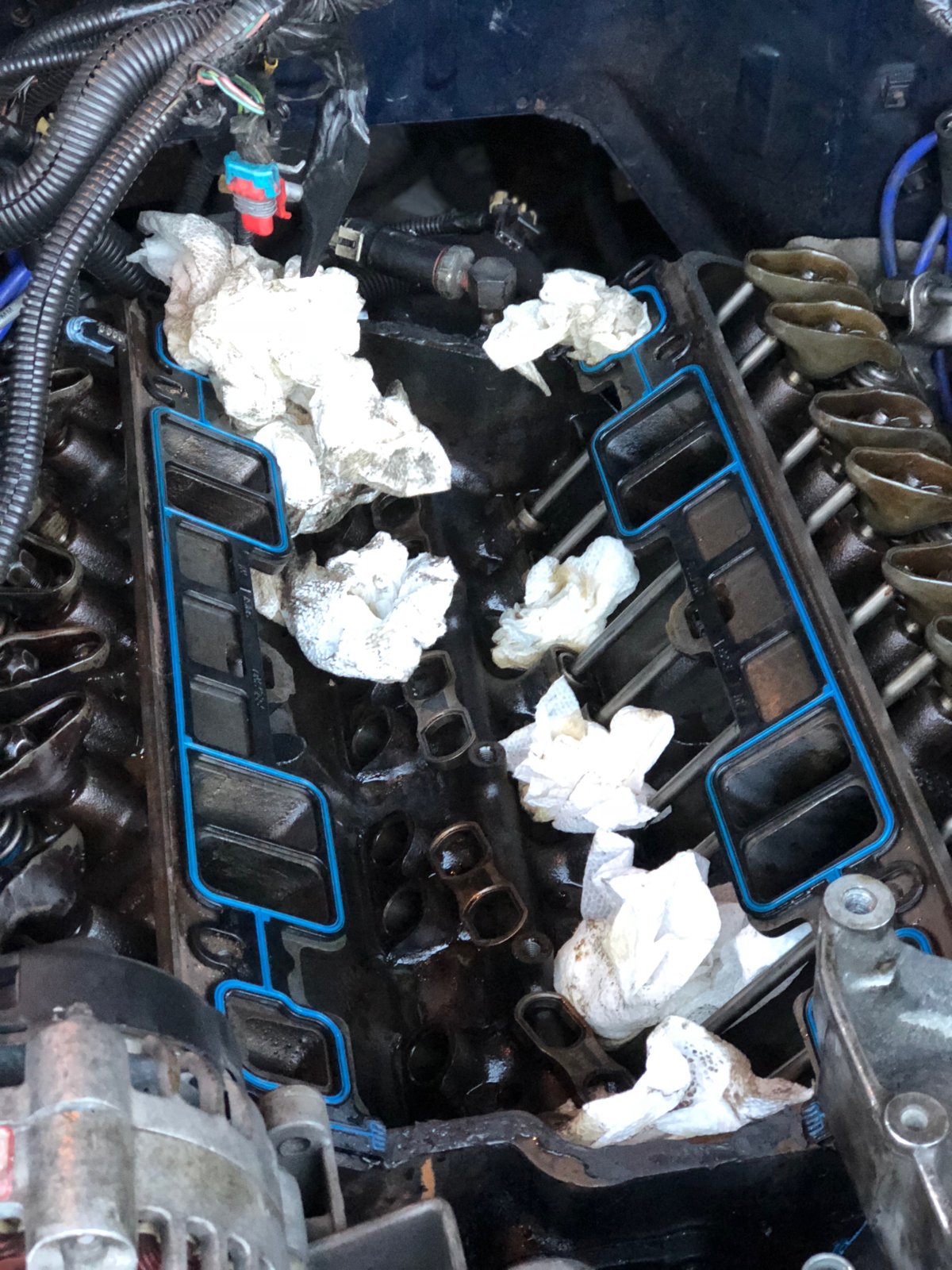

What are ALL of the possible ways oil and coolant can mix? Head gasket? Intake gasket? Like I said, it’s only on passenger side right now, so maybe caught it earlier. Would that mean intake gasket on that side? I’m racking my brain on this. Very frustrated. Don’t want to pay a mechanic an arm and a leg. The more infuriating part is that tick/knock, but I will look at the torque converter bolts. How easy are they to check? I’ll also pull the lifters on the passenger side too

Coolant does go thru the intake on the l31 right? Any chance that's just what came out of the intake whme you pulled it?
Yes it does. It could have come out when I pulled it and fell into the pan I’m assuming. May not still be leaking, but residual from pulling. It’s fairly consistent; however, I’m not seeing it on the driver side yet.

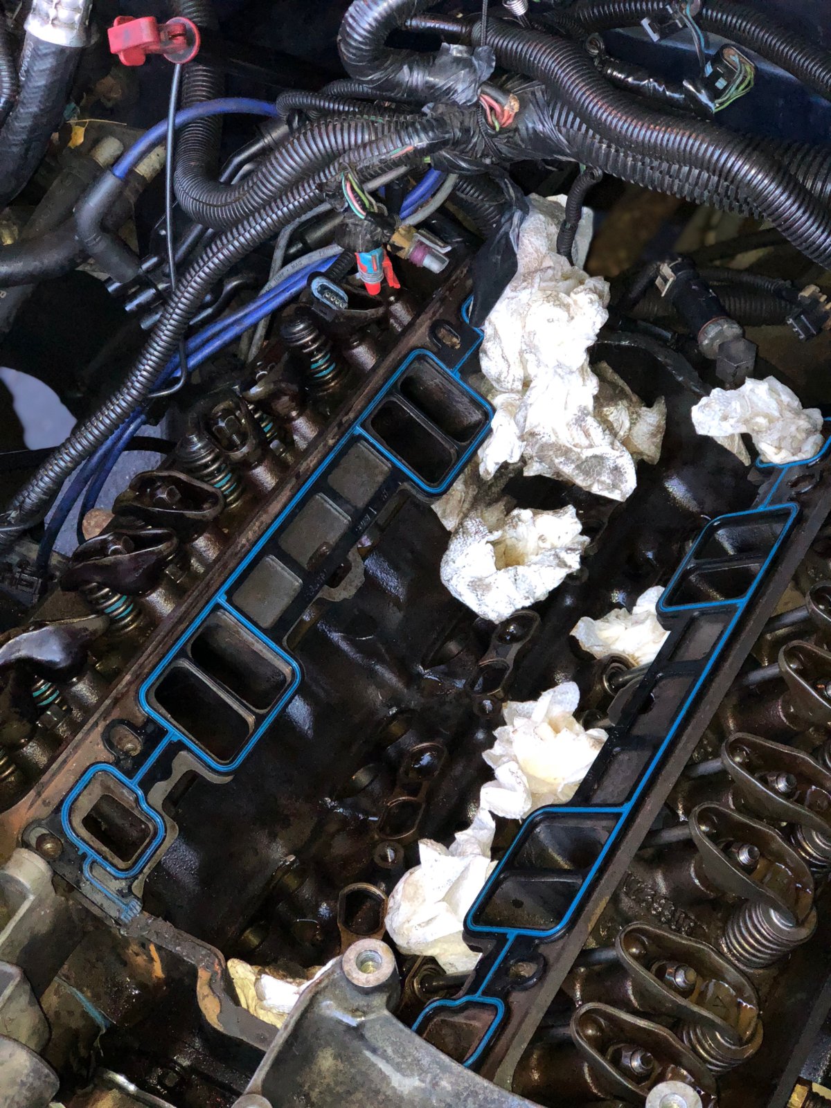

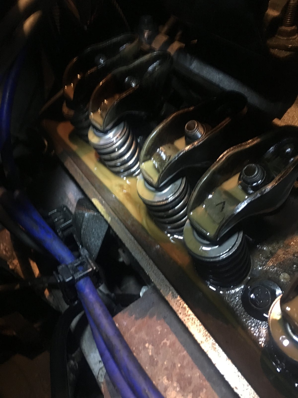

Tighten up TC bolts but still ticking. So stumped. Put my ear everywhere and can’t really seem to pinpoint. Either flywheel or something around Cylinder 6/8. Lifter, pushrod, rocker, rod... definitely leaking coolant into oil now so gotta pull intake again

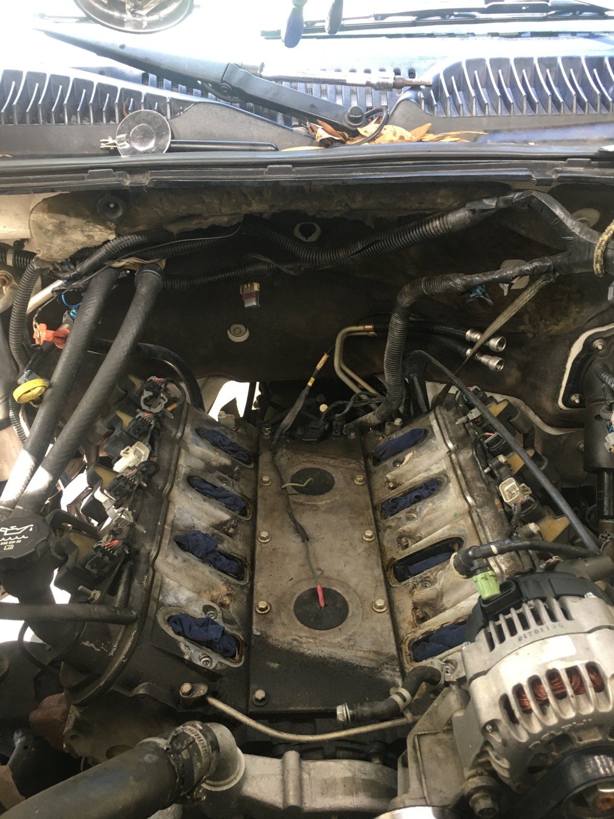

Here she is!!! Probably the fifth time I’ve done this. Can tear down the top end in a hot second! Now riddle me this... how would the intake bolts loose their torque overnight? I could take out the passenger front 3 practically with my fingers and I had them torqued to 14 ft lbs... that’s why it leaked

Maybe some thread locker will keep them nice and snug--or does the torque specs say not to use it?
