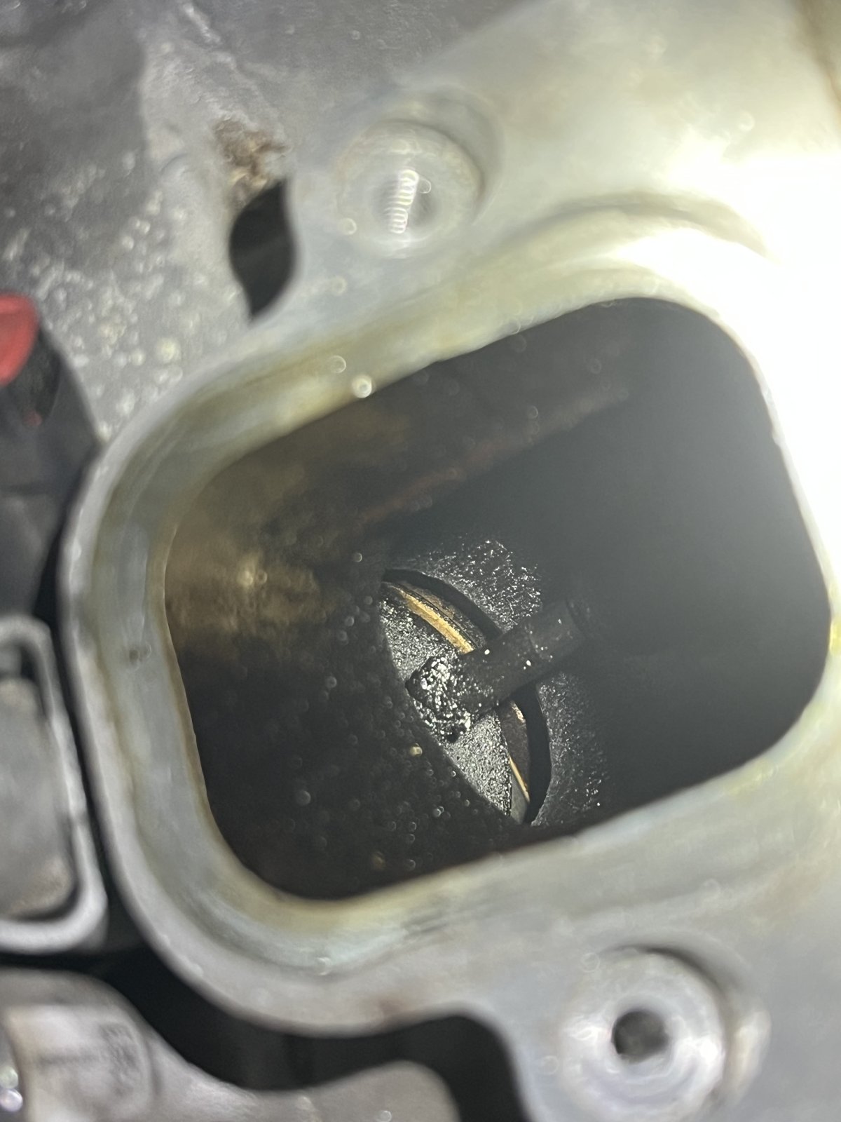

When I had the intake off to check the injector part numbers, I looked inside the intake and noticed it was excessively dirty. I bought sea foam to do a cleaning but wanted to make sure it was running well again before I introduced something else to the mix.
Problem is, it was running fine today for about a half hour until we were getting off the freeway, when it gave the “low oil pressure turn engine off” warning again. Started running rough, and it generated a p0016 code for the CKP. Had to sit and wait for a coworker to come get me while my wife stayed with our 3 kids, take me to the airport, rent a car, then come back to get them. After this third time of it dying and leaving us stranded, we’re done. I left the battery disconnected while it sits in a parking lot, and hopefully it’ll reset and start and run long enough tomorrow so I can go trade it in at the dealership and get something else.
For reference, this was the intake:
that's what happens with the direct injection engines, that has to be cleaned then it will run better

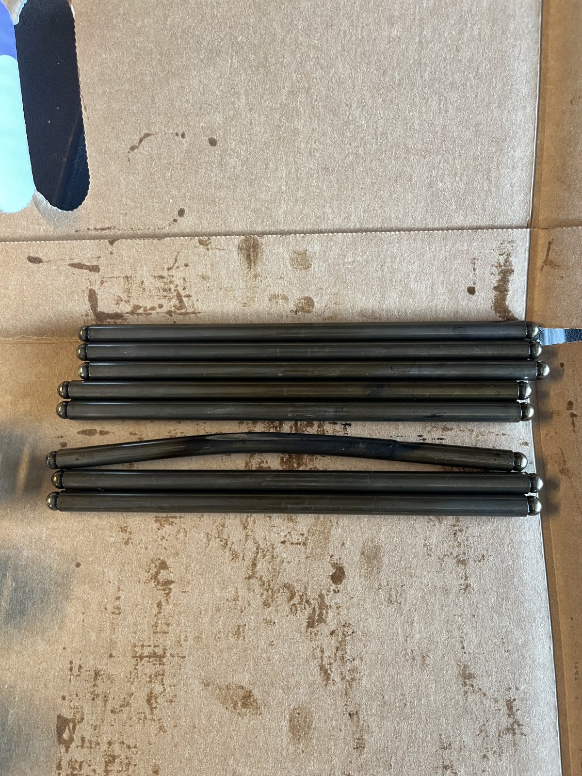

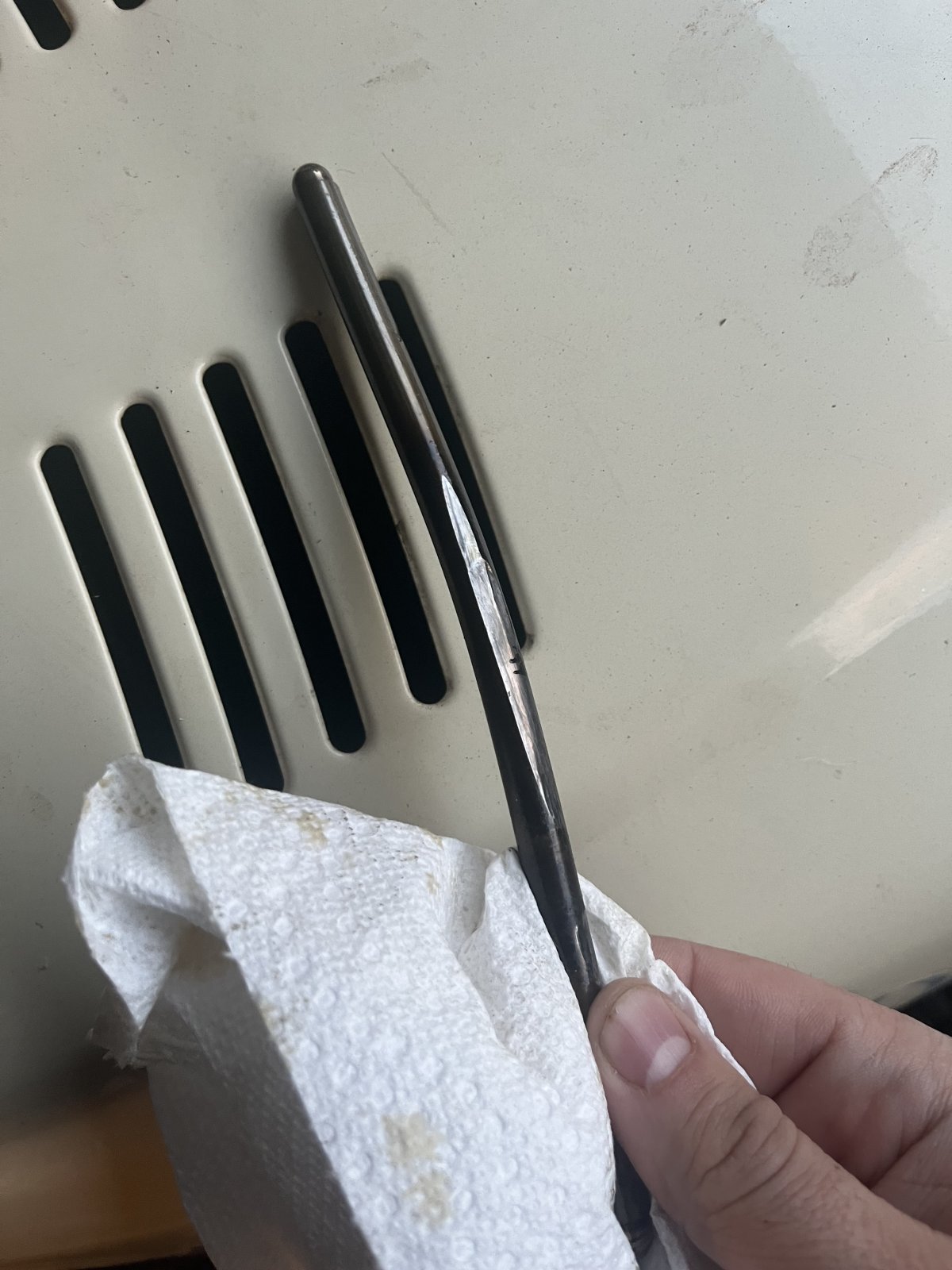

So short update. Got the Yukon home over a period of a couple days and started breaking it down. Intake is still as nasty as the previous photo I posted, but I haven’t taken any steps to clean it yet, so that’s understandable. Got the pushrods out, and sure enough, the third one back on the passenger side (intake cylinder 4 I believe) is bent with some significant shaving on the side. All other 15 pushrods have no damage or are bent.
Obviously the next step is I need to figure out what caused the pushrod to bend. The rollers on the rocker arms looked good and rolled without any issues so I don’t think those need replaced. Is the next step going deeper to the head and examining everything to see what else is going on?
Also, what would everyone recommend on cleaning the intake at this point? Removing the heads and cleaning the valves and intake with brake cleaner on the bench, or leaving it and running sea foam through it after the pushrod is replaced?
