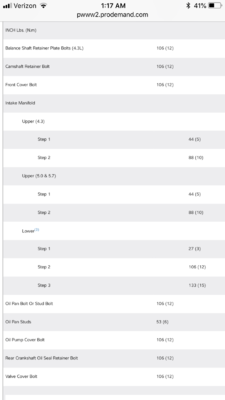

That’s what I’m thinking but don’t know how! Maybe I was a dumbass and didn’t put the intake back on right? What are the torque specs for lower intake?
