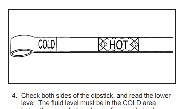

I replaced my original thermostat for the new one which lowers the temp to around 150. Would the fluid show a lower fill mark from when I was checking while at the original operating temp of say 195? I haven’t had time to check on level ground.
21,299
30,254
Yes, like this:
