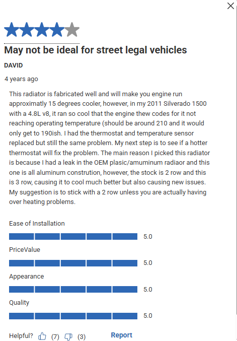

I've seen this in a couple radiator reviews. The radiator made the engine run too cold, it never got up to operating temperature. It wasn't a stuck thermostat but rather a radiator that was "unplugged" it didn't restrict enough flow on the boil line back to the revivor or something to that effect.
I'm trying to find a factory fitment radiator that runs COLDER. I cannot find that radiator again though other than the "Frostbite" radiator linked below. However, I'm recalling a radiator with plastic reservoirs that wasn't so expensive.
