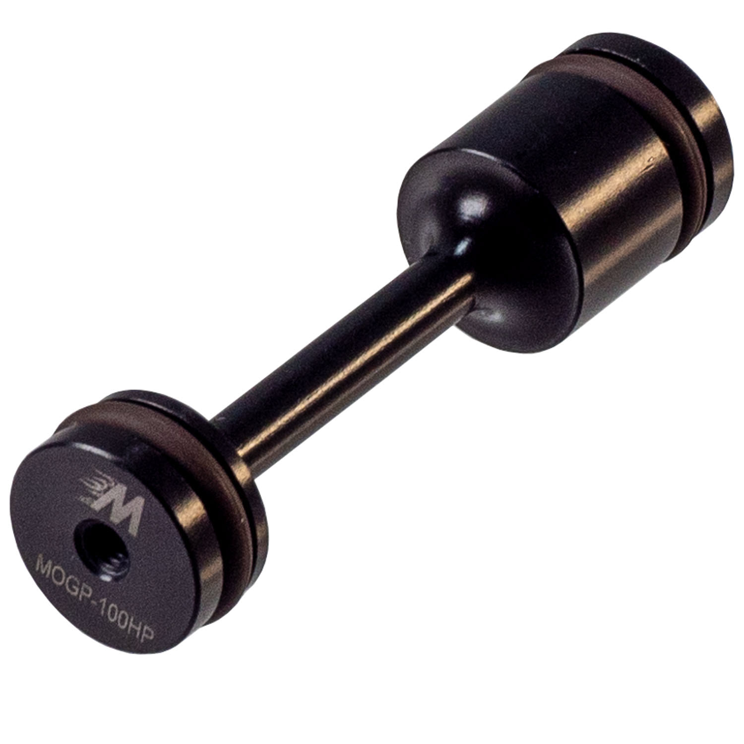

Any feedback on the Melling MOGP100HV barbell?
Worth the extra $17 over the GM or standard Melling?

I've been using ICT on the past couple builds. No issues. Not really a high-tech part. Well most of us cringe at OEM using plastic for it, I can't say that I've ever seen one that failed. (It's the lifter trays that I've never got over. I've never had a genuine GM one fail, but still..... Putting plastic in 200° oil for years and years?)

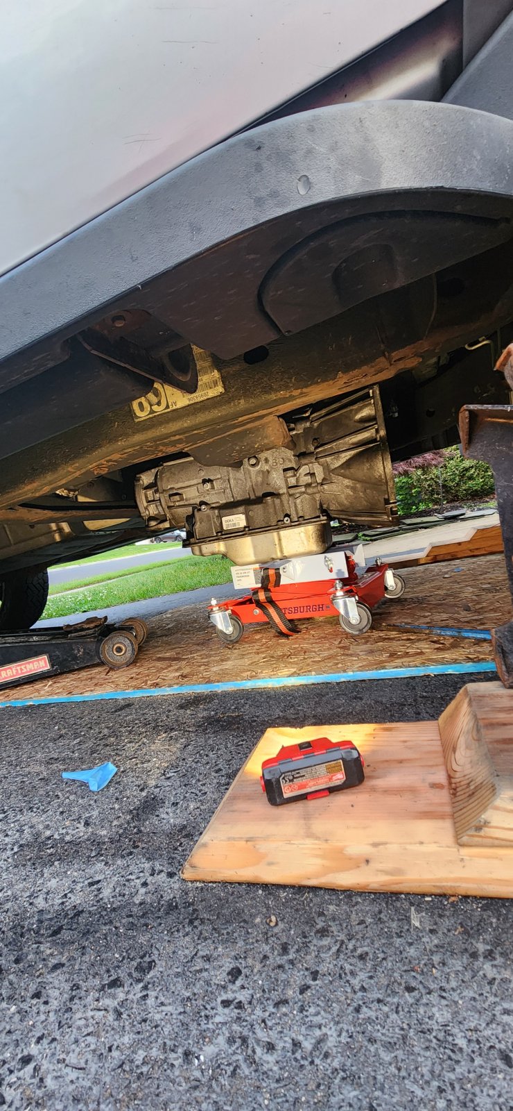

Just for future readers of this fourm. If using a transmission jack use the safety strap to hold it down. Transmissions slip off real easy....Here's a picture of me not using the strap!
I will second this recommendation. After getting a little too bold and not using a strap over July 4th weekend, I dumped my trans off the jack while trying to wrestle it back onto the dowel pins. It fell into my chest then dropped onto my elbow, dumping at least 5 quarts of fluid out of the fill hole onto my garage floor. 70lbs of cat litter later, I used some ratchet straps across the frame rails to get it back onto the jack.

I use that same transmission jack that was pictured. I put a half inch piece of plywood between the transmission pan and the jack itself, about 2 in wider all around compared to the size of the transmission pan. With the plywood screwed down to the top of the transmission jack, I've never had the transmission slip. I usually don't use the straps and haven't had a problem. But I can see if you have the transmission sitting directly on the jack, metal to metal, that could be very slippery indeed.
Metal-to-metal contact is definitely the issue. The trans starts to slide on the jack plate.

It's worse if the pan is dented. The outgoing pan was in great shape and didn't slide much (though I did have it strapped down). The ingoing transmission had a usable but not perfect pan and we were constantly chasing it around the jack surface to keep it lined up. If it hadn't been strapped on it would have gone over the side multiple times.

I contemplated trying to build some type of cradle to attach to the top of the jack but was to busy trying to get the truck done. I ended up using the strap and even with that the trans was trying to slip out but after an hour of so of wrestling got it back in. Definitely a 6 pack + job! Especially when doing it in the summer!
