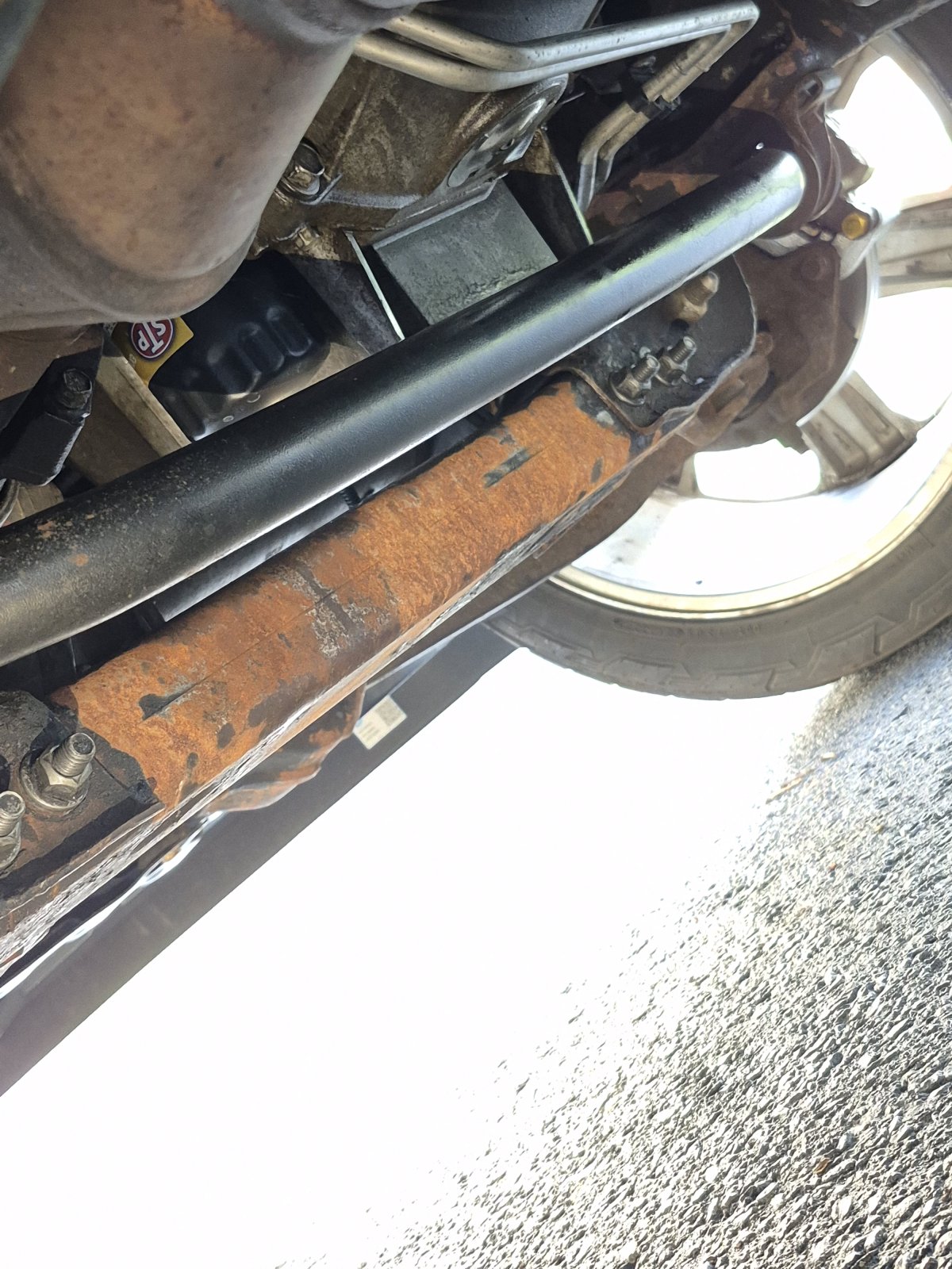

She made it from Jersey to Florida with no issues and for the first time in 10 years no oil dripping underneath! Trans temps averaged around 180. Ride home Friday.
But just think, that oil drip was keeping the rust away…..now you gotta spray the entire bottom of the truck with used oil… or atf .. your choice……..;)
