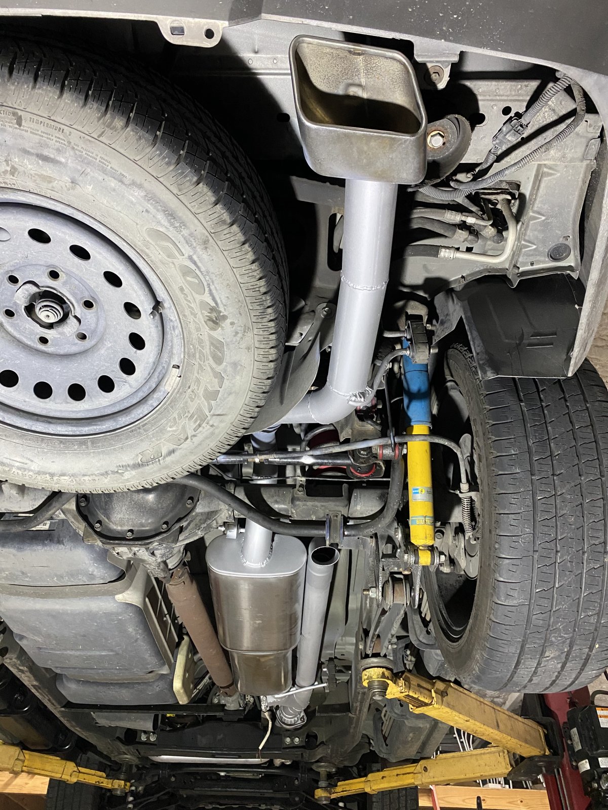

As Tony said- it was too loud once I deleted the cats in favor of long tube headers. With cats, it was perfect with just that 18" muffler. That additional 22" muffler got it down to almost where it was with the 18" alone. Cats are quite an effective muffler.
For the times I want it loud, I have the electric cutout. I was aiming to have an adjustable "exhaust volume" range of stock or nearly-stock to straight-piped. I mostly had that for about 1,000 miles. But then the butterfly valve for the unmuffled side broke off so my range was just "loud" to "loudest".

Serious question, tho....instead of two mufflers why not just put cats back in and run a more stock exhaust setup if you're trying to quiet it back down?? :shrug:
Bcuz racetruk.
Other than for sound, I want the exhaust to be as unrestricted as possible, but only when I want it to be. Thus, the cutout. It's still the family road trip car so it's gotta be quiet enough for that.
The other aspect is the smell. Cutouts and mufflers all manage the sound levels, but them fumes are ridiculous. I can't let it idle with the doors or windows open and can't cruise with the windows down and/or roof open.
I wish I could put cutouts in front of the cats to have both systems but that'd be a mess of equipment and piping crammed around the firewall and bellhousing area.

Oh got it. Are you going to do the cutout too?
Nope, gonna try the 2 muffler setup, then go from there.

WOW that's a trippy exhaust haha! Love the cutout. Are you the stock 5.3? I don't recall. I played around with running just my cats, and had bad results on the trail. My low end torque was gone, and my gas mileage was worst I've gotten. My 6.0L build is really sensitive to backpressure.
Did you notice any adverse effects to power w/ the cutout?
Mods in sig.
I've noticed no adverse effects. I'm 80-100 HP stronger according to my before and after 1/4 mile times yet I get the same or better MPG as I did stock with AFM. Cruising at 70, I opened and closed the cutout and saw no change in my instant MPG as indicated on the dash. So, efficiency seems to be unaffected. As far as power, I'd assume there's a minor loss of low RPM torque. Probably nothing I could feel or see if I did back-to-back runs comparing closed and open. I'd never be able to tell if any changes were due to the cutout status or the other variables involved. My mufflers are 3" and it tapers down to 2.75" after it goes over the axle. So, it basically mimics the stock design, just one step larger and has free-flowing mufflers. I'd say the muffled side is barely any more of a restriction than the cutout side. Ideally, on the strip, I'd start with the cutout closed and open it around 3,000-4,000 RPM. Pretty much the same idea as the active exhaust on the Corvette. The single digit gains, if any, aren't worth the hassle.

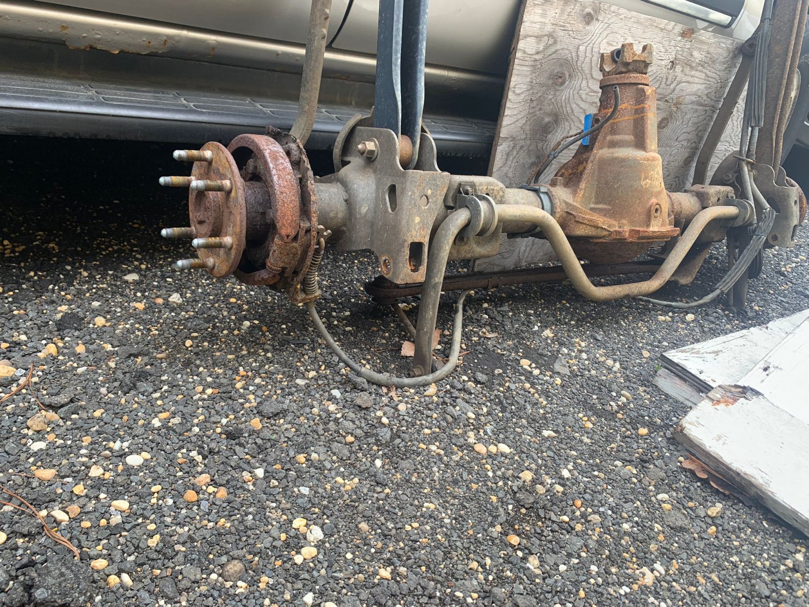

Possibly found another rear, supposedly a GT4. Is there a way to bypass if it has the JL4 option--which my truck doesn't. 4 hundo.
