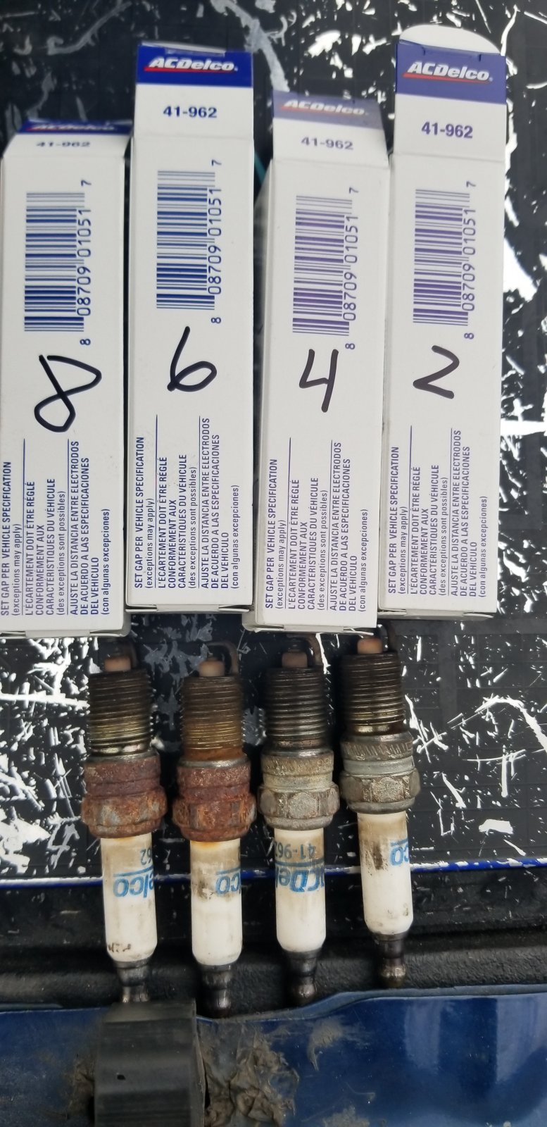

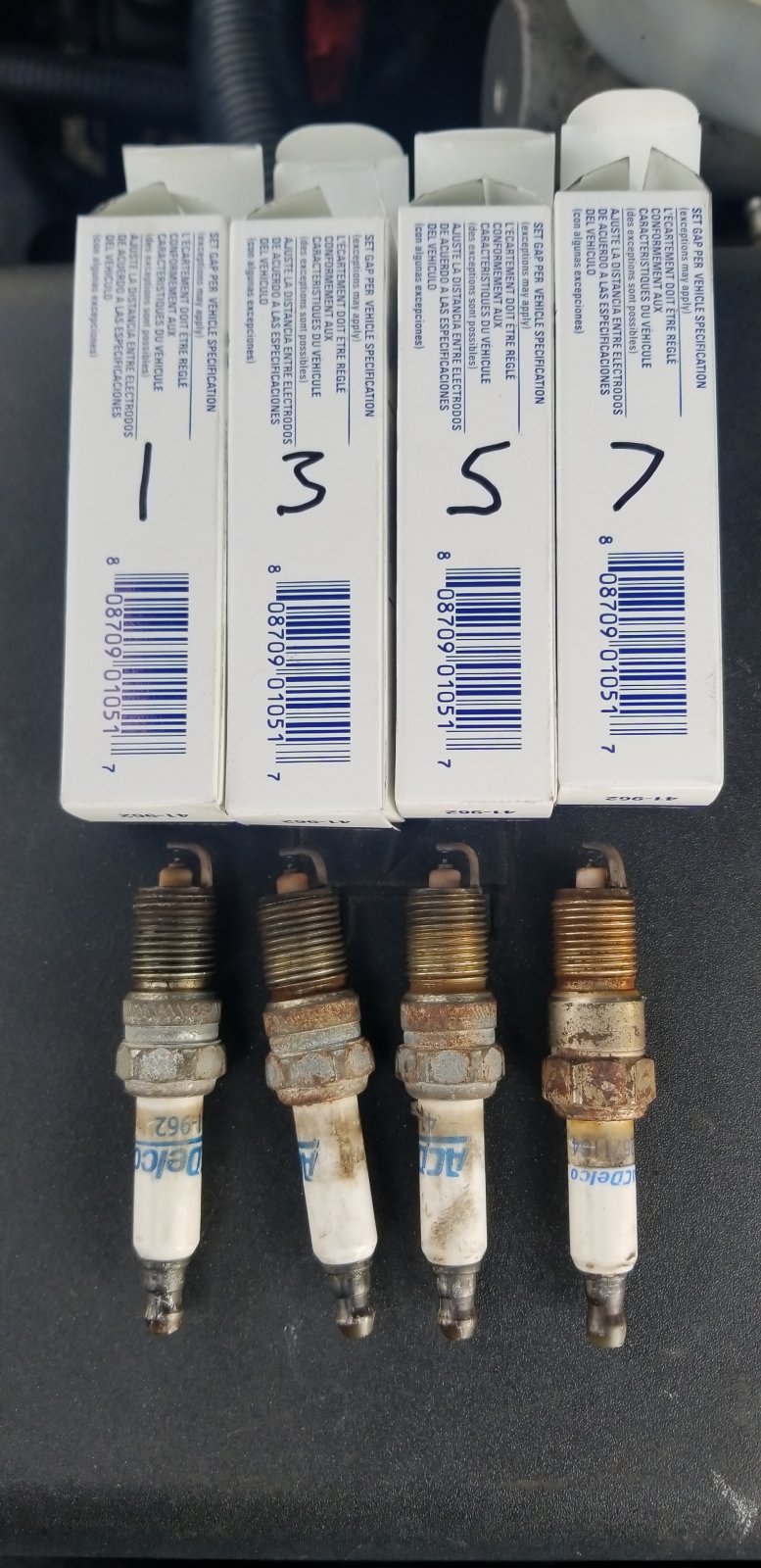

All plugs swapped out. What a PITA that was!
@Rocket Man that was a good tip for #8--worked like a charm.
All the old plugs. ONLY #7 was different.
I had to gap a couple of the new plugs, they were around .038--but a few in 1 set of 4--the electrodes weren't centered, so watch out for that.
@Rocket Man that was a good tip for #8--worked like a charm.View attachment 266379
All the old plugs. ONLY #7 was different. View attachment 266380 View attachment 266381
WTF, was the new plugs not included with this neused engine. I mean at least some new crappy ones.

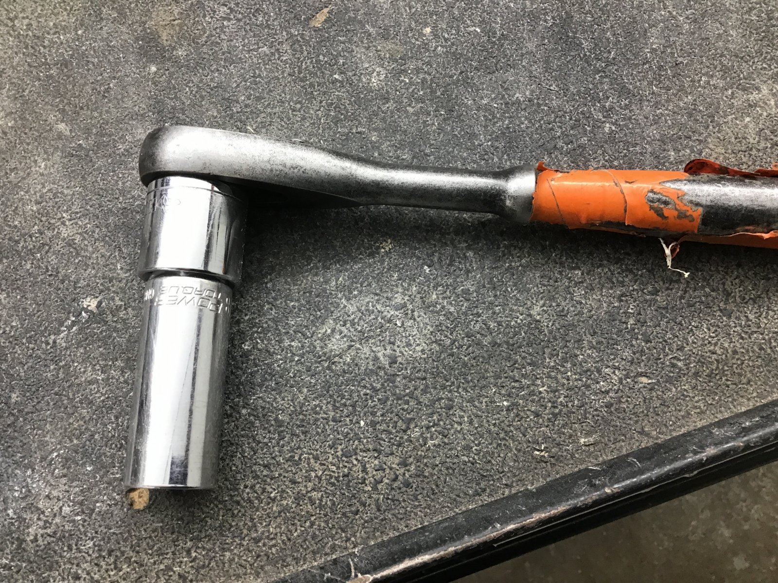

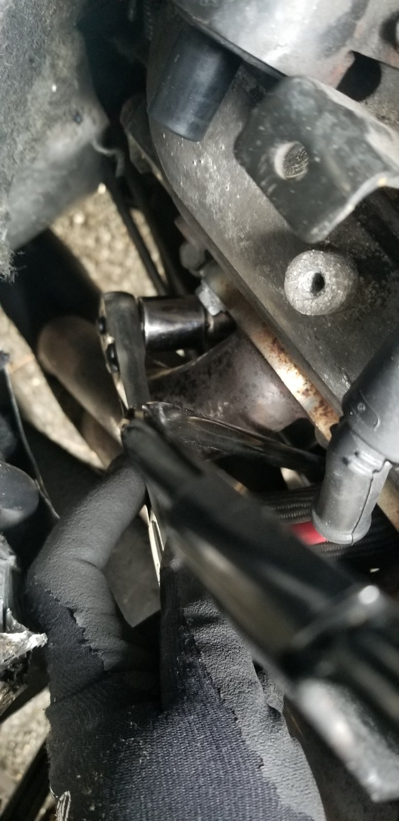

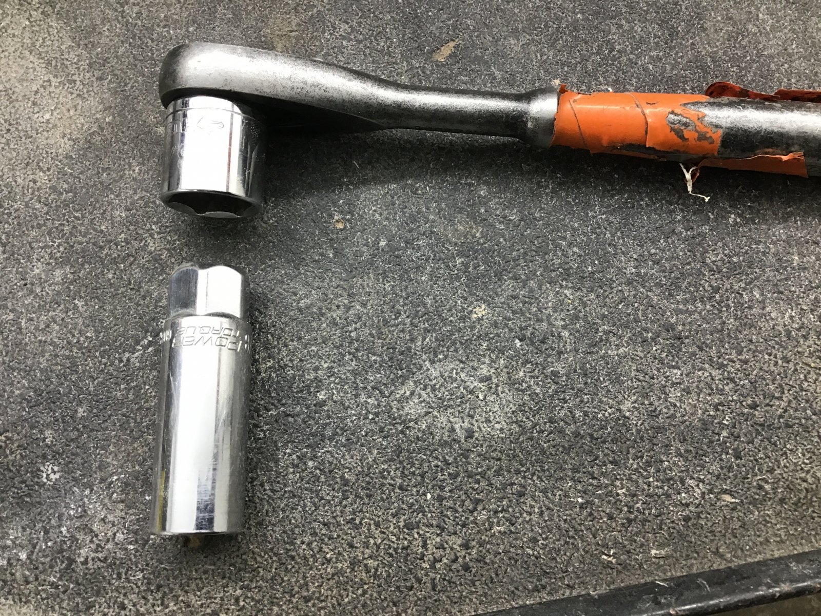

What tip was that? That L/R is a ***** *****.
That might be why it’s causing a problem, those might be the plugs that came in that engine and haven’t been changed for who knows how long. For #8 try this- your 5/8” plug socket can take a 3/4” regular socket on it, then your ratchet. Like this.
Then it’s the exact right length for #8. It’s so easy that way you won’t believe it. Try it.
View attachment 266281 View attachment 266282
The 3/4 socket on the 5/8 spark plug socket. Worked great.
Sorry, those were extra :mad:.
I wonder what other little nuggets I'm gonna find.
