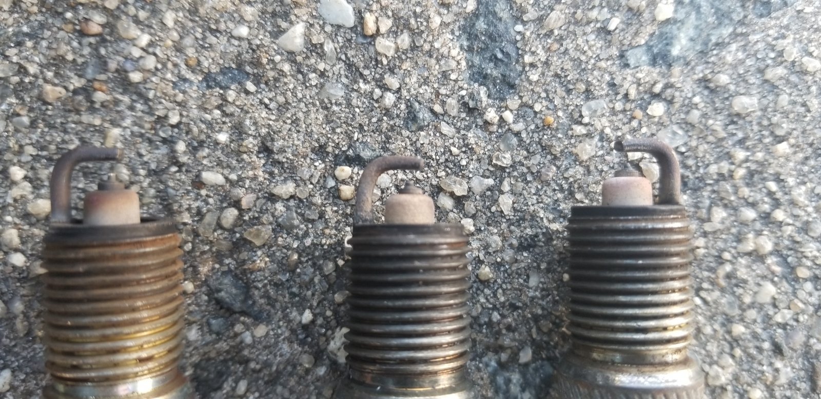

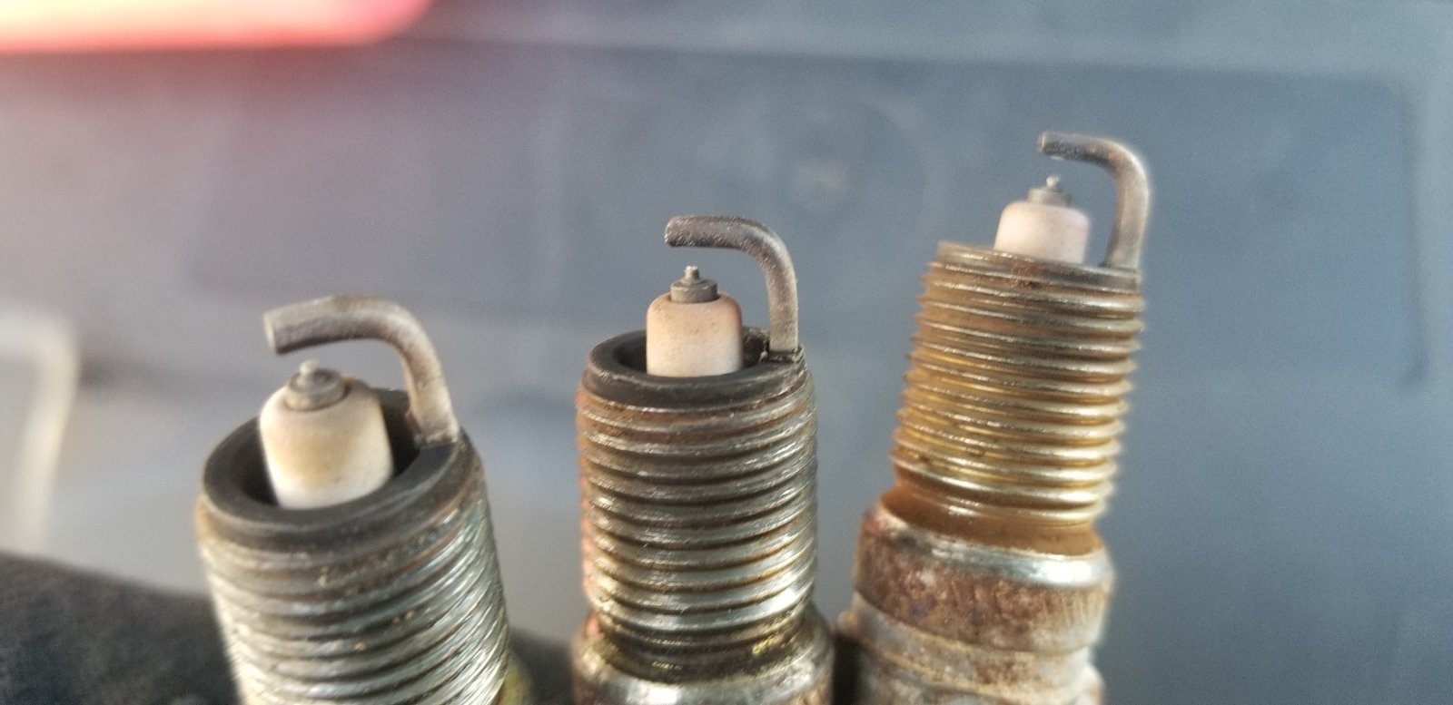

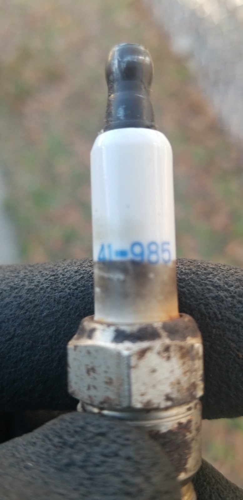

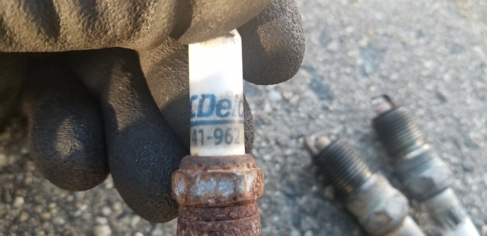

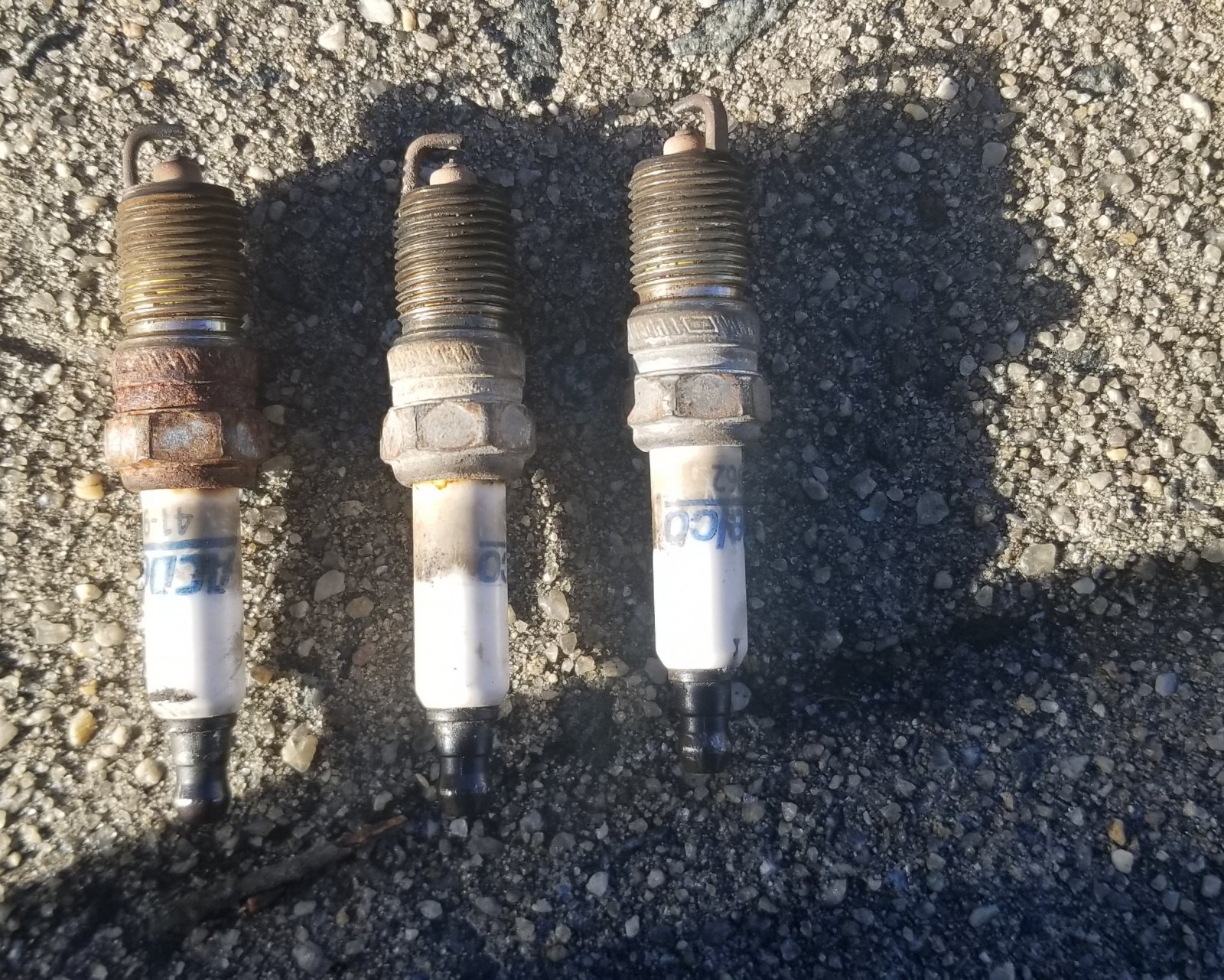

I didn't take out number 8. So starting from the left this is 6 4 and 2.
I even the gaps to about .045. Some were a hair off, maybe .048. It looks like he might have used the old plugs. These plugs should still look brand new, Especially the one with the rust around it. Over all I don't think the tips look horrible. I will change them come spring. Definitely not causing an issue.

Shit replace them with some cheap copper ones instead of putting those back in, especially #8 because that one might be the problem. Coppers are only a couple bucks apiece, then come spring put the good ones in when you have the cash.

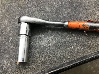

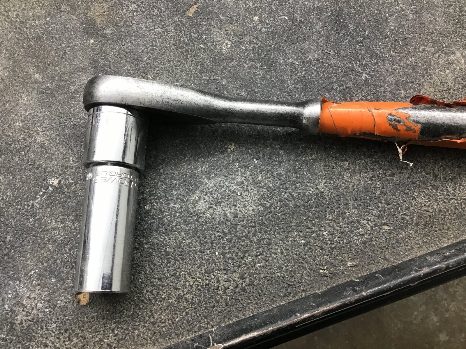

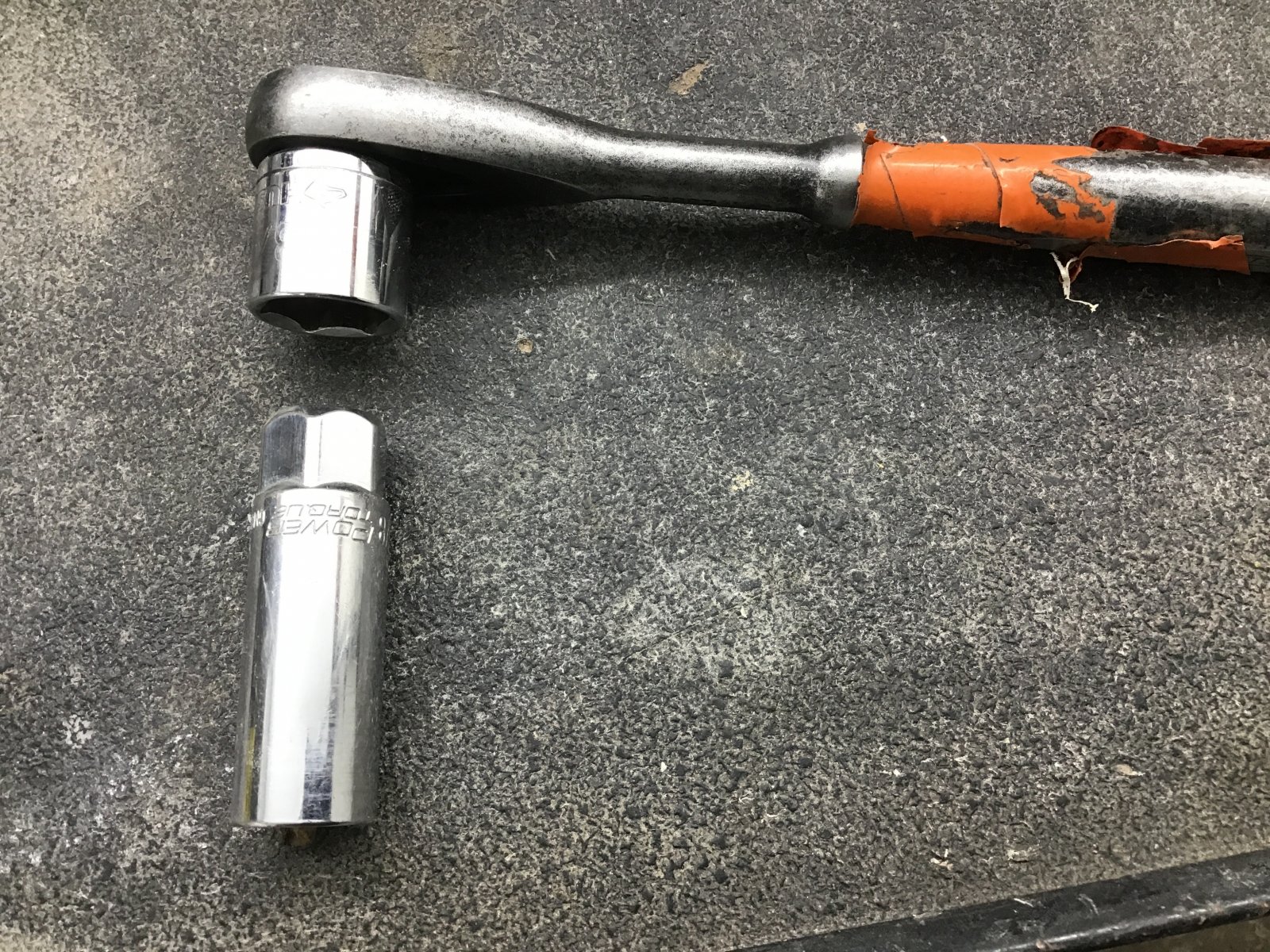

That might be why it’s causing a problem, those might be the plugs that came in that engine and haven’t been changed for who knows how long. For #8 try this- your 5/8” plug socket can take a 3/4” regular socket on it, then your ratchet. Like this.
Then it’s the exact right length for #8. It’s so easy that way you won’t believe it. Try it.
