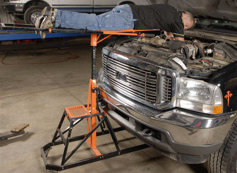

I'm only 5'9--unfortunately. Iirc, you're tall AF lol!
I have the one that hangs on the top of your wheel, but I was too lazy to get it. I also have the one that goes over your motor and you lay on it to do whatever you're doing.View attachment 266397
now thats a cool step lay over tool. ive set up cinderblocks and planks when i did knock sensors on a 3500 pick up. it was just a bit to far of a reach. truck was a bit taller then 1500's

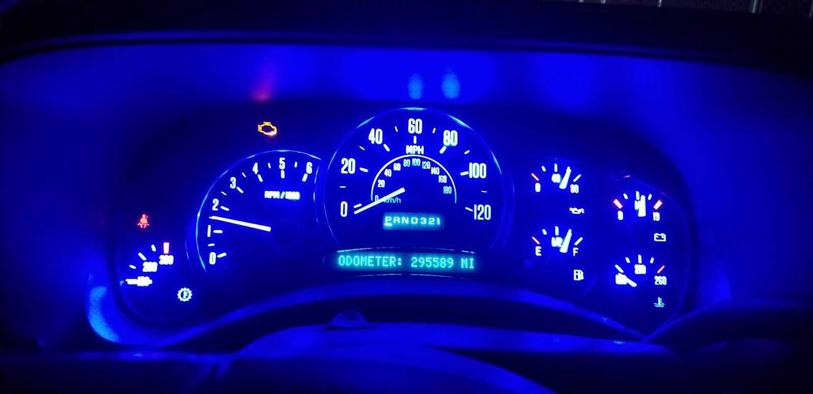

Well, found another little "surprise" that my "buddy" left me. I got a P0118 coolant temp sensor code. It autostarted fine before I saw the code. I get outside and see the cel on. I'm like WTF. So I shut it down and ran for codes--got the P0118. I go check and there was electrical tape all around it holding the pigtail on. Obviously he broke the tab, so is the sensor really bad? I didn't have time to mess with it, so I just ordered the sensor from Amazon. Coincidence? Maybe...

Will a coolant temp sensor stop the truck from starting? I'm pretty sure but I just want to double check.
I don’t think it will. Accidentally broke mines once and I started up ok but then again...

Tony, what's broken, the latch on the connector? Are you replacing that pigtail?
I'm gonna replace the sensor itself, but I think he broke the locking tab on the pigtail itself. I was in a rush and I didn't have much time to investigate. There was electrical tape wrapped around the connection of the sensor so that's what I assumed. Sensor could've coincidentally went bad at the moment. Sensor isn't coming til Monday tho.

I think with a bad ECT sensor the truck will start but idle and drive terrible because it reverts to the coldest engine temp settings for fuel and timing. (Not positive tho)

I never even got a chance! I was going to scan it while driving it today. After shutting it down I tried to restart it and it just cranks and cranks. All it's giving me is that coolant temp sensor and a maf code that's been there forever(soft code). Idk what else could cause it not to start. I smelled fuel so it isn't the fuel pump, plus wouldn't I get some kind of code if it was--ckt high/low?
