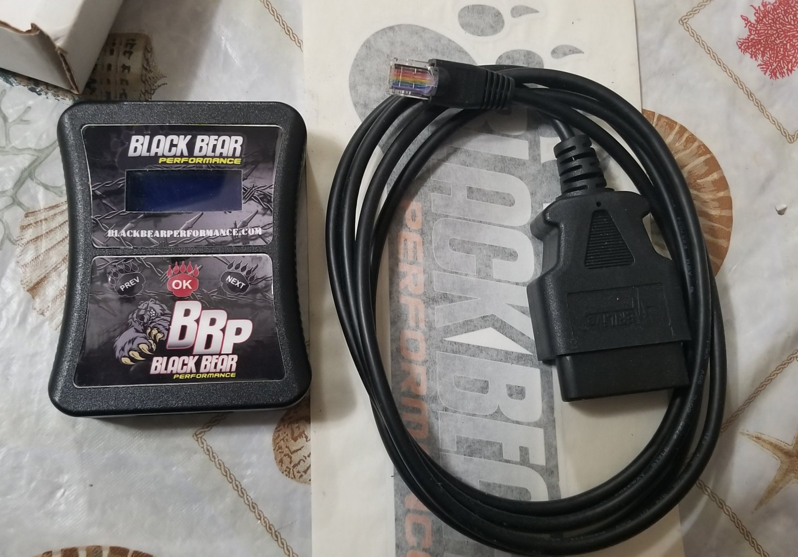

@Sam Harris
BAM! Found it!

All it took was some time to look for it! Bet you looked high and low and found it in the spot where you least expected to find it too! Other suggestion was going to be just buy another and watch that one show up. Had that happen a few times or three! Glad you found it. Now you know what you need to do with it...!! And it’s about damn time you did find it!

Now I just need to find the other stuff I have for it.
